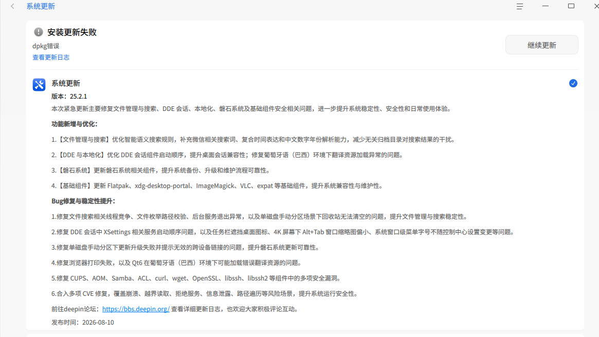

2026-08-12 19:47 终端执行:sudo dpkg --configure -a
sudo apt --fix-broken install
然后再升级。还不行就:sudo apt install --reinstall dpkg
或者继续执行:sudo apt update && sudo apt dist-upgrade
等它执行完【就升级完了】,看有没有报错。

2026年8月10日的更新一直提示更新失败怎么办
[2026-08-12 19:14:25] === Job backup running: /usr/sbin/deepin-immutable-ctl admin deploy --backup -j -w ===
[2026-08-12 19:14:34]
[2026-08-12 19:14:43]
[2026-08-12 19:14:44]
[2026-08-12 19:14:46]
[2026-08-12 19:15:21]
[2026-08-12 19:15:28]
[2026-08-12 19:15:29]
[2026-08-12 19:15:31]
[2026-08-12 19:15:53]
[2026-08-12 19:16:47]
[2026-08-12 19:16:47] === Job backup end: /usr/sbin/deepin-immutable-ctl admin deploy --backup -j -w [Status: SUCCESS] ===
[2026-08-12 19:16:57] === CheckPkg cmd running: [apt-get check -o Debug::NoLocking=1] ===
[2026-08-12 19:16:58] === CheckPkg [apt-get check -o Debug::NoLocking=1] end ===
[2026-08-12 19:16:58] === CheckPkg cmd running: [apt-get check] ===
[2026-08-12 19:16:58] === CheckPkg cmd failed: [dpkgInterrupted] E: dpkg was interrupted, you must manually run 'dpkg --configure -a' to correct the problem.
[2026-08-12 19:16:58] === CheckPkg [apt-get check] end ===
