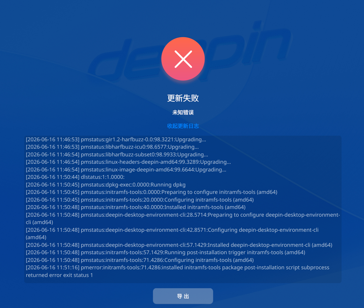

升级提示备份失败
[2026-06-16 10:52:38] === Job backup running: /usr/sbin/deepin-immutable-ctl admin deploy -- backup -j -w ===
[2026-06-16 10:52:39] {"progress":0,"description":"Starting backup process"}
[2026-06-16 10:52:47] {"progress":10,"description":"Merging modification directories"}
[2026-06-16 10:52:47] {"progress":30,"description":"Checking out system files"}
[2026-06-16 10:52:50] {"progress":50,"description":"Syncing system files"}
[2026-06-16 10:53:02] {"progress":70,"description":"Moving system files"}
[2026-06-16 10:53:19] {"progress":80,"description":"Committing"}
[2026-06-16 10:53:37] {"progress":90,"description":"Checking out deploy directory"}
[2026-06-16 10:53:48] {"progress":100,"description":"Backup completed"}
[2026-06-16 10:53:48] === Job backup end: /usr/sbin/deepin-immutable-ctl admin deploy -- backup -j -w [Status: FAILED] ===
虽然更新失败了,但系统还是提供了继续安装的选项,这个是前次更新后的优化功能,还是一直就有的?
最后系统安装还是失败了,系统无法启动!
还好是虚拟机,可以快照恢复。

deepin流云:
https://bbs.deepin.org/post/298645
sudo apt update && sudo apt dist-upgrade
好吧。再试一下。8CPU+16G内存也算资源比较少?
恢复虚拟机快照,并且删除了一些以前的快照,再次尝试通过【控制中心】升级,目前没有再报备份失败的错误了。
最终还是升级失败。等下再用命令行试试。命令行升级,是否有系统备份?如果没有备份,升级失败是否同样面临系统无法启动的风险?
