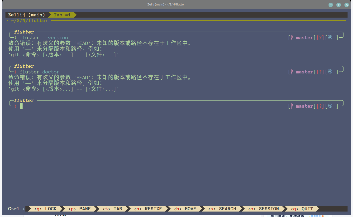

2026-06-07 14:13
这个怎么解决?
我git add .
然后commit了一个提交。

离
2026-06-07 15:06
为什么我一直这样?我不理解

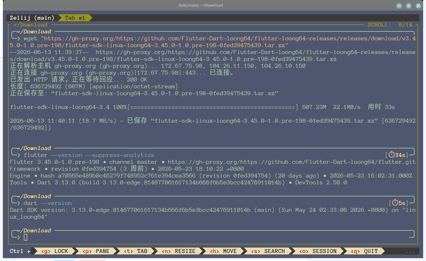

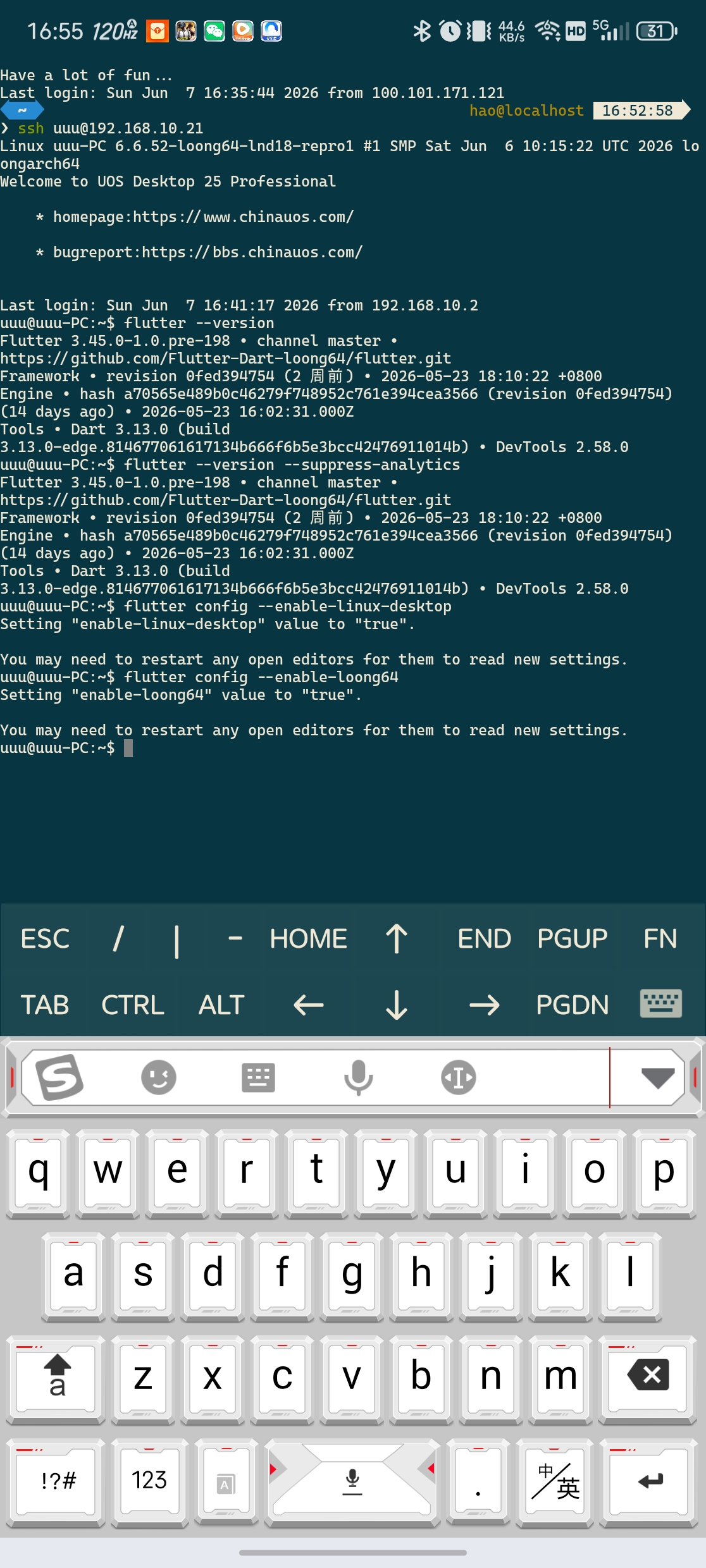

2026-06-07 22:35
离:
啥意思?
微信号
wget https://github.com/Flutter-Dart-loong64/flutter-loong64-releases/releases/download/v3.45.0-1.0.pre-198/flutter-sdk-linux-loong64-3.45.0-1.0.pre-198-0fed39475439.tar.xz
tar -xf flutter-sdk-linux-loong64-3.45.0-1.0.pre-198-0fed39475439.tar.xz -C ~/.flutter
export FLUTTER_ROOT="~/.flutter/flutter"
export PATH="$FLUTTER_ROOT/bin:$PATH"
flutter --version --suppress-analytics
dart --version
flutter config --enable-linux-desktop
flutter config --enable-loong64

离
2026-06-13 11:45
罐子:
微信号
dart --version
搞定了,谢谢大佬,之前一直没回复是没在。
