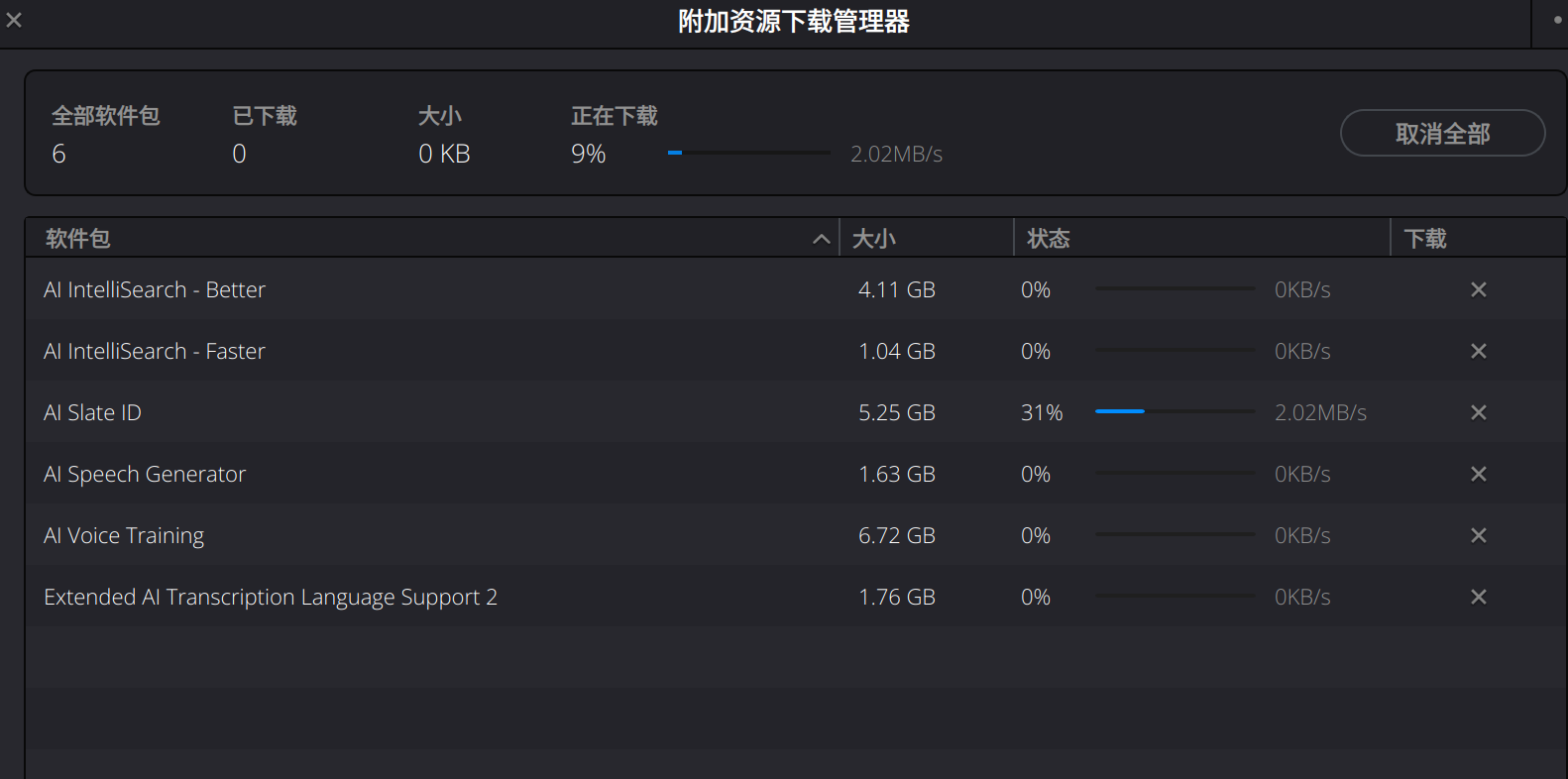

[ Content contribution] 达芬奇21beta3,Linux安装,Fusion右键问题已经解决,扩展可下载
bmywyvfx
2026-05-24 08:59
在存放软件的位置打开终端,输入:
sudo SKIP_PACKAGE_CHECK=1 ./DaVinci_Resolve_Studio_21.0b3.run
待安装完成,依次输入:
cd /opt/resolve
sudo perl -pi -e 's/\x03\x00\x89\x45\xFC\x83\x7D\xFC\x00\x74\x11\x48\x8B\x45\xC8\x8B/\x03\x00\x89\x45\xFC\x83\x7D\xFC\x00\xEB\x11\x48\x8B\x45\xC8\x8B/g' bin/resolve
sudo perl -pi -e 's/\x74\x11\x48\x8B\x45\xC8\x8B\x55\xFC\x89\x50\x58\xB8\x00\x00\x00/\xEB\x11\x48\x8B\x45\xC8\x8B\x55\xFC\x89\x50\x58\xB8\x00\x00\x00/g' bin/resolve
sudo perl -0777 -pi -e 's/\x74(.\xBF\x16\x00\x00\x00\xBE.\x01\x00\x00\xE8..\x05)/\x75$1/g' bin/resolve
echo -e "LICENSE blackmagic davinciresolvestudio 009599 permanent uncounted\n hostid=ANY issuer=AHH customer=AHH issued=03-Apr-2024\n akey=3148-9267-1853-4920-8173 _ck=00 sig="00"\n" > .license/blackmagic.lic
cd /opt/resolve/libs && sudo mkdir disabled-libraries && sudo mv libglib* libgio* libgmodule* disabled-libraries
中文输入法
cd /usr/lib/x86_64-linux-gnu/qt5/plugins/
sudo cp -r platforminputcontexts /opt/resolve/libs/plugins
启动达芬奇,下载额外的AI扩展!
在Linux mint 22.3上运行无问题,AI扩展可以安装,Fusion中其他节点右键连接跟踪数据没有问题

原来挂了梯子反而很慢,把梯子拆了,下载速度就有10M/S了
