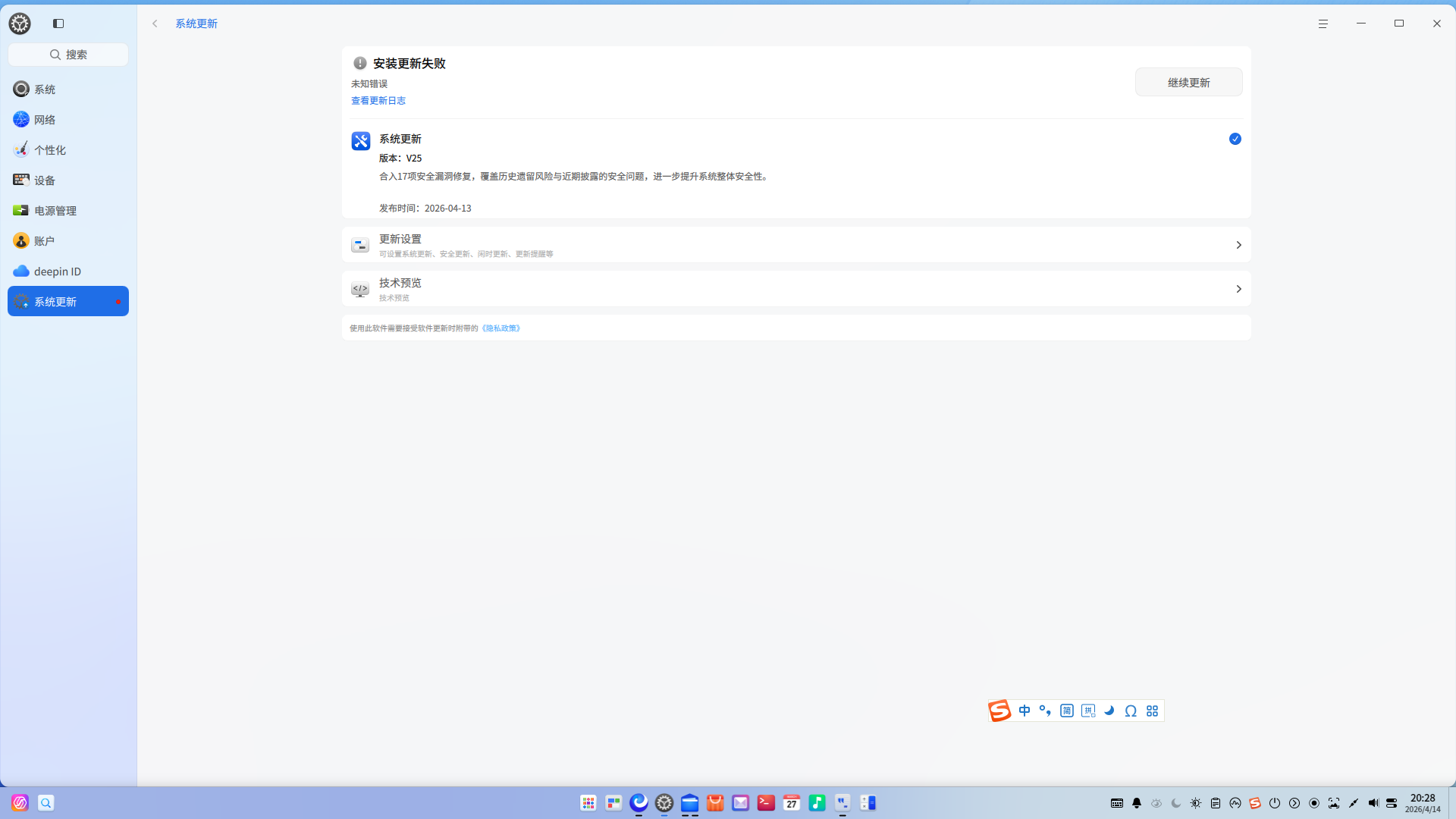

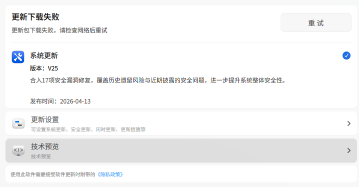

[Feedback on issues] V25在线升级失败
180******39
2026-04-14 20:36
[2026-04-14 20:15:26] {"progress":0,"description":"Starting backup process"}
[2026-04-14 20:15:35] {"progress":10,"description":"Merging modification directories"}
[2026-04-14 20:15:35] {"progress":30,"description":"Checking out system files"}
[2026-04-14 20:15:37] {"progress":50,"description":"Syncing system files"}
[2026-04-14 20:15:37] {"progress":70,"description":"Moving system files"}
[2026-04-14 20:15:37] {"progress":80,"description":"Committing"}
[2026-04-14 20:15:43] {"progress":10,"description":"Merging modification directories"}
[2026-04-14 20:15:43] {"progress":30,"description":"Checking out system files"}
[2026-04-14 20:15:44] {"progress":50,"description":"Syncing system files"}
[2026-04-14 20:15:45] {"progress":70,"description":"Moving system files"}
[2026-04-14 20:15:53] {"progress":80,"description":"Committing"}
[2026-04-14 20:15:57] {"progress":90,"description":"Checking out deploy directory"}
[2026-04-14 20:16:23] {"progress":100,"description":"Backup completed"}
[2026-04-14 20:17:10] dlstatus:1:1.0000:
[2026-04-14 20:17:11] pmstatus:dpkg-exec:0.0000:Starting upgrade...
[2026-04-14 20:18:00] dlstatus:1:1.0000:
[2026-04-14 20:18:01] pmstatus:dpkg-exec:0.0000:Starting upgrade...
[2026-04-14 20:26:37] dlstatus:1:1.0000:
[2026-04-14 20:26:38] pmstatus:dpkg-exec:0.0000:Starting upgrade...
[2026-04-14 20:27:33] dlstatus:1:1.0000:
[2026-04-14 20:27:34] pmstatus:dpkg-exec:0.0000:Starting upgrade...
[2026-04-14 20:29:42] dlstatus:1:1.0000:
[2026-04-14 20:29:43] pmstatus:dpkg-exec:0.0000:Starting upgrade...
[2026-04-14 20:30:36] dlstatus:1:1.0000:
[2026-04-14 20:30:36] pmstatus:dpkg-exec:0.0000:Starting upgrade...

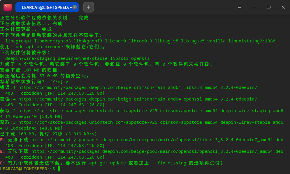

LEARCAT
2026-04-15 09:52
同样失败

米饭虚拟机-nana版
2026-04-15 11:52
手动换apt源,然在终端更新
2026-04-15 14:00
LEARCAT:
同样失败
你这个是连到北外的镜像源上了,镜像源拒绝了连接导致的更新失败,可以先去设置里面把智能镜像源关掉试试。
或者手动添加华科的镜像源:sudo sed -i 's|community-packages.deepin.com/beige/|mirrors.hust.edu.cn/deepin/beige/|g' /etc/apt/sources.list
这几天陆续有北外、北大镜像站拒绝访问的情况,我们内部也正在解决中。
