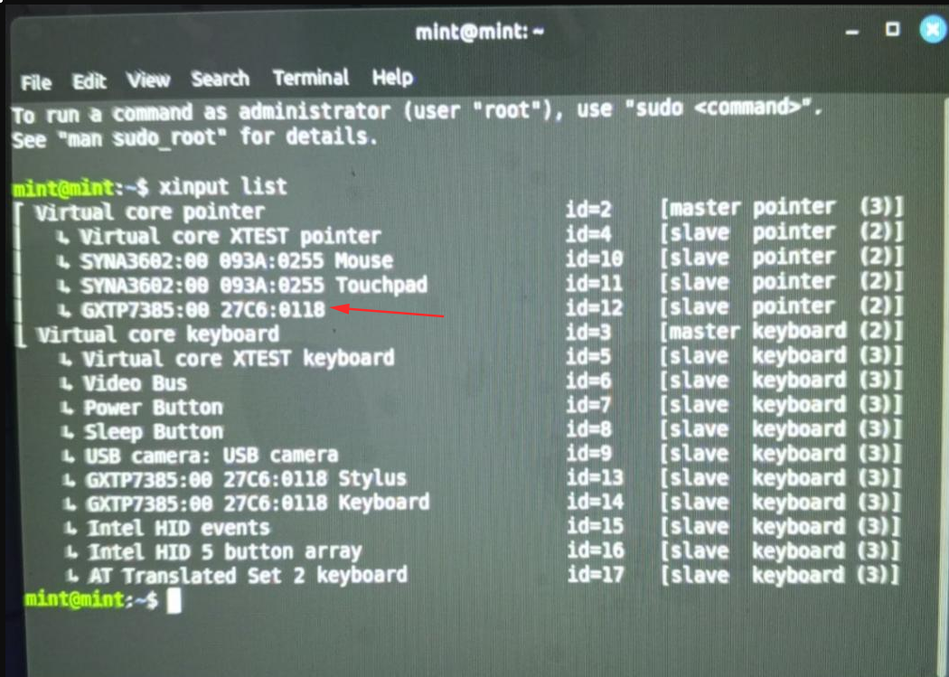

In Linux mint 21.2 the touchscreen is detected and working
Please help if anyone know how to make this touchscreen is working in deepin 23,

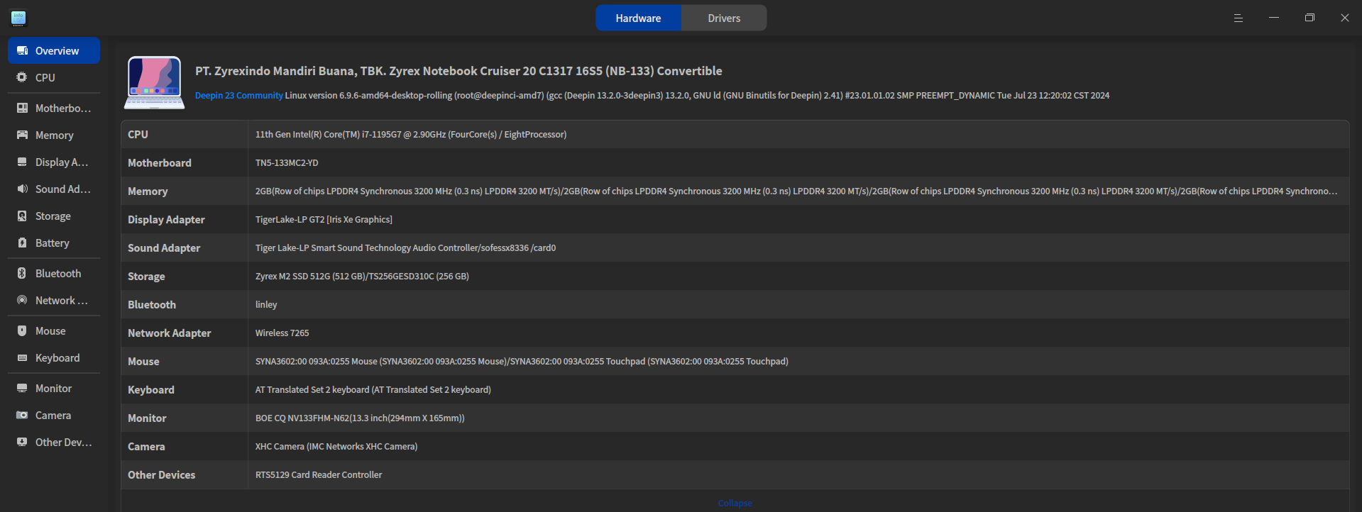

Hello, thanks for your response,
this is my laptop hardware information from device manager:
kosuke@linley:~$ ls /sys/bus/i2c/devices
i2c-0   i2c-11  i2c-14  i2c-17  i2c-4  i2c-7  i2c-ESSX8336:00  i2c-KIOX020A:00
i2c-1   i2c-12  i2c-15  i2c-2   i2c-5  i2c-8  i2c-GXTP7385:00  i2c-SYNA3602:00
i2c-10  i2c-13  i2c-16  i2c-3   i2c-6  i2c-9  i2c-KIOX010A:00

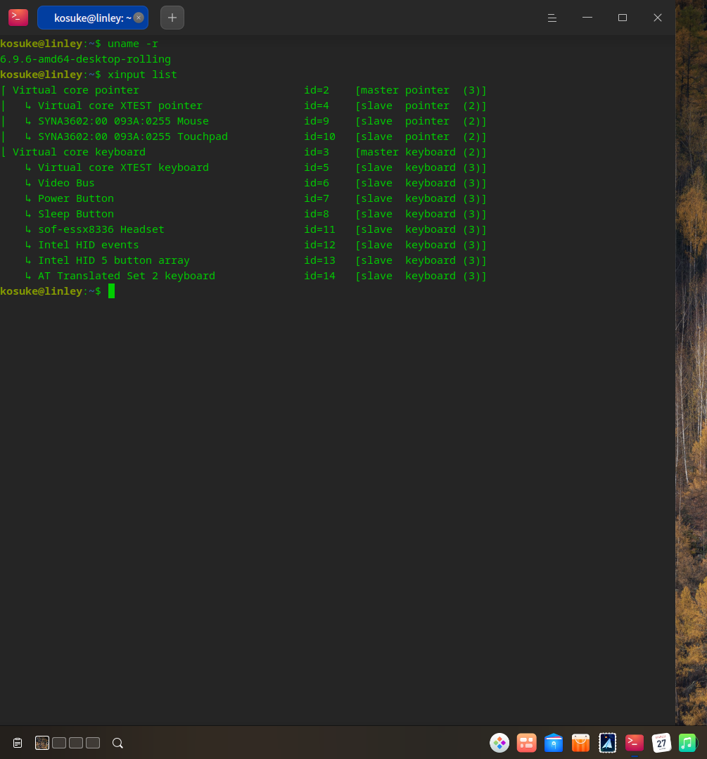

i think "i2c-GXTP7385:00" is touchscreen,
but when run comman "xinput list" that GXTP7385 not detected:
kosuke@linley:~$ xinput list
⎡ Virtual core pointer                          id=2    [master pointer  (3)]
⎜   ↳ Virtual core XTEST pointer                id=4    [slave  pointer  (2)]
⎜   ↳ SYNA3602:00 093A:0255 Mouse               id=9    [slave  pointer  (2)]
⎜   ↳ SYNA3602:00 093A:0255 Touchpad            id=10   [slave  pointer  (2)]
⎣ Virtual core keyboard                         id=3    [master keyboard (2)]
    ↳ Virtual core XTEST keyboard               id=5    [slave  keyboard (3)]
    ↳ Video Bus                                 id=6    [slave  keyboard (3)]
    ↳ Power Button                              id=7    [slave  keyboard (3)]
    ↳ Sleep Button                              id=8    [slave  keyboard (3)]
    ↳ sof-essx8336 Headset                      id=11   [slave  keyboard (3)]
    ↳ Intel HID events                          id=12   [slave  keyboard (3)]
    ↳ Intel HID 5 button array                  id=13   [slave  keyboard (3)]
    ↳ AT Translated Set 2 keyboard              id=14   [slave  keyboard (3)]

[     5.886] (**) Option "Device" "/dev/input/event1"
[     5.887] (II) event1  - Sleep Button: is tagged by udev as: Keyboard
[     5.887] (II) event1  - Sleep Button: device is a keyboard
[     5.887] (II) event1  - Sleep Button: device removed
[     5.908] (**) Option "config_info" "udev:/sys/devices/LNXSYSTM:00/LNXSYBUS:00/PNP0C0E:00/input/input1/event1"
[     5.908] (II) XINPUT: Adding extended input device "Sleep Button" (type: KEYBOARD, id 8)
[     5.908] (**) Option "xkb_model" "pc105"
[     5.908] (**) Option "xkb_layout" "us"
[     5.909] (II) event1  - Sleep Button: is tagged by udev as: Keyboard
[     5.909] (II) event1  - Sleep Button: device is a keyboard
[     5.910] (II) config/udev: Adding input device SYNA3602:00 093A:0255 Mouse (/dev/input/event8)
[     5.910] (**) SYNA3602:00 093A:0255 Mouse: Applying InputClass "libinput pointer catchall"
[     5.910] (II) Using input driver 'libinput' for 'SYNA3602:00 093A:0255 Mouse'
[     5.910] (**) SYNA3602:00 093A:0255 Mouse: always reports core events
[     5.910] (**) Option "Device" "/dev/input/event8"
[     5.911] (II) event8  - SYNA3602:00 093A:0255 Mouse: is tagged by udev as: Mouse Pointingstick
[     5.912] (II) event8  - SYNA3602:00 093A:0255 Mouse: device is a pointer
[     5.912] (II) event8  - SYNA3602:00 093A:0255 Mouse: device removed
[     5.948] (**) Option "config_info" "udev:/sys/devices/pci0000:00/0000:00:15.0/i2c_designware.0/i2c-1/i2c-SYNA3602:00/0018:093A:0255.0001/input/input10/event8"
[     5.948] (II) XINPUT: Adding extended input device "SYNA3602:00 093A:0255 Mouse" (type: MOUSE, id 9)
[     5.948] (**) Option "AccelerationScheme" "none"
[     5.948] (**) SYNA3602:00 093A:0255 Mouse: (accel) selected scheme none/0
[     5.948] (**) SYNA3602:00 093A:0255 Mouse: (accel) acceleration factor: 2.000
[     5.948] (**) SYNA3602:00 093A:0255 Mouse: (accel) acceleration threshold: 4
[     5.949] (II) event8  - SYNA3602:00 093A:0255 Mouse: is tagged by udev as: Mouse Pointingstick
[     5.950] (II) event8  - SYNA3602:00 093A:0255 Mouse: device is a pointer
[     5.951] (II) config/udev: Adding input device SYNA3602:00 093A:0255 Mouse (/dev/input/mouse0)
[     5.951] (II) No input driver specified, ignoring this device.
[     5.951] (II) This device may have been added with another device file.
[     5.952] (II) config/udev: Adding input device SYNA3602:00 093A:0255 Touchpad (/dev/input/event9)
[     5.952] (**) SYNA3602:00 093A:0255 Touchpad: Applying InputClass "libinput touchpad catchall"
[     5.952] (**) SYNA3602:00 093A:0255 Touchpad: Applying InputClass "touchpad"
[     5.952] (II) LoadModule: "synaptics"
[     5.952] (WW) Warning, couldn't open module synaptics
[     5.952] (EE) Failed to load module "synaptics" (module does not exist, 0)
[     5.952] (EE) No input driver matching `synaptics'
[     5.952] (II) Falling back to input driver `libinput'
[     5.952] (II) Using input driver 'libinput' for 'SYNA3602:00 093A:0255 Touchpad'
[     5.952] (**) SYNA3602:00 093A:0255 Touchpad: always reports core events
[     5.952] (**) Option "Device" "/dev/input/event9"
[     5.953] (II) event9  - SYNA3602:00 093A:0255 Touchpad: is tagged by udev as: Touchpad
[     5.954] (EE) event9  - SYNA3602:00 093A:0255 Touchpad: kernel bug: clickpad advertising right button. See https://wayland.freedesktop.org/libinput/doc/1.23.0/clickpad-with-right-button.html for details
[     5.955] (II) event9  - SYNA3602:00 093A:0255 Touchpad: device is a touchpad
[     5.955] (II) event9  - SYNA3602:00 093A:0255 Touchpad: device removed
[     5.980] (**) Option "Tapping" "on"
[     5.980] (**) Option "TappingDrag" "on"
[     5.980] (**) Option "TappingButtonMap" "lrm"
[     5.980] (**) Option "AccelSpeed" "0.333333"
[     5.980] (**) Option "DisableWhileTyping" "on"
[     5.980] (**) Option "ButtonMapping" "1 0 3 4 5 6 7"
[     5.980] (**) Option "config_info" "udev:/sys/devices/pci0000:00/0000:00:15.0/i2c_designware.0/i2c-1/i2c-SYNA3602:00/0018:093A:0255.0001/input/input11/event9"
[     5.980] (II) XINPUT: Adding extended input device "SYNA3602:00 093A:0255 Touchpad" (type: TOUCHPAD, id 10)
[     5.982] (**) Option "AccelerationScheme" "none"
[     5.982] (**) SYNA3602:00 093A:0255 Touchpad: (accel) selected scheme none/0
[     5.982] (**) SYNA3602:00 093A:0255 Touchpad: (accel) acceleration factor: 2.000
[     5.982] (**) SYNA3602:00 093A:0255 Touchpad: (accel) acceleration threshold: 4
[     5.984] (II) event9  - SYNA3602:00 093A:0255 Touchpad: is tagged by udev as: Touchpad
[     5.984] (EE) event9  - SYNA3602:00 093A:0255 Touchpad: kernel bug: clickpad advertising right button. See https://wayland.freedesktop.org/libinput/doc/1.23.0/clickpad-with-right-button.html for details
[     5.986] (II) event9  - SYNA3602:00 093A:0255 Touchpad: device is a touchpad
[     5.987] (II) config/udev: Adding input device SYNA3602:00 093A:0255 Touchpad (/dev/input/mouse1)
[     5.987] (**) SYNA3602:00 093A:0255 Touchpad: Applying InputClass "touchpad"
[     5.987] (II) LoadModule: "synaptics"
[     5.987] (WW) Warning, couldn't open module synaptics
[     5.987] (EE) Failed to load module "synaptics" (module does not exist, 0)
[     5.987] (EE) No input driver matching `synaptics'
[     5.987] (II) Falling back to input driver `libinput'
[     5.987] (II) Using input driver 'libinput' for 'SYNA3602:00 093A:0255 Touchpad'
[     5.987] (**) SYNA3602:00 093A:0255 Touchpad: always reports core events
[     5.987] (**) Option "Device" "/dev/input/mouse1"
[     6.028] (II) mouse1  - not using input device '/dev/input/mouse1'.
[     6.028] (EE) libinput: SYNA3602:00 093A:0255 Touchpad: Failed to create a device for /dev/input/mouse1
[     6.028] (EE) PreInit returned 2 for "SYNA3602:00 093A:0255 Touchpad"
[     6.028] (II) UnloadModule: "libinput"
[     6.028] (II) config/udev: Adding input device sof-essx8336 Headset (/dev/input/event10)
[     6.028] (**) sof-essx8336 Headset: Applying InputClass "libinput keyboard catchall"
[     6.028] (II) Using input driver 'libinput' for 'sof-essx8336 Headset'
[     6.028] (**) sof-essx8336 Headset: always reports core events
[     6.028] (**) Option "Device" "/dev/input/event10"
[     6.029] (II) event10 - sof-essx8336 Headset: is tagged by udev as: Keyboard Switch
[     6.030] (II) event10 - sof-essx8336 Headset: device is a keyboard
[     6.030] (II) event10 - sof-essx8336 Headset: device removed
[     6.044] (**) Option "config_info" "udev:/sys/devices/pci0000:00/0000:00:1f.3/sof-essx8336/sound/card0/input12/event10"
[     6.044] (II) XINPUT: Adding extended input device "sof-essx8336 Headset" (type: KEYBOARD, id 11)
[     6.044] (**) Option "xkb_model" "pc105"
[     6.044] (**) Option "xkb_layout" "us"
[     6.045] (II) event10 - sof-essx8336 Headset: is tagged by udev as: Keyboard Switch
[     6.045] (II) event10 - sof-essx8336 Headset: device is a keyboard
[     6.046] (II) config/udev: Adding input device sof-essx8336 HDMI/DP,pcm=5 (/dev/input/event11)
[     6.046] (II) No input driver specified, ignoring this device.
[     6.046] (II) This device may have been added with another device file.
[     6.046] (II) config/udev: Adding input device sof-essx8336 HDMI/DP,pcm=6 (/dev/input/event12)
[     6.046] (II) config/udev: Adding input device sof-essx8336 HDMI/DP,pcm=7 (/dev/input/event13)
[     6.047] (II) config/udev: Adding input device Intel HID events (/dev/input/event4)
[     6.047] (**) Intel HID events: Applying InputClass "libinput keyboard catchall"
[     6.047] (II) Using input driver 'libinput' for 'Intel HID events'
[     6.047] (**) Intel HID events: always reports core events
[     6.047] (**) Option "Device" "/dev/input/event4"
[     6.048] (II) event4  - Intel HID events: is tagged by udev as: Keyboard
[     6.048] (II) event4  - Intel HID events: device is a keyboard
[     6.048] (II) event4  - Intel HID events: device removed
[     6.084] (**) Option "config_info" "udev:/sys/devices/platform/INTC1051:00/input/input7/event4"
[     6.084] (II) XINPUT: Adding extended input device "Intel HID events" (type: KEYBOARD, id 12)
[     6.084] (**) Option "xkb_model" "pc105"
[     6.084] (**) Option "xkb_layout" "us"
[     6.085] (II) event4  - Intel HID events: is tagged by udev as: Keyboard
[     6.085] (II) event4  - Intel HID events: device is a keyboard
[     6.086] (II) config/udev: Adding input device Intel HID 5 button array (/dev/input/event5)
[     6.086] (**) Intel HID 5 button array: Applying InputClass "libinput keyboard catchall"
[     6.086] (II) Using input driver 'libinput' for 'Intel HID 5 button array'
[     6.086] (**) Intel HID 5 button array: always reports core events
[     6.086] (**) Option "Device" "/dev/input/event5"
[     6.086] (II) event5  - Intel HID 5 button array: is tagged by udev as: Keyboard
[     6.086] (II) event5  - Intel HID 5 button array: device is a keyboard
[     6.087] (II) event5  - Intel HID 5 button array: device removed
[     6.116] (**) Option "config_info" "udev:/sys/devices/platform/INTC1051:00/input/input8/event5"
[     6.116] (II) XINPUT: Adding extended input device "Intel HID 5 button array" (type: KEYBOARD, id 13)
[     6.116] (**) Option "xkb_model" "pc105"
[     6.116] (**) Option "xkb_layout" "us"
[     6.117] (II) event5  - Intel HID 5 button array: is tagged by udev as: Keyboard
[     6.117] (II) event5  - Intel HID 5 button array: device is a keyboard
[     6.118] (II) config/udev: Adding input device AT Translated Set 2 keyboard (/dev/input/event3)
[     6.118] (**) AT Translated Set 2 keyboard: Applying InputClass "libinput keyboard catchall"
[     6.118] (II) Using input driver 'libinput' for 'AT Translated Set 2 keyboard'
[     6.118] (**) AT Translated Set 2 keyboard: always reports core events
[     6.118] (**) Option "Device" "/dev/input/event3"
[     6.119] (II) event3  - AT Translated Set 2 keyboard: is tagged by udev as: Keyboard
[     6.119] (II) event3  - AT Translated Set 2 keyboard: device is a keyboard
[     6.121] (II) event3  - AT Translated Set 2 keyboard: device removed
[     6.168] (**) Option "config_info" "udev:/sys/devices/platform/i8042/serio0/input/input3/event3"
[     6.168] (II) XINPUT: Adding extended input device "AT Translated Set 2 keyboard" (type: KEYBOARD, id 14)
[     6.168] (**) Option "xkb_model" "pc105"
[     6.168] (**) Option "xkb_layout" "us"
[     6.169] (II) event3  - AT Translated Set 2 keyboard: is tagged by udev as: Keyboard
[     6.169] (II) event3  - AT Translated Set 2 keyboard: device is a keyboard
[     6.171] (II) config/udev: Adding input device PC Speaker (/dev/input/event7)
[     6.171] (II) No input driver specified, ignoring this device.
[     6.171] (II) This device may have been added with another device file.
[     6.801] (II) modeset(0): EDID vendor "BOE", prod id 1817
[     6.801] (II) modeset(0): Printing DDC gathered Modelines:
[     6.801] (II) modeset(0): Modeline "1920x1080"x0.0  147.80  1920 1968 2000 2200  1080 1083 1089 1120 +hsync -vsync (67.2 kHz eP)
[     6.801] (II) modeset(0): Modeline "1920x1080"x0.0  118.30  1920 1968 2000 2200  1080 1083 1089 1120 +hsync -vsync (53.8 kHz e)
[     7.032] (II) modeset(0): EDID vendor "BOE", prod id 1817
[     7.032] (II) modeset(0): Printing DDC gathered Modelines:
[     7.032] (II) modeset(0): Modeline "1920x1080"x0.0  147.80  1920 1968 2000 2200  1080 1083 1089 1120 +hsync -vsync (67.2 kHz eP)
[     7.032] (II) modeset(0): Modeline "1920x1080"x0.0  118.30  1920 1968 2000 2200  1080 1083 1089 1120 +hsync -vsync (53.8 kHz e)
[    26.928] (II) modeset(0): EDID vendor "BOE", prod id 1817
[    26.930] (II) modeset(0): Printing DDC gathered Modelines:
[    26.930] (II) modeset(0): Modeline "1920x1080"x0.0  147.80  1920 1968 2000 2200  1080 1083 1089 1120 +hsync -vsync (67.2 kHz eP)
[    26.930] (II) modeset(0): Modeline "1920x1080"x0.0  118.30  1920 1968 2000 2200  1080 1083 1089 1120 +hsync -vsync (53.8 kHz e)
[    26.958] (II) modeset(0): EDID vendor "BOE", prod id 1817
[    26.958] (II) modeset(0): Printing DDC gathered Modelines:
[    26.958] (II) modeset(0): Modeline "1920x1080"x0.0  147.80  1920 1968 2000 2200  1080 1083 1089 1120 +hsync -vsync (67.2 kHz eP)
[    26.958] (II) modeset(0): Modeline "1920x1080"x0.0  118.30  1920 1968 2000 2200  1080 1083 1089 1120 +hsync -vsync (53.8 kHz e)
[    27.601] (II) modeset(0): EDID vendor "BOE", prod id 1817
[    27.601] (II) modeset(0): Printing DDC gathered Modelines:
[    27.601] (II) modeset(0): Modeline "1920x1080"x0.0  147.80  1920 1968 2000 2200  1080 1083 1089 1120 +hsync -vsync (67.2 kHz eP)
[    27.601] (II) modeset(0): Modeline "1920x1080"x0.0  118.30  1920 1968 2000 2200  1080 1083 1089 1120 +hsync -vsync (53.8 kHz e)
[    28.650] (II) modeset(0): EDID vendor "BOE", prod id 1817
[    28.650] (II) modeset(0): Printing DDC gathered Modelines:
[    28.650] (II) modeset(0): Modeline "1920x1080"x0.0  147.80  1920 1968 2000 2200  1080 1083 1089 1120 +hsync -vsync (67.2 kHz eP)
[    28.650] (II) modeset(0): Modeline "1920x1080"x0.0  118.30  1920 1968 2000 2200  1080 1083 1089 1120 +hsync -vsync (53.8 kHz e)

2024-09-23 20:48
zeno:
I can’t find the corresponding driver either. Can you help me see what driver Linux mint 21.2 uses in kernel mode and user mode?
mint@MintZyrex:~$ dmesg | grep -i touchscreen
[    1.276964] input: GXTP7385:00 27C6:0118 Touchscreen as /devices/pci0000:00/0000:00:15.1/i2c_designware.1/i2c-2/i2c-GXTP7385:00/0018:27C6:0118.0002/input/input6
mint@MintZyrex:~$ lsmod | grep -i touchscreen
mint@MintZyrex:~$ xinput list
⎜   ↳ SYNA3602:00 093A:0255 Mouse             	id=10	[slave  pointer  (2)]
⎜   ↳ SYNA3602:00 093A:0255 Touchpad          	id=11	[slave  pointer  (2)]
⎜   ↳ GXTP7385:00 27C6:0118                   	id=12	[slave  pointer  (2)]
    ↳ USB camera: USB camera                  	id=9	[slave  keyboard (3)]
    ↳ GXTP7385:00 27C6:0118 Stylus            	id=13	[slave  keyboard (3)]
    ↳ GXTP7385:00 27C6:0118 Keyboard          	id=14	[slave  keyboard (3)]
    ↳ Intel HID events                        	id=15	[slave  keyboard (3)]
    ↳ Intel HID 5 button array                	id=16	[slave  keyboard (3)]
    ↳ AT Translated Set 2 keyboard            	id=17	[slave  keyboard (3)]
mint@MintZyrex:~$ xinput list-props 12
Device 'GXTP7385:00 27C6:0118':
	Device Enabled (189):	1
	Coordinate Transformation Matrix (191):	1.000000, 0.000000, 0.000000, 0.000000, 1.000000, 0.000000, 0.000000, 0.000000, 1.000000
	libinput Calibration Matrix (363):	1.000000, 0.000000, 0.000000, 0.000000, 1.000000, 0.000000, 0.000000, 0.000000, 1.000000
	libinput Calibration Matrix Default (364):	1.000000, 0.000000, 0.000000, 0.000000, 1.000000, 0.000000, 0.000000, 0.000000, 1.000000
	libinput Send Events Modes Available (310):	1, 0
	libinput Send Events Mode Enabled (311):	0, 0
	libinput Send Events Mode Enabled Default (312):	0, 0
	Device Node (313):	"/dev/input/event6"
	Device Product ID (314):	10182, 280
l***n@gmail.com
2024-09-23 20:49
zeno:
and its xorglog:
