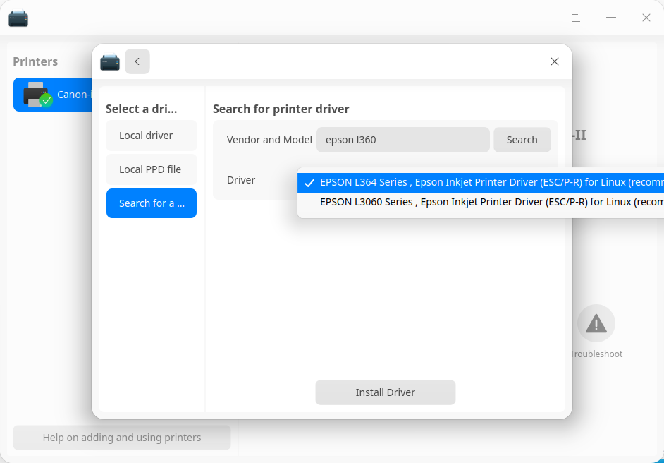

2024-06-20 17:11 i Did installed the driver and everything but the printer is working very starnge it will print to infinfity times and not stopping even that is prints the not understandable texts on papers. l have epson l360

When adding a printer, installing the driver is a challenge. In the new version of Print Manager (v1.0.6 and above), the printer driver library has been expanded and the driver query has been optimized. In the automatic search and manual search and addition methods, it is recommended to select the printer driver with the "recommended" mark. This will greatly increase your success rate in adding printers, and you will not be troubled by overly professional error feedback.

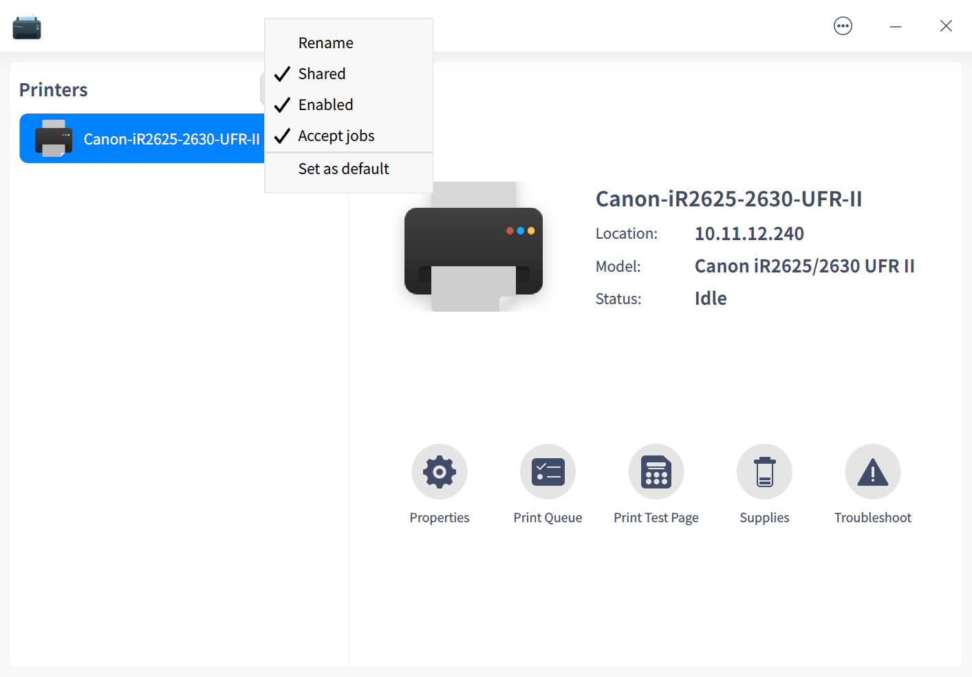

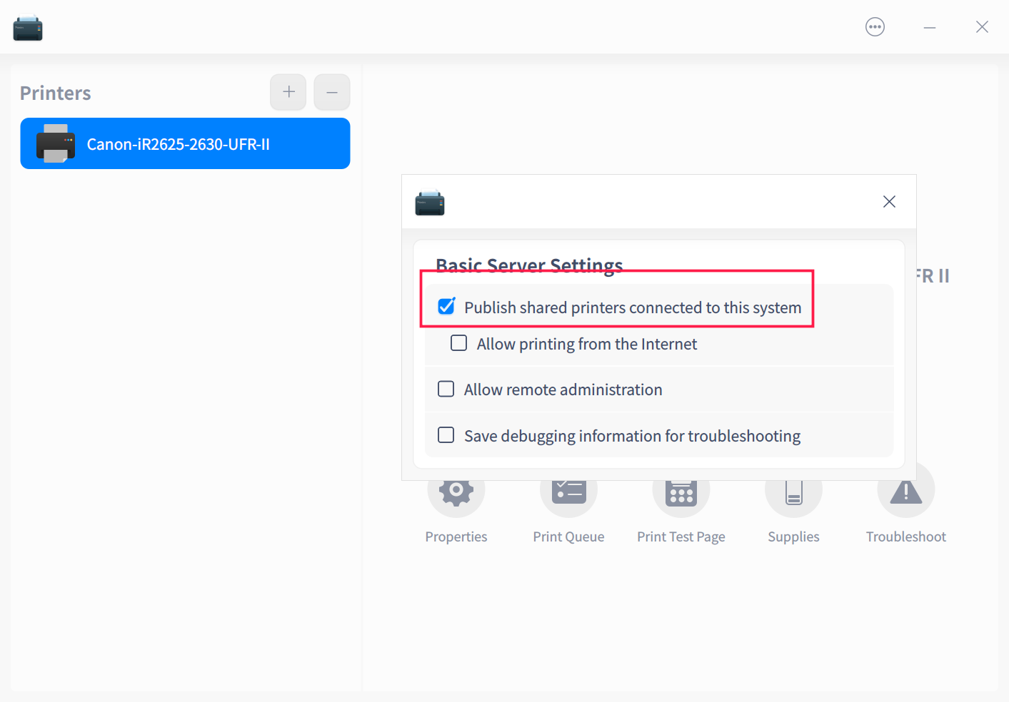

Printer sharing is based on CUPS service. You can use the Print Manager to configure it directly on the graphical interface. Just perform the following operations:

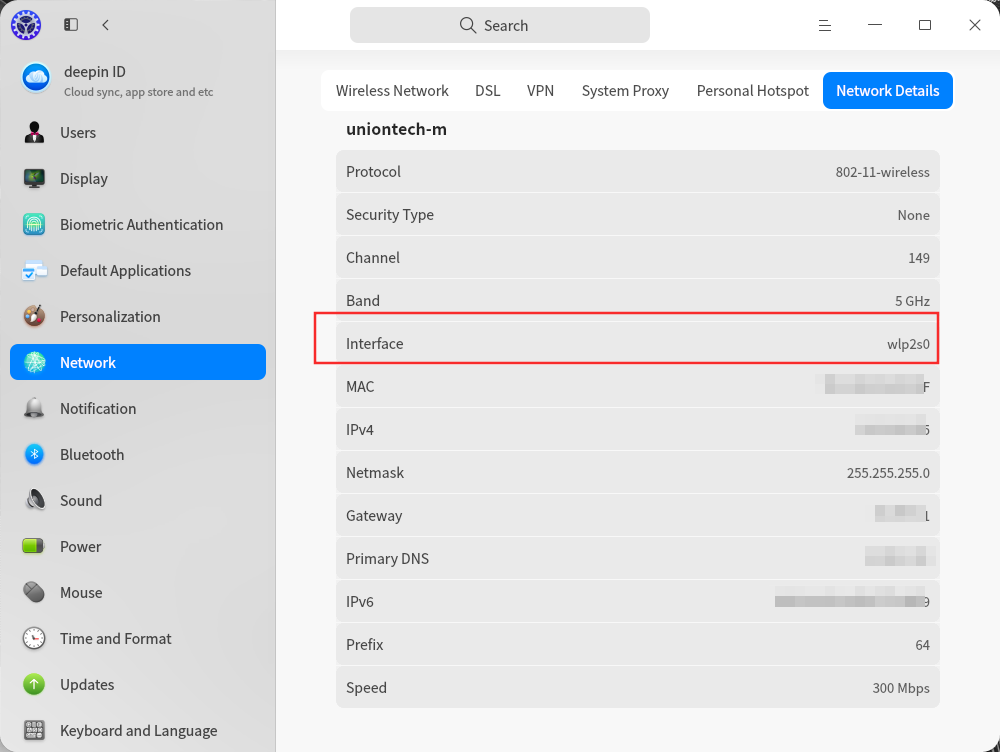

How to quickly check the network card interface: Go to Control Center-Network-Network Details and check Interface the field. The example below
wlp2s0the network card interface name.Modify /etc/nsswitch.conf and modify the hosts rule according to the following example. In short, this configuration will prioritize IPV4 resolution. If you want to prioritize IPV6, please adjust mdns4_minimalto mdns_minimal.

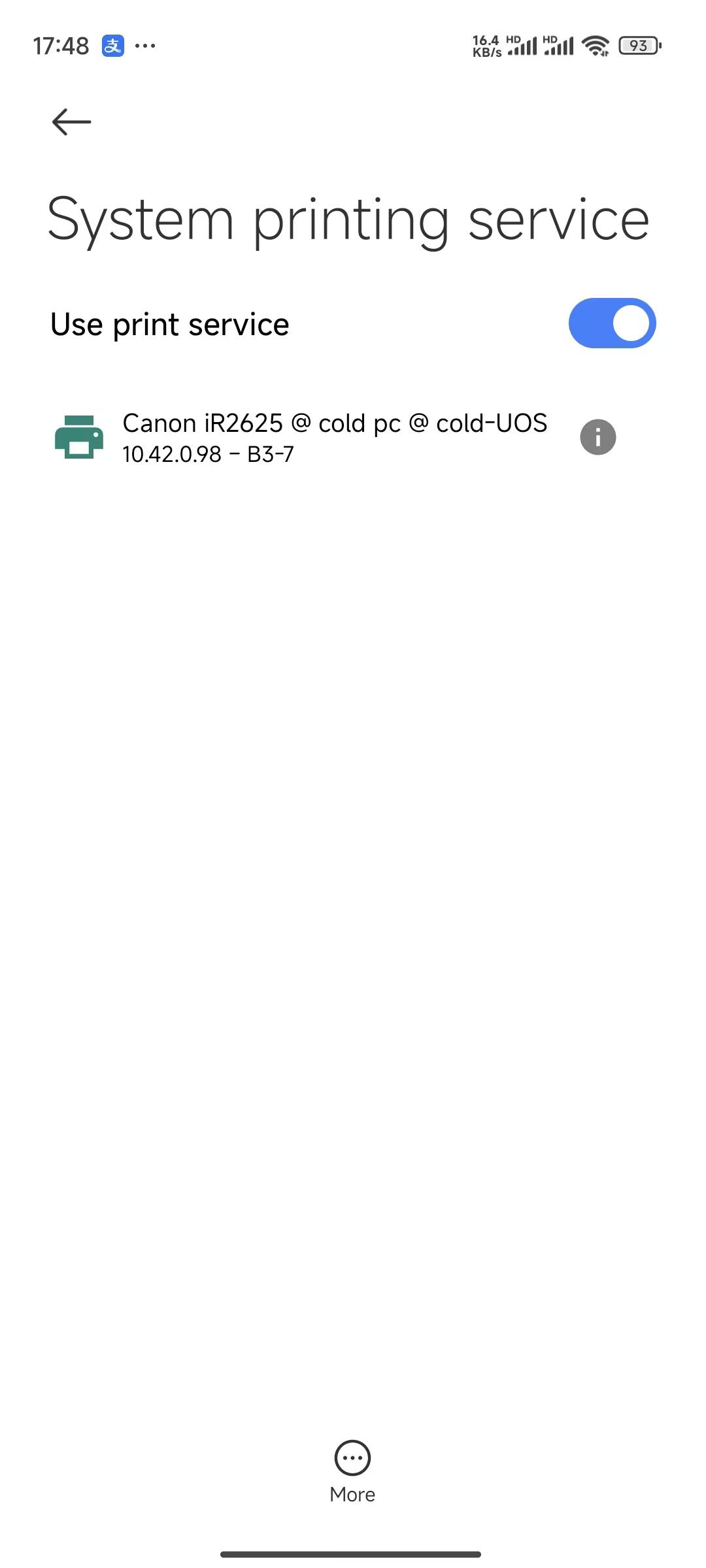

After completing the above configuration, you need to ensure that you are in the same LAN, so that you can directly use the shared printer on the mobile terminal. The following figure shows the usage status of Pengpai OS:
