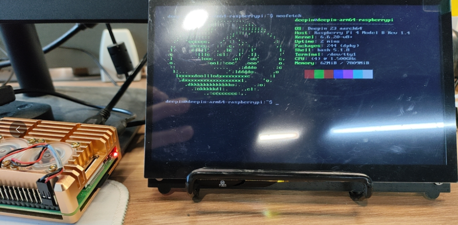

Directly insert the SD into the Raspberry Pi, power it on, and insert it into the display, no additional operations are required.

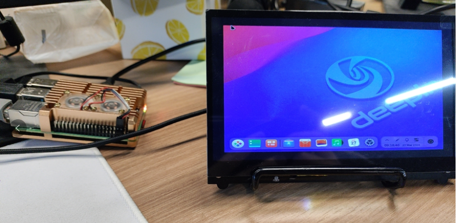

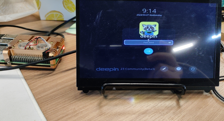

Install desktop environment
The stable source of arm may lack some packages. First add the ci for building.
sudo vim /etc/apt/sources.list
deb [trusted=yes] https://ci.deepin.com/repo/obs/deepin:/Develop:/main/standard/ ./
deb-src [trusted=yes] https://ci.deepin.com/repo/obs/deepin:/Develop:/main/standard/ ./
deb [trusted=yes] https://ci.deepin.com/repo/obs/deepin:/Develop:/community/deepin_develop/ ./
deb-src [trusted=yes] https://ci.deepin.com/repo/obs/deepin:/Develop:/community/deepin_develop/ ./
deb [trusted=yes] https://ci.deepin.com/repo/obs/deepin:/Develop:/dde/deepin_develop/ ./
deb-src [trusted=yes] https://ci.deepin.com/repo/obs/deepin:/Develop:/dde/deepin_develop/ ./
sudo apt update && sudo apt upgrade
sudo apt install deepin-desktop-environment-base
sudo apt install deepin-desktop-environment-cli
sudo apt install deepin-desktop-environment-core
sudo apt install deepin-desktop-environment-extras
sudo apt install deepin-desktop-environment-ll
After the installation is complete, you can choose to comment out the ci source to avoid dependency conflicts.
