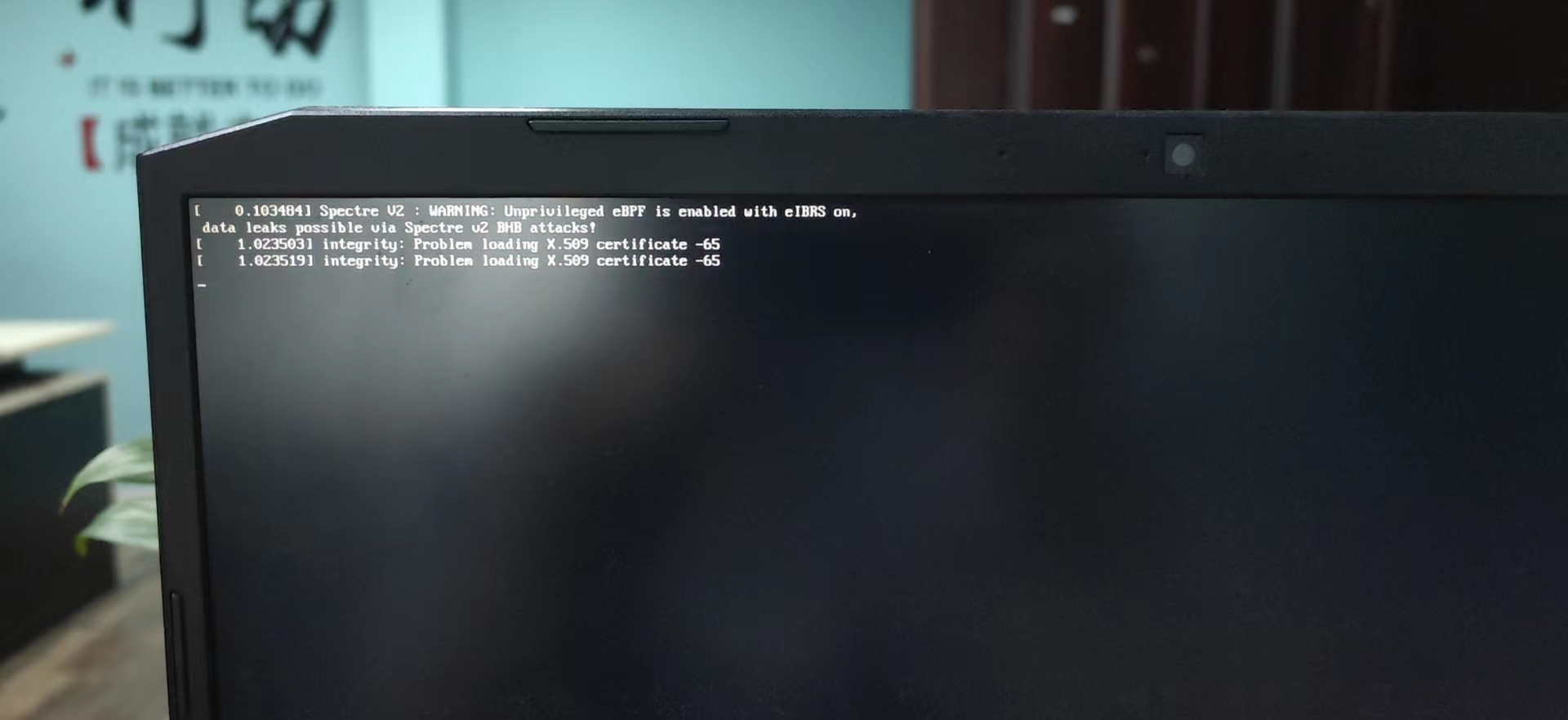

我安装了NVIDIA显卡驱动,然后外接显示器能显示,笔记本屏幕不能显示,电脑是acer nitro 5 an515-55

tangxin@tangxin-PC:~$ nvidia-smi
Fri Sep 16 16:14:17 2022
| NVIDIA-SMI 515.65.01    Driver Version: 515.65.01    CUDA Version: 11.7     |
| GPU  Name        Persistence-M| Bus-Id        Disp.A | Volatile Uncorr. ECC |
| Fan  Temp  Perf  Pwr:Usage/Cap|         Memory-Usage | GPU-Util  Compute M. |
|                               |                      |               MIG M. |
|   0  NVIDIA GeForce ...  Off  | 00000000:01:00.0  On |                  N/A |
| N/A   46C    P8     6W /  N/A |    384MiB /  4096MiB |     28%      Default |
|                               |                      |                  N/A |
| Processes:                                                                  |
|  GPU   GI   CI        PID   Type   Process name                  GPU Memory |
|        ID   ID                                                   Usage      |
|    0   N/A  N/A      4069      G   /usr/lib/xorg/Xorg                126MiB |
|    0   N/A  N/A      5012      G   kwin_x11                           41MiB |
|    0   N/A  N/A      6909      G   ...RendererForSitePerProcess      100MiB |
|    0   N/A  N/A      8007      G   ...156792834393876623,131072       99MiB |
|    0   N/A  N/A      9690      G   ...2\extracted\WeChatApp.exe        3MiB |
|    0   N/A  N/A     10958      G   ...tracted\WeChatBrowser.exe        3MiB |
|    0   N/A  N/A     13486      G   ...in/deepin-deepinid-client        4MiB |
tangxin@tangxin-PC:~$ xrandr
Screen 0: minimum 8 x 8, current 1920 x 1080, maximum 32767 x 32767
HDMI-0 connected primary 1920x1080+0+0 (normal left inverted right x axis y axis) 521mm x 293mm
   1920x1080     60.00*+
   1680x1050     59.95
   1440x900      59.89
   1280x1024     75.02    60.02
   1280x960      60.00
   1280x720      60.00
   1024x768      75.03    70.07    60.00
   800x600       75.00    72.19    60.32    56.25
   640x480       75.00    72.81    59.94
忘记、过去
2022-09-18 03:19
一般移除 /etc/X11/xorg.conf 文件,内屏就能正常显示了。默认的 xorg.conf 适合台式机或者独显直连的笔记本,你的 3050 显卡似乎不支持?
