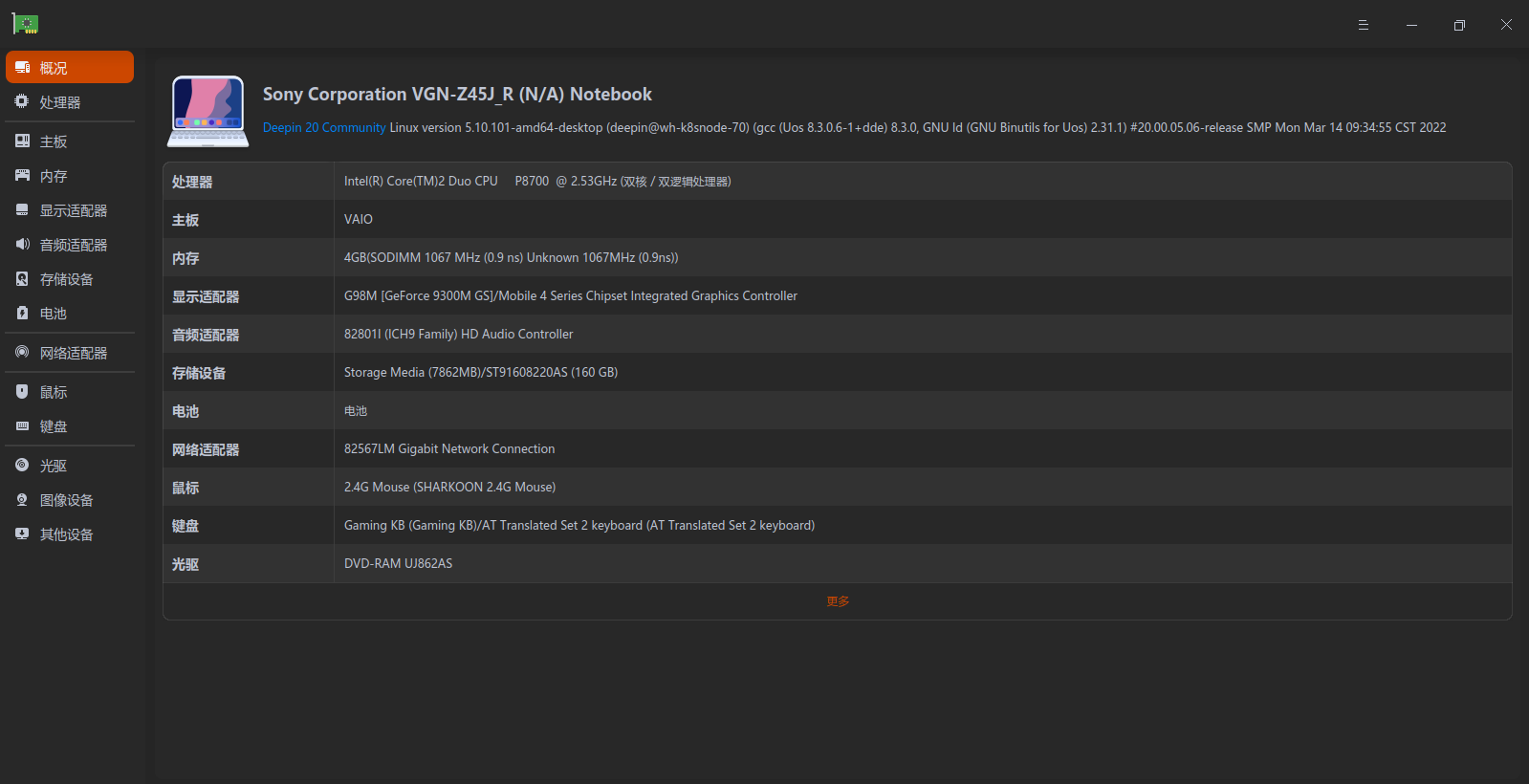

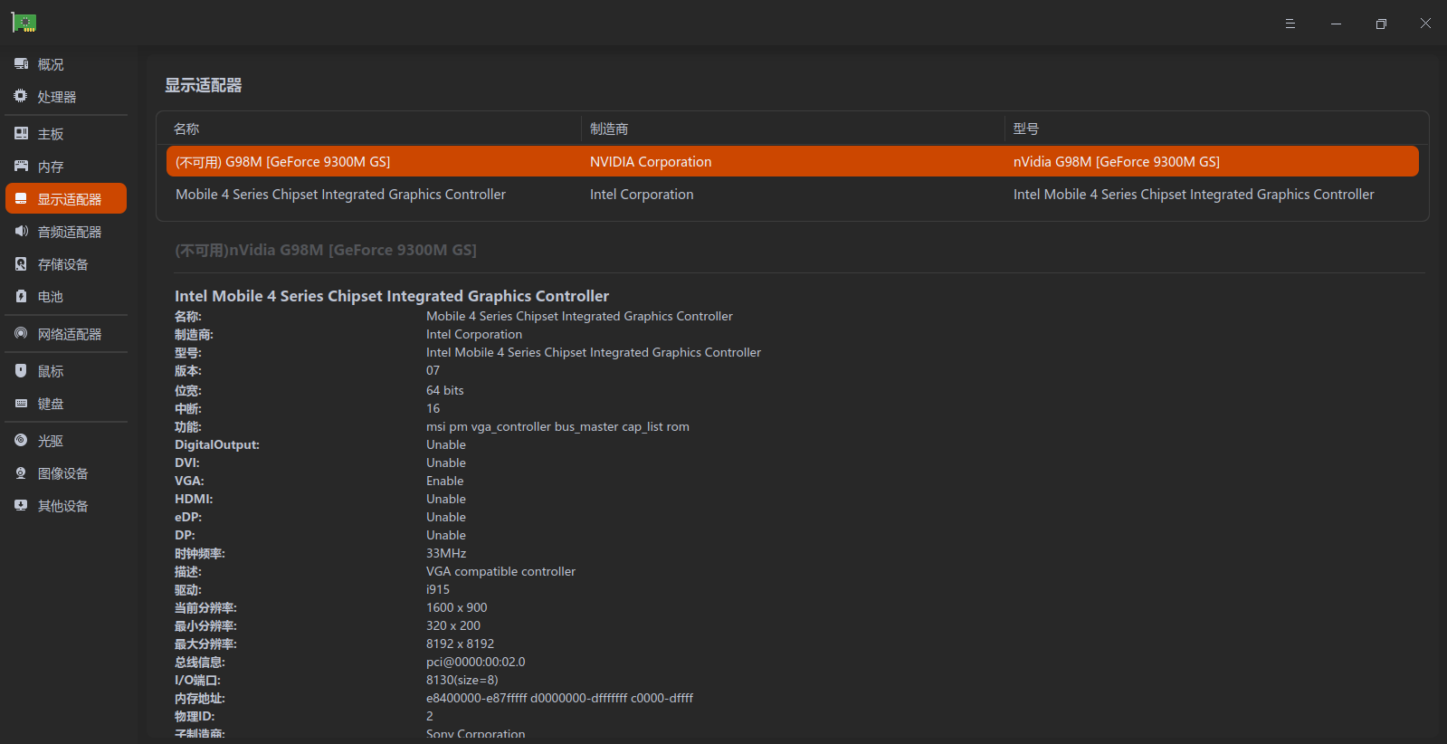

Nvida GeForce 93000M GS (G98M),一张神奇的显卡,貌似是索尼OEM版本,在Windows上就无法使用Nvida公版驱动,还是用了Sony Windows7版本的驱动(索尼把vaio卖掉之后就不提供技术支持了,我这电脑也比较少见,Deepin能支持最好,实在不行就算了)
2022-08-16 02:00
应该可以用,nvidia官网下载安装老版本驱动
2022-08-16 02:24
试试这个
https://www.nvidia.cn/Download/driverResults.aspx/156188/cn/
2022-08-16 06:41
太老了,要先换4.19内核再装304驱动
mcfans2019
2022-08-16 07:34
如果开源驱动能用就将就着,不打游戏的话还是能用的,老驱动不兼容现在的内核,降内核挺麻烦的

2022-08-23 02:00
jjcui8595:
试试这个
ERROR: You appear to be running an X server; please exit X before installing. For further details, please
see the section INSTALLING THE NVIDIA DRIVER in the README available on the Linux driver download
page at www.nvidia.com.
樱辞
2022-08-23 02:00
樱辞:
ERROR: Installation has failed. Please see the file '/var/log/nvidia-installer.log' for details. You may
find suggestions on fixing installation problems in the README available on the Linux driver
download page at www.nvidia.com.
2022-08-23 02:50
安装过程参考这个
https://bbs.deepin.org/phone/zh/post/238766
