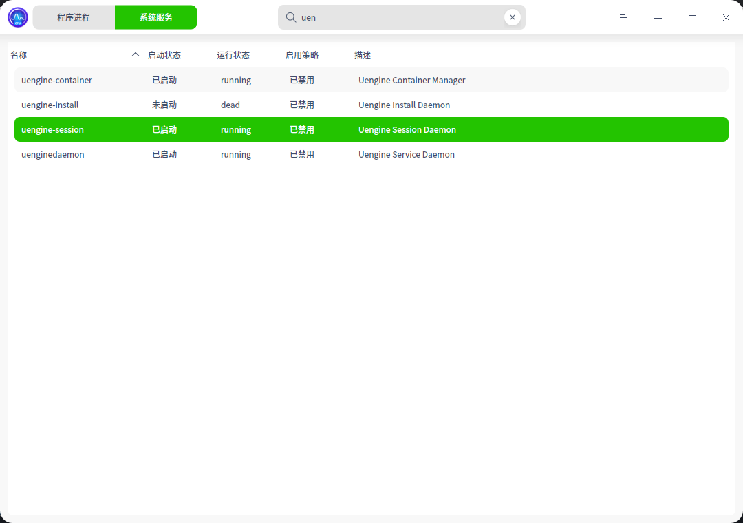

uengine服务已开启(如下图)

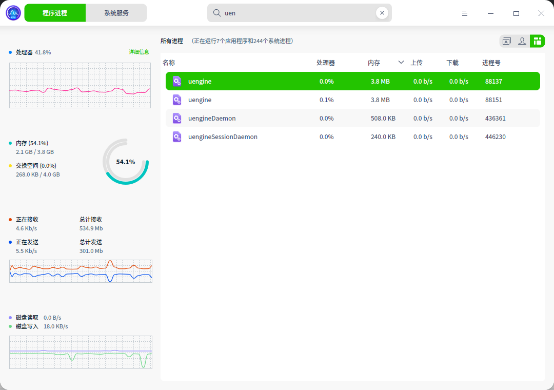

uengine进程如下
bail@Bail:~$ ps -ef | grep uengine
root       88137       1  0 8月04 ?       00:00:01 /usr/bin/uengine container-manager --daemon --privileged --data-path=/data/uengine/data --android-image=/usr/share/uengine/.android.img --container-network-dns-servers=114.114.114.114,180.76.76.76
root       88151   88137  0 8月04 ?       00:00:01 /usr/bin/uengine [dump daemon]
root      436361       1  0 12:19 ?        00:00:00 /usr/bin/uengineDaemon
root      446665       1  0 12:27 ?        00:00:00 /usr/bin/uengineSessionDaemon --data-path=/data/uengine/data
bail      446944  425995  0 12:27 pts/0    00:00:00 grep --color=auto uengine
bail@Bail:~$
