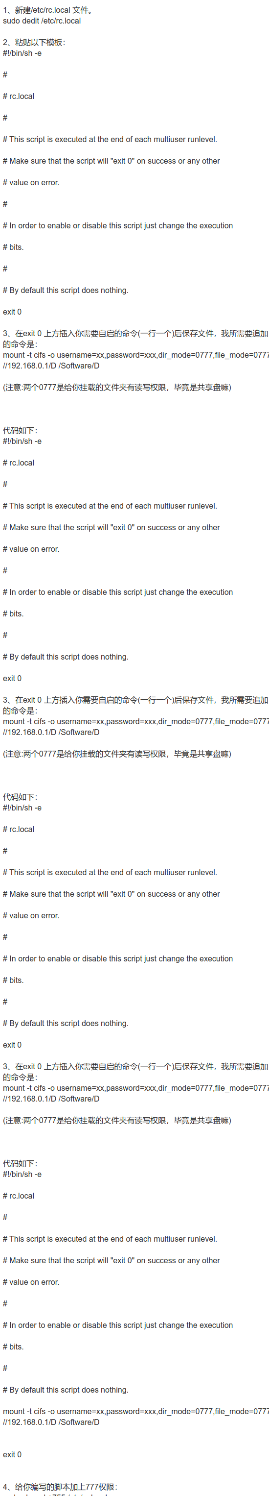

1、新建/etc/rc.local 文件。
sudo dedit /etc/rc.local
2、粘贴以下模板:
#!/bin/sh -e
rc.local
This script is executed at the end of each multiuser runlevel.
Make sure that the script will "exit 0" on success or any other
value on error.
In order to enable or disable this script just change the execution
bits.
By default this script does nothing.
exit 0
3、在exit 0 上方插入你需要自启的命令(一行一个)后保存文件,我所需要追加的命令是:
mount -t cifs -o username=xx,password=xxx,dir_mode=0777,file_mode=0777 //192.168.0.1/D /Software/D
(注意:两个0777是给你挂载的文件夹有读写权限,毕竟是共享盘嘛)
代码如下:
#!/bin/sh -e
rc.local
value on error.
bits.
exit 0
4、给你编写的脚本加上777权限:
sudo chmod +755 /etc/rc.local
5、可以调试一下自己的脚本是否成功:
sudo /etc/rc.local
