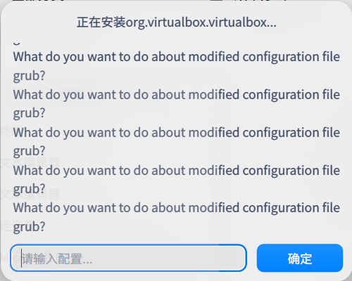

安装virtualbox请输入配置
请问这个地方该怎么解决

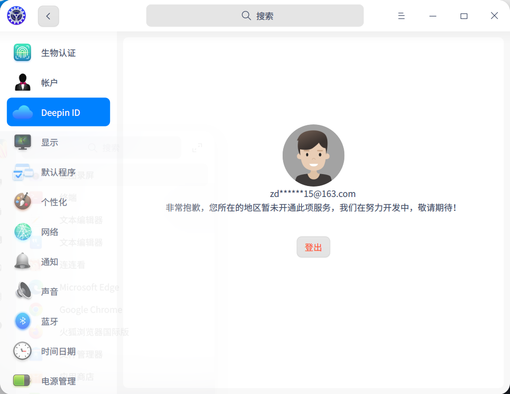

问题2

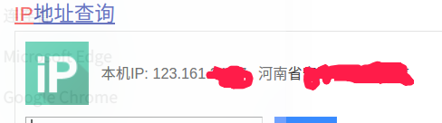

显示未开通服务怎么回事啊 我在国内啊 又不是国外

  • virtualbox 安装的时候,日志输出那里会有几个选项,可以仔细看看,然后选择一个选项前面的数字输入回车即可;
  • 你的IP是不是非国内的额?
狂飙的蜗牛
2022-04-18 22:05
babyfengfjx:
  • 你的IP是不是非国内的额?
Reading package lists...
Building dependency tree...
Reading state information...
The following additional packages will be installed:
  deepin-elf-verify freeglut3 grub-pc grub-pc-bin libsdl-ttf2.0-0
  linux-compiler-gcc-8-x86 linux-headers-5.3.0-3-amd64
  linux-headers-5.3.0-3-common linux-headers-amd64
  linux-image-unsigned-5.3.0-42-generic linux-kbuild-5.3
  linux-modules-5.3.0-42-generic org.mupdf
Suggested packages:
  desktop-base fdutils linux-doc-5.3.0 | linux-source-5.3.0 linux-tools
  linux-headers-5.3.0-42-generic mupdf-tools
The following NEW packages will be installed:
  linux-modules-5.3.0-42-generic org.mupdf org.virtualbox.virtualbox
0 upgraded, 14 newly installed, 0 to remove and 0 not upgraded.
Need to get 0 B/210 MB of archives.
After this operation, 519 MB of additional disk space will be used.
(Reading database ... 223545 files and directories currently installed.)
Preparing to unpack .../00-org.virtualbox.virtualbox_6.1.30-148432~Debian~buster_amd64.deb ...
Unpacking org.virtualbox.virtualbox (6.1.30-148432~Debian~buster) ...
Selecting previously unselected package deepin-elf-verify.
Preparing to unpack .../01-deepin-elf-verify_0.2.0.6-1_amd64.deb ...
Unpacking deepin-elf-verify (0.2.0.6-1) ...
Selecting previously unselected package freeglut3:amd64.
Preparing to unpack .../02-freeglut3_2.8.1-3+apricot_amd64.deb ...
Unpacking freeglut3:amd64 (2.8.1-3+apricot) ...
Selecting previously unselected package grub-pc-bin.
Preparing to unpack .../03-grub-pc-bin_2.04.3-17_amd64.deb ...
Unpacking grub-pc-bin (2.04.3-17) ...
Selecting previously unselected package grub-pc.
Preparing to unpack .../04-grub-pc_2.04.3-17_amd64.deb ...
Unpacking grub-pc (2.04.3-17) ...
Selecting previously unselected package libsdl-ttf2.0-0:amd64.
Preparing to unpack .../05-libsdl-ttf2.0-0_2.0.11-6_amd64.deb ...
Unpacking libsdl-ttf2.0-0:amd64 (2.0.11-6) ...
Selecting previously unselected package linux-compiler-gcc-8-x86.
Preparing to unpack .../06-linux-compiler-gcc-8-x86_5.10.84-1_amd64.deb ...
Unpacking linux-compiler-gcc-8-x86 (5.10.84-1) ...
Selecting previously unselected package linux-headers-5.3.0-3-common.
Preparing to unpack .../07-linux-headers-5.3.0-3-common_5.3.15-6apricot_all.deb ...
Unpacking linux-headers-5.3.0-3-common (5.3.15-6apricot) ...
Selecting previously unselected package linux-kbuild-5.3.
Preparing to unpack .../08-linux-kbuild-5.3_5.3.15-6apricot_amd64.deb ...
Unpacking linux-kbuild-5.3 (5.3.15-6apricot) ...
Selecting previously unselected package linux-headers-5.3.0-3-amd64.
Preparing to unpack .../09-linux-headers-5.3.0-3-amd64_5.3.15-6apricot_amd64.deb ...
Unpacking linux-headers-5.3.0-3-amd64 (5.3.15-6apricot) ...
Selecting previously unselected package linux-headers-amd64.
Preparing to unpack .../10-linux-headers-amd64_5.3.15-6apricot_amd64.deb ...
Unpacking linux-headers-amd64 (5.3.15-6apricot) ...
Selecting previously unselected package linux-modules-5.3.0-42-generic.
Preparing to unpack .../11-linux-modules-5.3.0-42-generic_5.3.0-42.34_amd64.deb ...
Unpacking linux-modules-5.3.0-42-generic (5.3.0-42.34) ...
Selecting previously unselected package linux-image-unsigned-5.3.0-42-generic.
Preparing to unpack .../12-linux-image-unsigned-5.3.0-42-generic_5.3.0-42.34_amd64.deb ...
Unpacking linux-image-unsigned-5.3.0-42-generic (5.3.0-42.34) ...
Selecting previously unselected package org.mupdf.
Preparing to unpack .../13-org.mupdf_1.14.0+ds1-4+deb10u2_amd64.deb ...
Unpacking org.mupdf (1.14.0+ds1-4+deb10u2) ...
Setting up linux-compiler-gcc-8-x86 (5.10.84-1) ...
Setting up freeglut3:amd64 (2.8.1-3+apricot) ...
Setting up org.virtualbox.virtualbox (6.1.30-148432~Debian~buster) ...
Adding group `vboxusers' (GID 129) ...
Done.
Setting up deepin-elf-verify (0.2.0.6-1) ...
Setting up grub-pc-bin (2.04.3-17) ...
Setting up linux-headers-5.3.0-3-common (5.3.15-6apricot) ...
Setting up grub-pc (2.04.3-17) ...
Configuring grub-pc
grub: A new version (/tmp/grub.O1pF7UusVG) of configuration file
/etc/default/grub is available, but the version installed currently has been
locally modified.
  1. install the package maintainer's version
  2. keep the local version currently installed
  3. show the differences between the versions
  4. show a side-by-side difference between the versions
  5. start a new shell to examine the situation
What do you want to do about modified configuration file grub?
这是安装代码 具体原因出在哪里我也不清楚
回复2
你看我的IP

我装的时候好像没遇到,也可能是我忘了,你终端用dpkg执行安装试试,提示要全一点

好像是unstable版本会这样,或者你看看设置里时间时区

去下载run版安装吧,deb的有依赖问题
地址在这:http://download.virtualbox.org/virtualbox/

1:问题已经解决了,我强制退出安装程序,然后在终端随便安装一个软件,让我继续刚才的安装程序, 继续安装就好了,我一会重试一下能不能复现。
2:当前登入账号还显示不在服务范围!!!
所以说run版更好,安装卸载都方便

你的时间归属地选的是哪?不是国内?
狂飙的蜗牛
2022-04-21 00:21
寰宇ζ:
你的时间归属地选的是哪?不是国内?
肯定是国内啊。但是还是不能登录
chinaq110
2023-08-29 16:45
这个强制结束怎么操作的呢,我用kill -9 都结束不了。

chinaq110:
直接按数字 1 即可。
钱多多
2023-12-02 07:48
直接按数字 1 即可。
该问题应该是产生于Virtual Box 更新过程中 某些依赖包需要选择,而通过应用商店方式更新时无法像 终端显示全部信息,因此无法获悉选项内容是什么,通过 按 数字1 可正常完成 Virtual Box更新。
