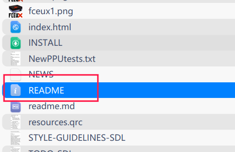

github上有各版本下载:
https://github.com/TASEmulators/fceux
https://github.com/TASEmulators/fceux/releases
源码安装步骤,README写的很清楚了

源码安装步骤,README写的很清楚了
谢谢 正在研究 没弄太明白

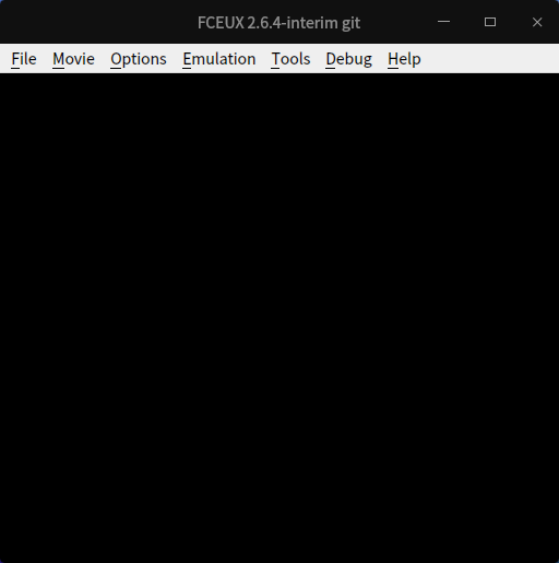

所以就长这样......

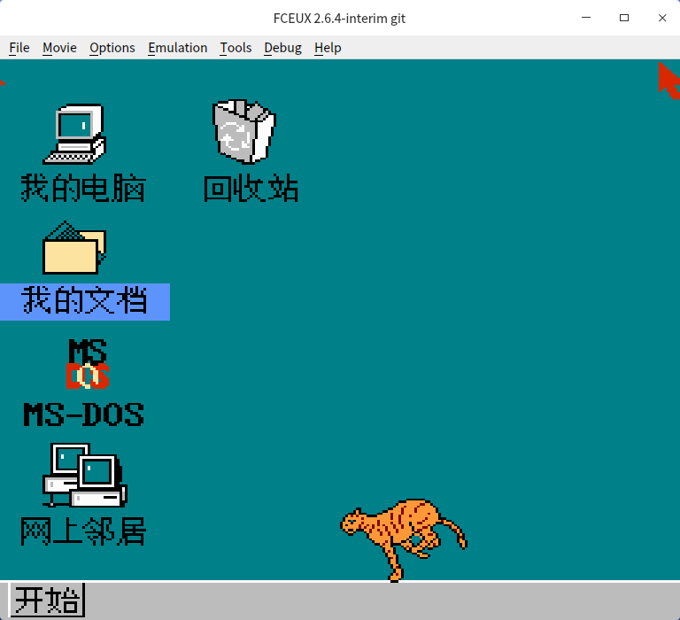

fceux-小霸王-视窗2000
deepin@G470:~/Downloads/fceux-fceux-2.6.4$ sudo apt install libsdl2-dev cmake qt5-qmake liblua5.1-0 libminizip-dev libx264-dev libx265-dev zlib1g zlibc g++ qtbase5-dev ffmpeg libavcodec-dev libavformat-dev libavutil-dev libswresample-dev libswscale-dev
deepin@G470:~/Downloads/fceux-fceux-2.6.4$ cmake  -DCMAKE_INSTALL_PREFIX=/usr  -DCMAKE_BUILD_TYPE=Release
deepin@G470:~/Downloads/fceux-fceux-2.6.4$ make
deepin@G470:~/Downloads/fceux-fceux-2.6.4$ sudo make install
