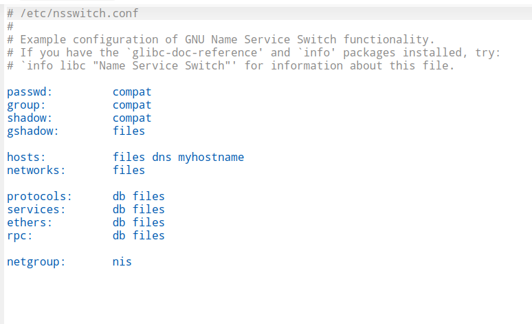

andktan
2022-03-28 16:42
deepinuser17:
查看一下:
cat /etc/nsswitch.conf

deepinuser17
2022-04-11 06:37
这是我的机器上设置:
# /etc/nsswitch.conf
# Example configuration of GNU Name Service Switch functionality.
# If you have the `glibc-doc-reference' and `info' packages installed, try:
# `info libc "Name Service Switch"' for information about this file.
passwd:         files
group:          files
shadow:         files
gshadow:        files
hosts:          files dns
networks:       files
protocols:      db files
services:       db files
ethers:         db files
rpc:            db files
netgroup:       nis
如果不用ldap, 或其它账户服务器, 把passwd, group, shadow, gshadow的值改成files就行了
