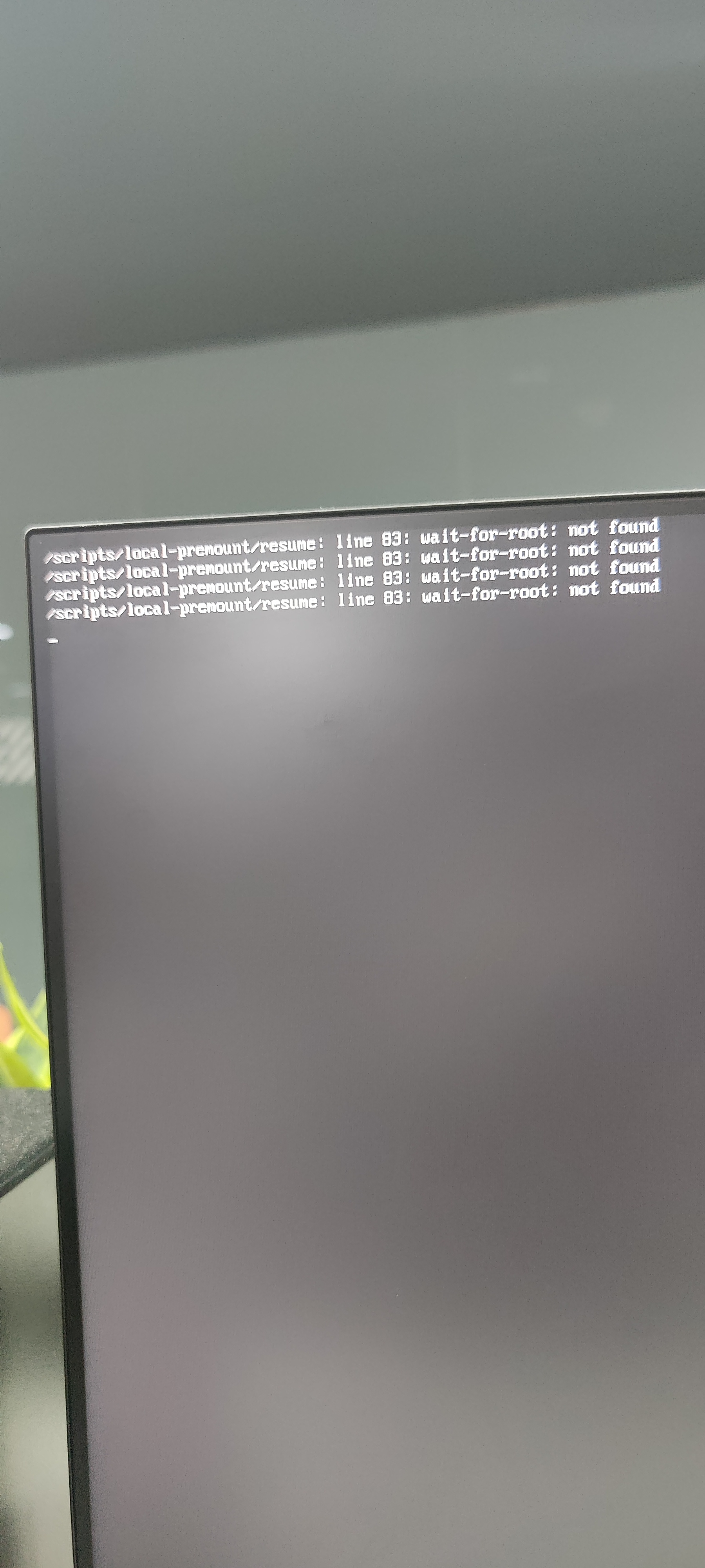

上次系统更新之后,电脑休眠或待机无法重新唤醒,但重启可以正常开机。
随后官方发了公告,说已经修复此BUG,我更新了补丁之后,电脑可以正常从休眠状态唤醒了。
但重启之后无法开机了,卡在开机Logo界面,按Esc键显示以下内容:
/scripts/local-premount/resume: line 83: wait-for-root: not found
请问如何是好?

  • 这个还真有一部分用于也遇到了,不知道是否方便我找个研发远程帮忙看看?
  • 可以在grub界面,选择advance按钮,切换到之前版本的内核启动可以。

I've experienced similar boot issues with Linux systems after updates, and it can be quite frustrating. The error you're encountering with wait-for-root typically relates to initramfs problems. I'd suggest trying to boot from a live USB and chroot into your system to rebuild the initramfs using update-initramfs -u command. You might also want to check your fstab file for any incorrect UUID references. If you have access to recovery mode, that could be another viable option. Sometimes rolling back the problematic update through package management helps too. During these stressful troubleshooting sessions, I often take breaks with casual games like heardle to clear my mind before diving back into terminal commands.
