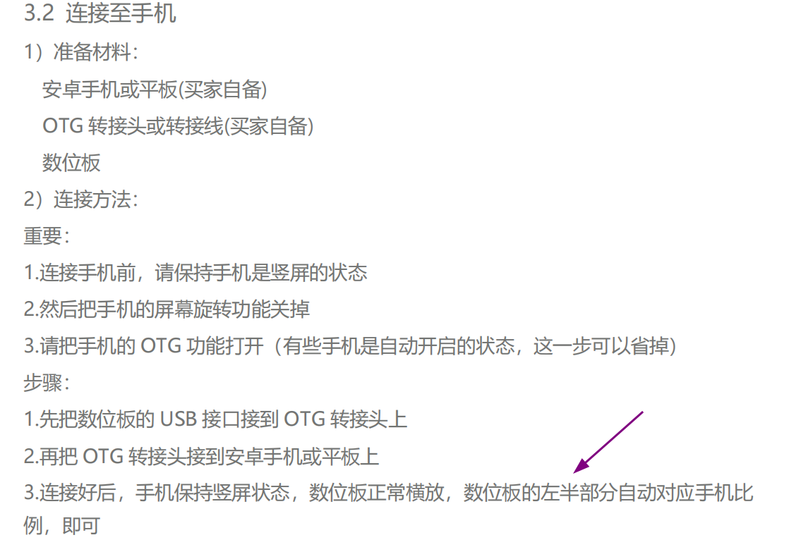

我也出现了这个问题,正在解决。不过我使用的archlinux。我在github上看到有人说高漫m6使用了绘王的硬件,它在安卓模式下只能使用左边的三分之一,并且在高漫m6的说明书也提到这个问题。
并且github上也提到了同时按1和5键,可以禁用安卓模式,但是我没有成功。
Could you try pressing buttons 1 and 5 (top left, and 3rd from the top on the left) at the same time and hold for a few seconds? Gaomon tablets seem to internally use Huion hardware, and many of Huion's tablets have an "Android mode" which only enables the left 1/3rd or so of the tablet. This mode can be enabled by pressing a specific pair of buttons at the same time, but that same combo apparently also works to disable it.
我觉的可能是安卓模式的问题,希望可以给你提供帮助。
