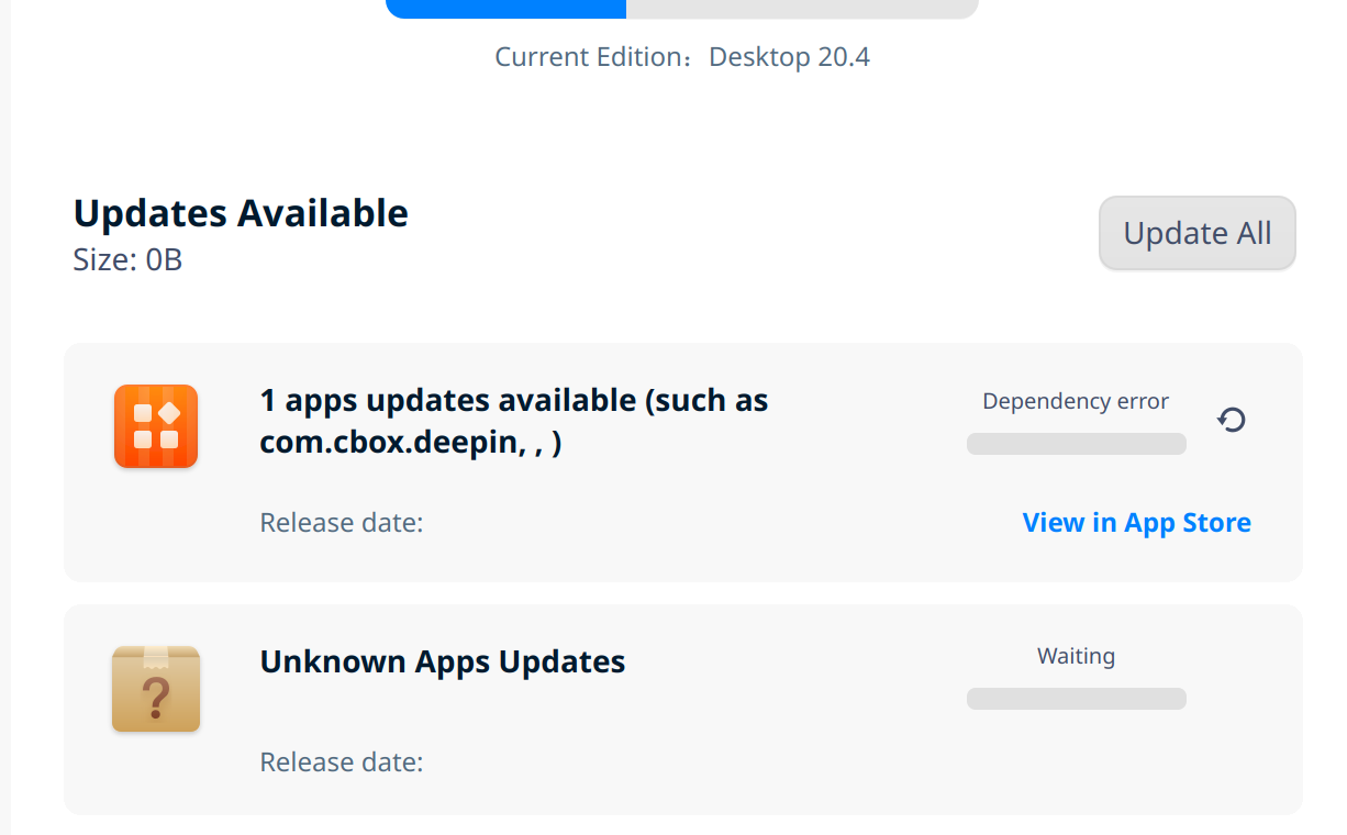

希望尽快修复,严重影响正常使用
1.system center更新卡住
2.terminal更新失败

$ sudo apt purge libimage-viewer Reading package lists... Done Building dependency tree Reading state information... Done You might want to run 'apt --fix-broken install' to correct these. The following packages have unmet dependencies: deepin-album : Depends: libimageeditor but it is not going to be installed deepin-camera : Depends: libimageeditor but it is not going to be installed deepin-image-viewer : Depends: libimageeditor but it is not going to be installed Recommends: libqt5libqgtk2 but it is not installable E: Unmet dependencies. Try 'apt --fix-broken install' with no packages (or specify a solution).
执行‘apt --fix-broken install’它又会遇到和更新一样的问题
4.尝试安装新应用失败
$ sudo apt install vim Reading package lists... Done Building dependency tree Reading state information... Done vim is already the newest version (2:8.1.0875.1-1+deepin). You might want to run 'apt --fix-broken install' to correct these. The following packages have unmet dependencies: deepin-album : Depends: libimageeditor but it is not going to be installed deepin-camera : Depends: libimageeditor but it is not going to be installed deepin-image-viewer : Depends: libimageeditor but it is not going to be installed Recommends: libqt5libqgtk2 but it is not installable E: Unmet dependencies. Try 'apt --fix-broken install' with no packages (or specify a solution).
希望尽快修复,严重影响正常使用
