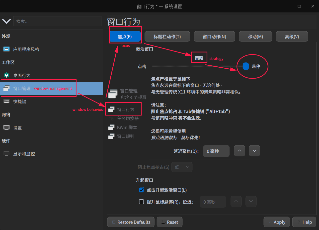

2021-12-31 09:09 maybe you can install the systemsettings tool for kde (sudo apt install systemsettings). It seems this tool can configure some of the features you mentioned above.
e.g. "1.1.3 focus follow the mouse" can be set by
