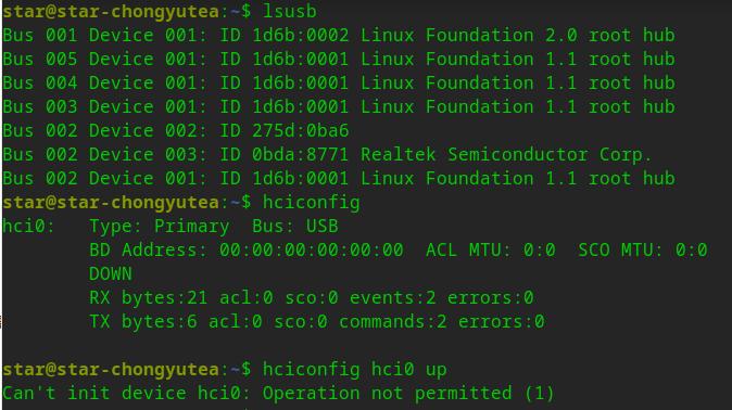

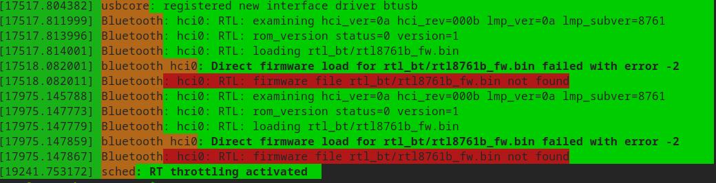

lucxtar
2021-11-26 01:09
Can't init device hci0: No such file or directory

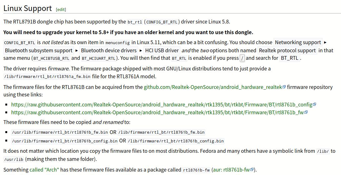

梦游世界
2021-11-26 01:41
网上下载RTL8761B Linux驱动,然后解压,复制 urb、rtkbt-firmware文件夹到桌面
在终端:
cd usb
$ sudo make install
cd ..
$ sudo cp rtkbt-firmware/lib/firmware/rtl8761b_fw /lib/firmware/
$ sudo cp rtkbt-firmware/lib/firmware/rtl8761b_config /lib/firmware/
然后重启电脑

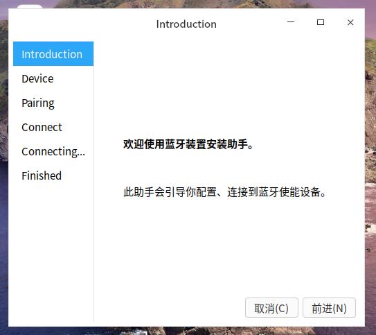

lucxtar
2021-11-26 05:18
搞定了,哈哈
