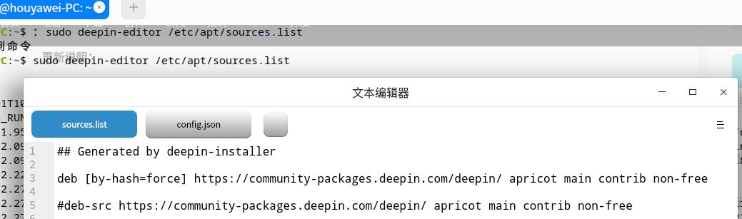

1、将系统修改为内部测试源,终端执行以下命令:sudo deepin-editor /etc/apt/sources.list
2、然后使用以下内容覆盖sources.list文件,然后保存并退出。

#23
话说sudo dedit怎么变得这么丑,不是deepin-editor?三台笔记本都这样,是不是我都装了什么东西,有依赖冲突?

2021-08-01, 10:48:20.005 [Info   ] [                                                         0] "[GRABPOINT] POINT-04 filename=/etc/trojan/config.json filezise=0.000952M opentime=1627786100005ms #(Open file time)"
2021-08-01, 10:49:00.868 [Debug  ] [                                                         0] LOG_FLAG "2021-08-01T10:49:00.867" start to close app
2021-08-01, 10:49:00.873 [Debug  ] [                                                         0] LOG_FLAG "2021-08-01T10:49:00.873"  finish to close app
2021-08-01, 10:49:00.873 [Info   ] [                                                         0] "[GRABPOINT] POINT-02 closeduration=6ms #(Close app time)"
Error org.freedesktop.DBus.Error.ServiceUnknown: The name com.iflytek.aiassistant was not provided by any .service files
内测的应该都这样,不清楚什么时候修
