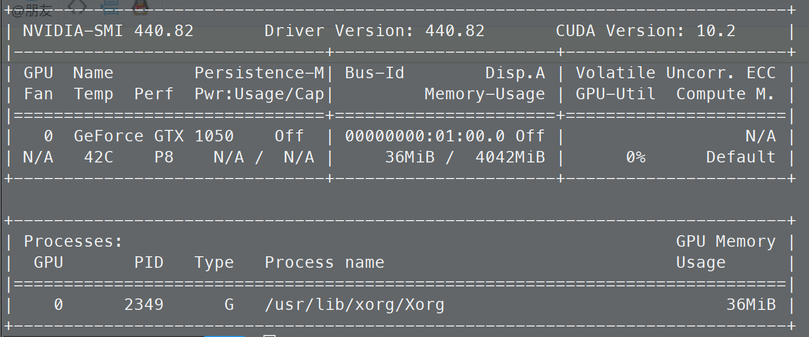

如题,在安装Nvidia显卡驱动(以及大神的nvidia-prime方案,文中其实有说过有风险)后

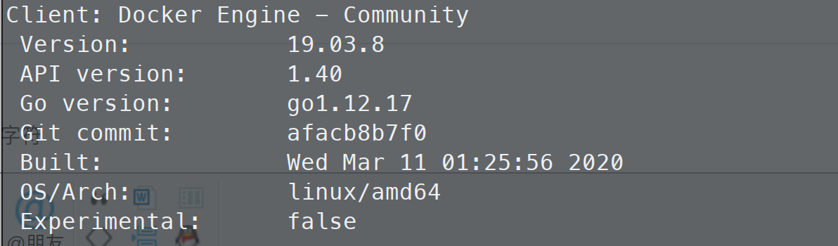

尝试安装了debian分支的docker
然后安装了debian10分支的nvidia-container-toolkit
然后根据官方建议用nvidia -smi测试cuda官方image之后报错
sudo docker run --gpus all nvidia/cuda:10.0-base nvidia-smi
NVIDIA-SMI couldn't find libnvidia-ml.so library in your system. Please make sure that the NVIDIA Display Driver is properly installed and present in your system.
Please also try adding directory that contains libnvidia-ml.so to your system PATH.
因为是小白,目前都是根据论坛以及网上的文章七拼八凑装起来的,完全不知道哪里出现了问题(甚至不知道有没有发对版块)希望能得到前辈指点
