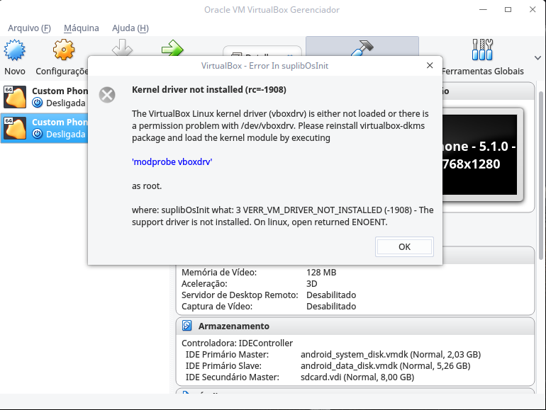

How to resolve this error in the virtual box. Thankful!
Como resolver este erro no virtual box. Grato!

The Virtualbox driver is not (correctly) installed.
You can try to fix it with the following commands:
sudo apt-get install virtualbox-dkms
If it tells you that it's already installed,use this:
sudo apt-get install --reinstall virtualbox-dkms
And then run a second command to enable the driver:
sudo modprobe vboxdrv

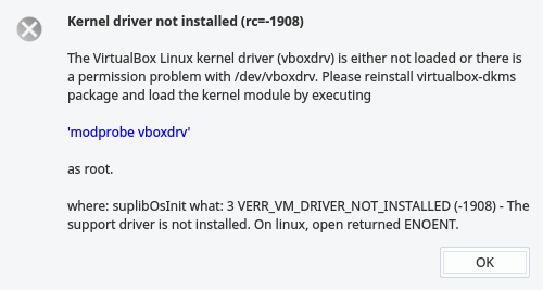

https://bbs.deepin.org/post/153837
You can try to fix it with the following command ...
segue anexo print
siga anexo de impressão
