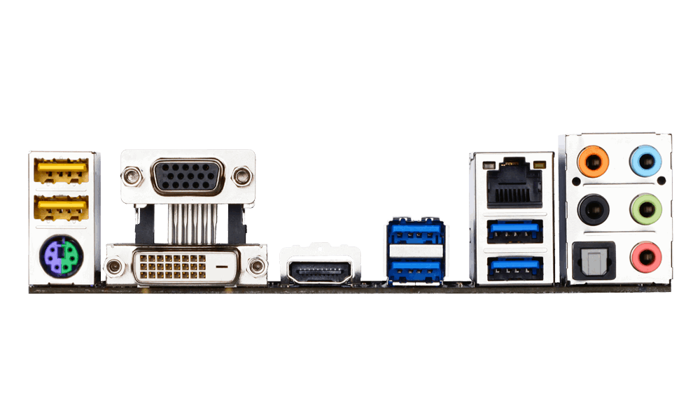

My mainboard is a h170 gaming 3. I am connecting the monitor on the left: benq Full hd with the HDMI cable, and the one on the right and HD monitor with the VGA cable.
http://imgur.com/bCagJap
