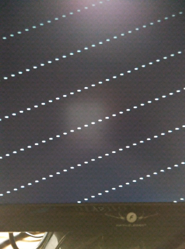

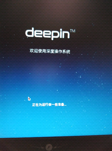

As debian updated Xorg in upstream, users who used Deepin Boot Maker for original installation will encounter driver failure and results in boot failure.
If you have already upgraded and can not enter the system.
Please startup and wait till it is ready (if you are not sure, please wait two minutes after system startup), press Ctrl + Alt + F1 to switch to tty1. Then login with your account (touch input your password and press enter, the password will not echo) and execute:
- wget http://packages.deepin.com/rpa/fix.sh && sudo chmod +x fix.sh && sudo ./fix.sh
This script will automatically fix the system. After it is done (that is, no output and the cursor is in waiting-for-input status), then press Ctrl + Alt + Del to reboot.
Now the system should be able to boot normally.
