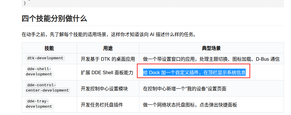

在动手之前,先了解每个技能的适用场景,这样你才知道该向 AI 描述什么样的任务。
dtk-development
dde-shell-development
dde-control-center-development
dde-tray-development
下面用四个实例分别演示。

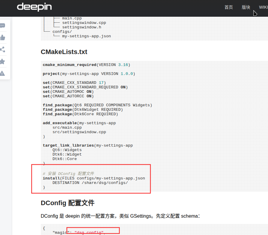

cmake_minimum_required(VERSION 3.16) project(my-settings-app VERSION 1.0.0) set(CMAKE_CXX_STANDARD 17) set(CMAKE_CXX_STANDARD_REQUIRED ON) set(CMAKE_AUTOMOC ON) set(CMAKE_AUTORCC ON) find_package(Qt6 REQUIRED COMPONENTS Widgets) find_package(Dtk6Widget REQUIRED) find_package(Dtk6Core REQUIRED) add_executable(my-settings-app src/main.cpp src/settingswindow.cpp ) target_link_libraries(my-settings-app Qt6::Widgets Dtk6::Widget Dtk6::Core ) # 安装 DConfig 配置文件 install(FILES configs/my-settings-app.json DESTINATION /share/dsg/configs/ )
DConfig 是 deepin 的统一配置方案,类似 GSettings。先定义配置 schema:
{ "magic": "dsg.config", "version": "1.0", "contents": { "enable_notifications": { "value": true, "serial": 0, "name": "启用通知", "description": "控制是否接收应用通知" }, "theme_mode": { "value": "auto", "name": "主题模式", "description": "auto/light/dark" } } }

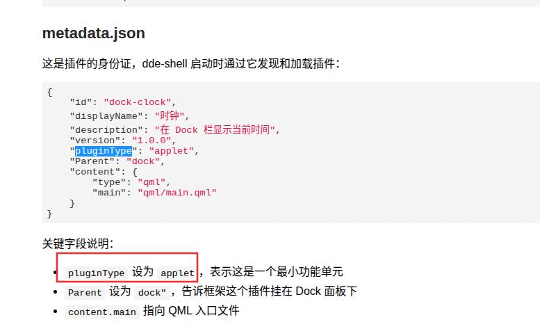

这是插件的身份证,dde-shell 启动时通过它发现和加载插件: { "id": "dock-clock", "displayName": "时钟", "description": "在 Dock 栏显示当前时间", "version": "1.0.0", "pluginType": "applet", "Parent": "dock", "content": { "type": "qml", "main": "qml/main.qml" } } 关键字段说明:
关键字段说明:
pluginType
applet
Parent
dock"
content.main
import QtQuick import org.deepin.ds 1.0 AppletItem { id: clockApplet // 插件在 Dock 中的尺寸 implicitWidth: 80 implicitHeight: 40 // 时间更新定时器 Timer { interval: 1000 running: true repeat: true onTriggered: timeLabel.text = Qt.formatDateTime(new Date(), "HH:mm") } // 显示时间的文本 Text { id: timeLabel anchors.centerIn: parent text: Qt.formatDateTime(new Date(), "HH:mm") font.pixelSize: 16 color: palette.windowText } // 点击弹出面板 Panel.popup { id: clockPopup width: 220 height: 120 Column { anchors.centerIn: parent spacing: 8 Text { anchors.horizontalCenter: parent.horizontalCenter text: Qt.formatDateTime(new Date(), "yyyy-MM-dd") font.pixelSize: 24 color: palette.windowText } Text { anchors.horizontalCenter: parent.horizontalCenter text: { var days = ["星期日", "星期一", "星期二", "星期三", "星期四", "星期五", "星期六"]; return days[new Date().getDay()]; } font.pixelSize: 16 color: palette.windowText } } } MouseArea { anchors.fill: parent onClicked: clockPopup.visible = !clockPopup.visible } }

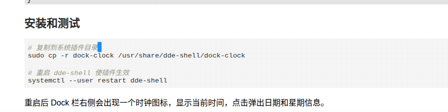

# 复制到系统插件目录 sudo cp -r dock-clock /usr/share/dde-shell/dock-clock # 重启 dde-shell 使插件生效 systemctl --user restart dde-shell
重启后 Dock 栏右侧会出现一个时钟图标,显示当前时间,点击弹出日期和星期信息。

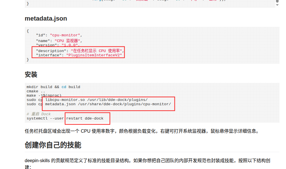

{ "id": "cpu-monitor", "name": "CPU 监视器", "version": "1.0.0", "description": "在任务栏显示 CPU 使用率", "interface": "PluginsItemInterfaceV2" }
安装
任务栏托盘区域会出现一个 CPU 使用率数字,颜色根据负载变化,右键可打开系统监视器,鼠标悬停显示详细信息。 创建你自己的技能 deepin-skills 的贡献规范定义了标准的技能目录结构。如果你想把自己团队的内部开发规范也封装成技能,按照以下结构创建: skills/my-custom-skill/ ├── SKILL.md ├── agents/ │ └── openai.yaml ├── references/ │ └── my-reference.md └── evals/ ├── README.md └── my-test.md SKILL.md 模板 --- name: my-custom-skill description: "我的自定义技能描述,告诉 AI 这个技能在什么场景下触发" --- # 我的自定义技能 ## 文档路由 | 场景 | 参考文档 | |------|----------| | 了解架构 | references/architecture.md | | API 参考 | references/api.md | ## 高频场景 - 场景 A → references/a.md - 场景 B → references/b.md 核心原则是:SKILL.md 只放路由信息和触发条件,详细技术内容放 references/,验证场景放 evals/。这样 AI 只在需要时才加载具体文档,不会浪费上下文窗口。 openai.yaml 模板 skills: - name: my-custom-skill description: "技能描述" system_prompt: | 你是一个 my-custom-skill 专家,当用户提到 XXX 时触发此技能。 提交贡献 fork 仓库后,把你的技能放在 skills/ 下,同步更新 README.md 中的技能列表,然后提交 Pull Request。贡献前请阅读仓库的 CONTRIBUTING.md 了解完整规范。 常见问题排查 AI 没有触发技能 检查 SKILL.md 中的 description 字段是否准确描述了触发场景。如果描述太宽泛,AI 可能无法正确匹配。尝试在对话中明确提及技能名称,例如"使用 dtk-development 技能帮我..."。 技能安装后不生效 确认技能目录路径正确: ls ~/.agents/skills/dtk-development/SKILL.md 如果路径没问题,重启你的 AI 编程 Agent 让它重新扫描技能目录。 UOS AI 执行技能时报错 大部分技能需要 bash 执行权限。确认 MCP 配置中已添加 bash-mcp(见上文安装部分),然后在对话中点击"重新生成"。 插件安装后不显示 DDE Shell 插件需要检查 Parent 字段是否指向了正确的面板(如 dock、top-bar)。控制中心插件需要检查 pluginType 是否为 control-center。重启对应服务后检查日志: # Dock 日志 journalctl --user -u dde-shell -f # 控制中心日志 QT_LOGGING_RULES="*.debug=true" dde-control-center 2>&1 | grep network 四个技能的评估用例分布 deepin-skills 为每个技能配套了验证测试用例(Evals),确保 AI 使用技能时能正确理解和应用技术知识。以下是各技能的用例数量和分类:

大佬好,这个帖子确实是个好东西,完全展示了开发流程及成果, 请问下,你这是用deepin-skills中是几个skill写的么?我看里面贴的代码有些问题,如果是skill有问题,欢迎提出问题,另外写的example也可以提到这里 ,O(∩_∩)O谢谢,
它不是用来开发dock插件的,是dde-shell插件的,目前像桌面和任务栏都是是dde-shell的插件,
重启写的也有问题,应该是systemctl --user restart dde-shell@DDE 或者其它的service,
- 在v25上没有dde-dock,它是dde-shell@DDE

四个技能分别做什么
dtk-developmentdde-shell-developmentdde-control-center-developmentdde-tray-development下面用四个实例分别演示。

CMakeLists.txt
DConfig 配置文件

pluginType设为applet,表示这是一个最小功能单元Parent设为dock",告诉框架这个插件挂在 Dock 面板下content.main指向 QML 入口文件main.qml

{ "id": "cpu-monitor", "name": "CPU 监视器", "version": "1.0.0", "description": "在任务栏显示 CPU 使用率", "interface": "PluginsItemInterfaceV2" }安装
