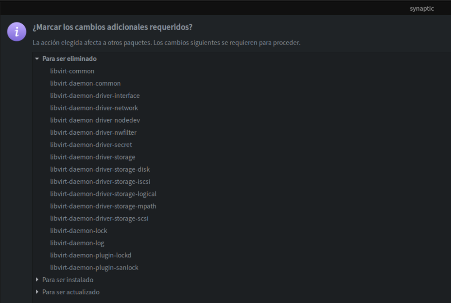

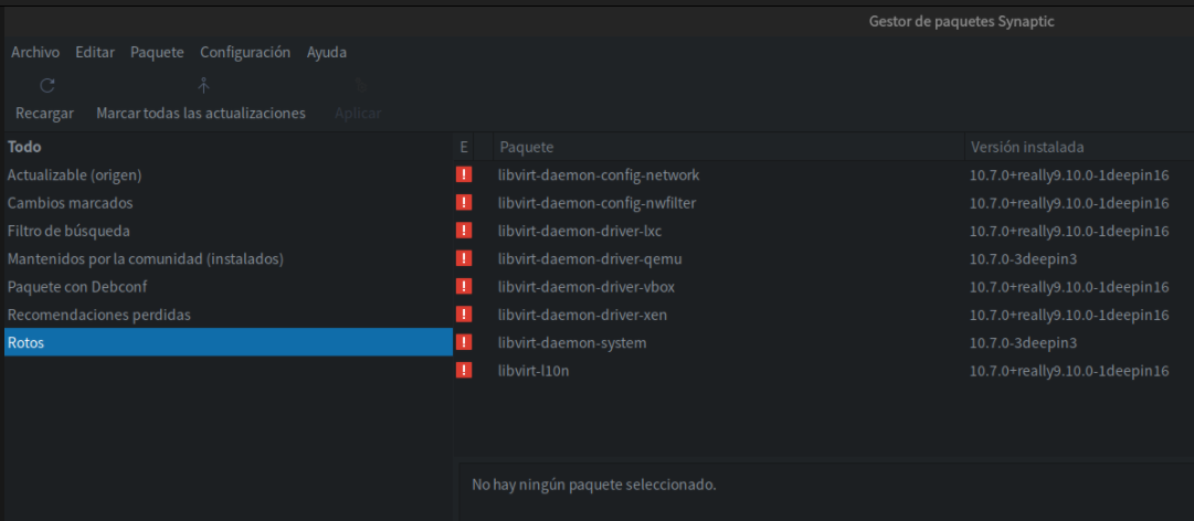

The update was downloaded from the control center and proceeded to update. The system created a backup, but an unexpected error (dependency error) occurred during the update process. A more detailed search with Synaptic revealed the following broken packages:
kernel_journal.ziplibvirt-daemon-config-network libvirt-daemon-config-nwfilter libvirt-daemon-driver-lxc libvirt-daemon-driver-qemu libvirt-daemon-driver-vbox libvirt-daemon-driver-xen libvirt-daemon-system libvirt-l10n

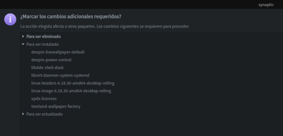

I was able to update after removing the conflicting packages from the virtual machine. Then I reinstalled them and luckily I was able to boot the virtual machine, but I can't configure facial recognition or fingerprint login, and the microphone doesn't work, which it did with older kernels.
