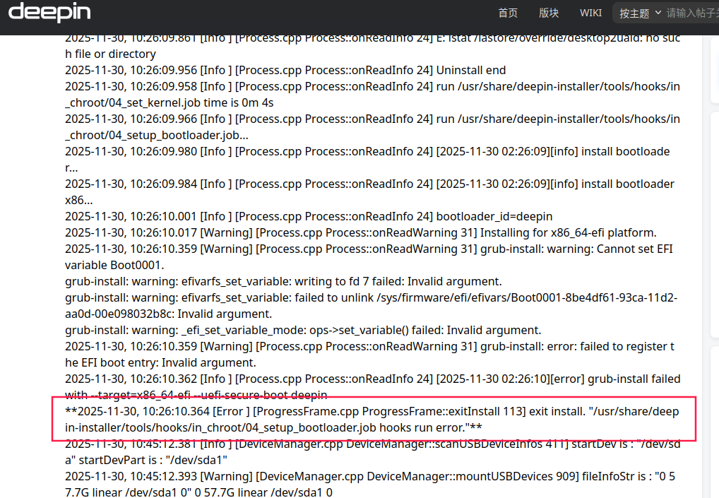

2025-11-30, 10:26:09.652 [Info ] [Process.cpp Process::onReadInfo 24] Purging configuration files for linux-image-6.6.93-amd64-desktop-hwe (25.01.00.03) ...
2025-11-30, 10:26:09.673 [Info ] [Process.cpp Process::onReadInfo 24] dpkg: warning: while removing linux-image-6.6.93-amd64-desktop-hwe, directory '/lib/modules/6.6.93-amd64-desktop-hwe' not empty so not removed
2025-11-30, 10:26:09.781 [Info ] [Process.cpp Process::onReadInfo 24] upgradable.go:178: stat /var/lib/lastore/SystemSource.d: no such file or directory
2025-11-30, 10:26:09.781 [Info ] [Process.cpp Process::onReadInfo 24] upgradable.go:178: stat /var/lib/lastore/SecuritySource.d: no such file or directory
upgradable.go:178: stat /var/lib/lastore/unknownSource.d: no such file or directory
2025-11-30, 10:26:09.861 [Info ] [Process.cpp Process::onReadInfo 24] E: lstat /lastore/override/desktop2uaid: no such file or directory
2025-11-30, 10:26:09.956 [Info ] [Process.cpp Process::onReadInfo 24] Uninstall end
2025-11-30, 10:26:09.958 [Info ] [Process.cpp Process::onReadInfo 24] run /usr/share/deepin-installer/tools/hooks/in_chroot/04_set_kernel.job time is 0m 4s
2025-11-30, 10:26:09.966 [Info ] [Process.cpp Process::onReadInfo 24] run /usr/share/deepin-installer/tools/hooks/in_chroot/04_setup_bootloader.job...
2025-11-30, 10:26:09.980 [Info ] [Process.cpp Process::onReadInfo 24] [2025-11-30 02:26:09][info] install bootloader...
2025-11-30, 10:26:09.984 [Info ] [Process.cpp Process::onReadInfo 24] [2025-11-30 02:26:09][info] install bootloader x86...
2025-11-30, 10:26:10.001 [Info ] [Process.cpp Process::onReadInfo 24] bootloader_id=deepin

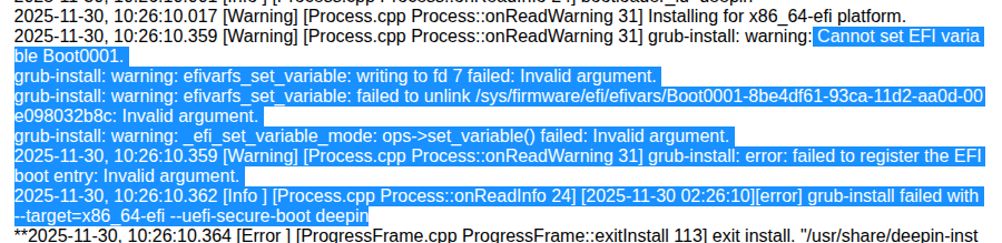

2025-11-30, 10:26:10.017 [Warning] [Process.cpp Process::onReadWarning 31] Installing for x86_64-efi platform.
2025-11-30, 10:26:10.359 [Warning] [Process.cpp Process::onReadWarning 31] grub-install: warning: Cannot set EFI variable Boot0001.
grub-install: warning: efivarfs_set_variable: writing to fd 7 failed: Invalid argument.
grub-install: warning: efivarfs_set_variable: failed to unlink /sys/firmware/efi/efivars/Boot0001-8be4df61-93ca-11d2-aa0d-00e098032b8c: Invalid argument.
grub-install: warning: _efi_set_variable_mode: ops->set_variable() failed: Invalid argument.
2025-11-30, 10:26:10.359 [Warning] [Process.cpp Process::onReadWarning 31] grub-install: error: failed to register the EFI boot entry: Invalid argument.
2025-11-30, 10:26:10.362 [Info ] [Process.cpp Process::onReadInfo 24] [2025-11-30 02:26:10][error] grub-install failed with --target=x86_64-efi --uefi-secure-boot deepin
**2025-11-30, 10:26:10.364 [Error ] [ProgressFrame.cpp ProgressFrame::exitInstall 113] exit install. "/usr/share/deepin-installer/tools/hooks/in_chroot/04_setup_bootloader.job hooks run error."**
2025-11-30, 10:45:12.381 [Info ] [DeviceManager.cpp DeviceManager::scanUSBDeviceInfos 411] startDev is : "/dev/sda" startDevPart is : "/dev/sda1"
2025-11-30, 10:45:12.393 [Warning] [DeviceManager.cpp DeviceManager::mountUSBDevices 909] fileInfoStr is : "0 57.7G linear /dev/sda1 0" 0 57.7G linear /dev/sda1 0
2025-11-30, 10:45:12.404 [Warning] [DeviceManager.cpp DeviceManager::mountUSBDevices 917] "device-mapper: reload ioctl on Ventoy1 (253:2) failed: Invalid argument\nCommand failed.\n"
2025-11-30, 10:45:13.416 [Info ] [DeviceManager.cpp DeviceManager::scanUSBDeviceInfos 411] startDev is : "/dev/sda" startDevPart is : "/dev/sda1"
2025-11-30, 10:45:13.426 [Warning] [DeviceManager.cpp DeviceManager::mountUSBDevices 909] fileInfoStr is : "0 57.7G linear /dev/sda1 0" 0 57.7G linear /dev/sda1 0
2025-11-30, 10:45:13.431 [Warning] [DeviceManager.cpp DeviceManager::mountUSBDevices 917] "device-mapper: reload ioctl on Ventoy1 (253:2) failed: Invalid argument\nCommand failed.\n"
2025-11-30, 10:45:14.453 [Info ] [DeviceManager.cpp DeviceManager::scanUSBDeviceInfos 411] startDev is : "/dev/sda" startDevPart is : "/dev/sda1"
2025-11-30, 10:45:14.468 [Warning] [DeviceManager.cpp DeviceManager::mountUSBDevices 909] fileInfoStr is : "0 57.7G linear /dev/sda1 0" 0 57.7G linear /dev/sda1 0
2025-11-30, 10:45:14.478 [Warning] [DeviceManager.cpp DeviceManager::mountUSBDevices 917] "device-mapper: reload ioctl on Ventoy1 (253:2) failed: Invalid argument\nCommand failed.\n"
2025-11-30, 10:45:15.497 [Info ] [DeviceManager.cpp DeviceManager::scanUSBDeviceInfos 411] startDev is : "" startDevPart is : ""
2025-11-30, 10:45:16.508 [Info ] [DeviceManager.cpp DeviceManager::scanUSBDeviceInfos 411] startDev is : "" startDevPart is : ""
2025-11-30, 10:45:17.520 [Info ] [DeviceManager.cpp DeviceManager::scanUSBDeviceInfos 411] startDev is : "" startDevPart is : ""
2025-11-30, 10:45:18.530 [Info ] [DeviceManager.cpp DeviceManager::scanUSBDeviceInfos 411] startDev is : "" startDevPart is : ""
2025-11-30, 10:45:19.539 [Info ] [DeviceManager.cpp DeviceManager::scanUSBDeviceInfos 411] startDev is : "" startDevPart is : ""
2025-11-30, 10:45:19.571 [Warning] [DeviceManager.cpp DeviceManager::mountUSBDevices 953] "Command: mount /dev/sdb1 /media/dev/sdb1 failed. mount: /media/dev/sdb1: unknown filesystem type 'exfat'.\n dmesg(1) may have more information after failed mount system call.\n"
2025-11-30, 10:45:19.604 [Info ] [CommonFunc.cpp CommonFunc::mount 1574] "Command: mount /dev/sdb2 /media/dev/sdb2 succeed."

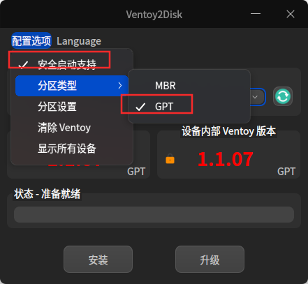

最关键的一环,安全启动有关么?
这几块都反应的是安全启动的问题导致的
Omar
2025-12-06 07:37
deepin流云:
最关键的一环,安全启动有关么?
这几块都反应的是安全启动的问题导致的
安全启动时关了的。
