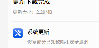

[Bug Report] 没有更新内容,却一直在推送大小为2MB左右的更新

[2025-11-06 13:05:40] {"progress":0,"description":"Starting backup process"}
[2025-11-06 13:05:55] {"progress":10,"description":"Merging modification directories"}
[2025-11-06 13:05:55] {"progress":30,"description":"Checking out system files"}
[2025-11-06 13:05:58] {"progress":50,"description":"Syncing system files"}
[2025-11-06 13:05:59] {"progress":70,"description":"Moving system files"}
[2025-11-06 13:06:00] {"progress":80,"description":"Committing"}
[2025-11-06 13:06:10] {"progress":10,"description":"Merging modification directories"}
[2025-11-06 13:06:10] {"progress":30,"description":"Checking out system files"}
[2025-11-06 13:06:11] {"progress":50,"description":"Syncing system files"}
[2025-11-06 13:06:37] {"progress":70,"description":"Moving system files"}
[2025-11-06 13:06:38] {"progress":80,"description":"Committing"}
[2025-11-06 13:07:20] {"progress":90,"description":"Checking out deploy directory"}
[2025-11-06 13:08:08] {"progress":100,"description":"Backup completed"}

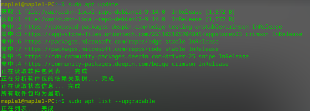

手动用命令检查下看看是什么包,sudo apt update,然后apt list --upgradable看是哪个包升级

deepin流云:

枫晓岳:
你这截图不全啊~
流云版主让你apt list --upgradable后,看要升级包列表......shamed

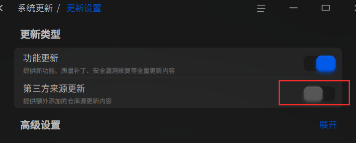

看你有两个三方源,更新设置里面这个开了么?如果开了把它关掉再控制中心检查更新试试

kookboy:
你这截图不全啊~
嗯,可以了,上面就已经看出来命令检查没有包升级,跟上次我们有个包冲突的bug不一样,而且这个问题已经修好了。如果有包升级这儿会显示数量,我只是想看看具体是哪个包出的升级问题

kookboy:
你这截图不全啊~
没有列表,就是这么长

deepin流云:
关第三方源无效要关功能更新才没有提示
