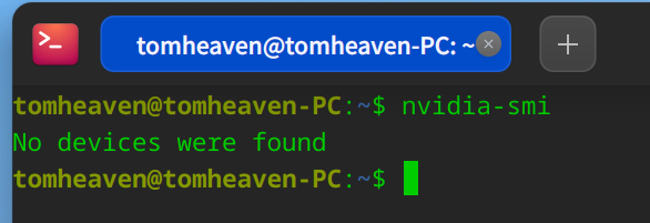

  1. 通过测试源安装驱动,当前版本为580.82.07-0deepin,结果无法驱动笔记本5060显卡(经测试也无法驱动5070Ti)
# 删除已有Nvidia驱动
sudo apt remove *nvidia*
# 更新源
echo 'deb [trusted=yes] https://ci.deepin.com/repo/obs/deepin:/CI:/TestingIntegration:/test-integration-pr-3132:/nvidia-graphics-driver/testing/ ./' | sudo tee -a /etc/apt/sources.list > /dev/null
sudo apt update
# 安装测试驱动
sudo apt install nvidia-driver
安装后运行nvidia-smi无法找到设备:
