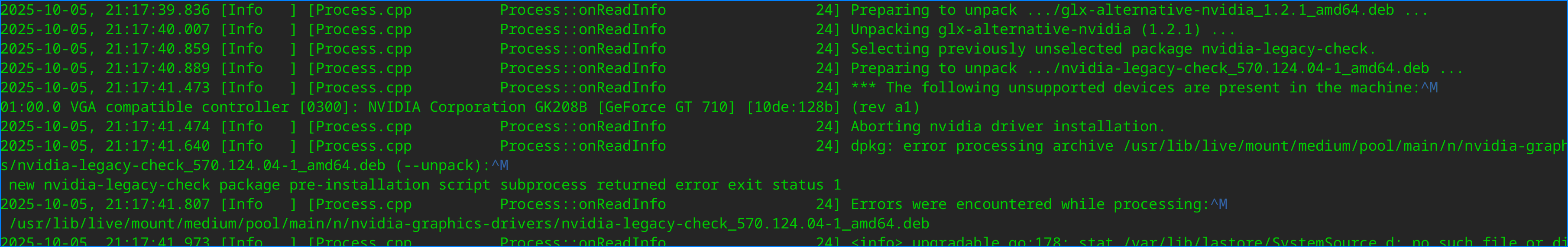

安装多次v25版本 进度条快完成时就弹窗安装失败,换了V23一次就可以了,我不知道怎么上传日志的

2025-10-05, 21:17:41.474 [Info   ] [Process.cpp          Process::onReadInfo                 24] Aborting nvidia driver installation.
2025-10-05, 21:17:41.640 [Info   ] [Process.cpp          Process::onReadInfo                 24] dpkg: error processing archive /usr/lib/live/mount/medium/pool/main/n/nvidia-graphics-drivers/nvidia-legacy-check_570.124.04-1_amd64.deb (--unpack):
 new nvidia-legacy-check package pre-installation script subprocess returned error exit status 1
2025-10-05, 21:17:41.807 [Info   ] [Process.cpp          Process::onReadInfo                 24] Errors were encountered while processing:
2025-10-05, 21:17:41.973 [Info   ] [Process.cpp          Process::onReadInfo                 24]  upgradable.go:178: stat /var/lib/lastore/SystemSource.d: no such file or directory
2025-10-05, 21:17:41.974 [Info   ] [Process.cpp          Process::onReadInfo                 24]  upgradable.go:178: stat /var/lib/lastore/SecuritySource.d: no such file or directory
2025-10-05, 21:17:41.974 [Info   ] [Process.cpp          Process::onReadInfo                 24]  upgradable.go:178: stat /var/lib/lastore/unknownSource.d: no such file or directory
2025-10-05, 21:17:42.213 [Info   ] [Process.cpp          Process::onReadInfo                 24] E: lstat /lastore/override/desktop2uaid: no such file or directory
2025-10-05, 21:17:42.655 [Warning] [Process.cpp          Process::onReadWarning              31] E: Sub-process /usr/bin/dpkg returned an error code (1)
2025-10-05, 21:17:42.658 [Info   ] [Process.cpp          Process::onReadInfo                 24] [2025-10-05 13:17:42][error] Install Failed : nvidia-driver
2025-10-05, 21:17:42.660 [Error  ] [ProgressFrame.cpp    ProgressFrame::exitInstall          113] exit install. "/usr/share/deepin-installer/tools/hooks/in_chroot/08_setup_system_package.job hooks run error."

安装的时候,应该有个安装显卡驱动的选项。你不要勾这个选项。而是安装好系统后,进系统里安装。不要在安装系统的时候安装显卡驱动。

GT 710太老了,新版本的驱动不提供支持了
