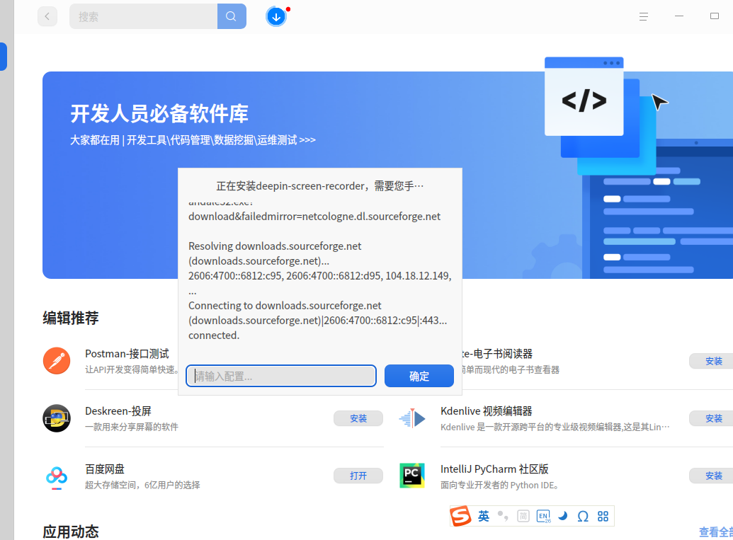

[Freezing/Lagging] deepin 25.0.7 应用商店更新截图工具出现问题
Leon
2025-09-21 14:48
Reading package lists...
Building dependency tree...
Reading state information...
The following packages were automatically installed and are no longer required:
coinor-libcbc3 coinor-libcgl1 coinor-libclp1 coinor-libcoinmp1v5
coinor-libcoinutils3v5 coinor-libosi1v5 deepin-default-settings-tuning
deepin-wallpapers fonts-opensymbol inxi jfsutils libabw-0.1-1 libargon2-1
libboost-locale1.83.0 libbox2d2 libcdr-0.1-1 libclucene-contribs1v5
libclucene-core1v5 libcmis-0.6-6 libcolamd3 libdtkdeclarative5
libe-book-0.1-1 libeot0 libepubgen-0.1-1 libetonyek-0.1-1
libexttextcat-2.0-0 libexttextcat-data libfreehand-0.1-1 liblangtag-common
liblangtag1 libmhash2 libmspub-0.1-1 libmwaw-0.3-3 libmythes-1.2-0
libnumbertext-1.0-0 libnumbertext-data libodfgen-0.1-1 liborcus-0.18-0
liborcus-parser-0.18-0 libpagemaker-0.0-0 libqt5quickcontrols2-5
libqt5quicktemplates2-5 libqtermwidget6-2 libqxp-0.0-0 librasqal3 librdf0
librevenge-0.0-0 libssh-gcrypt-4 libstaroffice-0.0-0 libsuitesparseconfig7
libuno-cppu3 libuno-cppuhelpergcc3-3 libuno-purpenvhelpergcc3-3 libuno-sal3
libuno-salhelpergcc3-3 libutf8proc3 libvisio-0.1-1 libwpd-0.10-10
libwpg-0.3-3 libwps-0.4-4 libxmlsec1-nss libzmf-0.0-0 libzxcvbn0 lp-solve
qdbus-qt6 qml-module-qt-labs-folderlistmodel qml-module-qt-labs-settings
qml-module-qtgraphicaleffects qml-module-qtqml qml-module-qtqml-models2
qml-module-qtquick-controls qml-module-qtquick-controls2
qml-module-qtquick-dialogs qml-module-qtquick-layouts
qml-module-qtquick-privatewidgets qml-module-qtquick-templates2
qml-module-qtquick-window2 qtermwidget-data ttf-mscorefonts-installer
uno-libs-private uos-license-content ure
Use 'apt autoremove' to remove them.
Recommended packages:
uos-reporter deepin-event-log
The following packages will be upgraded:
deepin-screen-recorder
1 upgraded, 0 newly installed, 0 to remove and 0 not upgraded.
3 not fully installed or removed.
Need to get 0 B/35.7 MB of archives.
After this operation, 108 kB of additional disk space will be used.
(Reading database ... 325876 files and directories currently installed.)
Preparing to unpack .../deepin-screen-recorder_6.6.4_amd64.deb ...
Progress: [ 0%]
Progress: [ 9%]
Unpacking deepin-screen-recorder (6.6.4) over (6.6.3) ...
Progress: [ 15%]
Setting up deepin-screen-recorder (6.6.4) ...
Progress: [ 23%]
Setting up ttf-mscorefonts-installer (3.8) ...
Progress: [ 31%]
These fonts were provided by Microsoft "in the interest of cross-
platform compatibility". This is no longer the case, but they are
still available from third parties.
You are free to download these fonts and use them for your own use,
but you may not redistribute them in modified form, including changes
to the file name or packaging format.
--2025-09-21 14:33:44-- https://downloads.sourceforge.net/corefonts/andale32.exe
Resolving downloads.sourceforge.net (downloads.sourceforge.net)...
2606:4700::6812:c95, 2606:4700::6812:d95, 104.18.12.149, ...
Connecting to downloads.sourceforge.net (downloads.sourceforge.net)|2606:4700::6812:c95|:443...
connected.
GnuTLS: Error in the pull function.
Unable to establish SSL connection.
--2025-09-21 14:34:13-- https://jaist.dl.sourceforge.net/sourceforge/corefonts/andale32.exe
Resolving jaist.dl.sourceforge.net (jaist.dl.sourceforge.net)...
2001:df0:2ed:feed::feed, 150.65.7.130
Connecting to jaist.dl.sourceforge.net (jaist.dl.sourceforge.net)|2001:df0:2ed:feed::feed|:443...
connected.
HTTP request sent, awaiting response...
302 Found
Location: https://downloads.sourceforge.net/sourceforge/corefonts/andale32.exe?download&failedmirror=jaist.dl.sourceforge.net [following]
--2025-09-21 14:34:14-- https://downloads.sourceforge.net/sourceforge/corefonts/andale32.exe?download&failedmirror=jaist.dl.sourceforge.net
connected.
--2025-09-21 14:35:34-- https://nchc.dl.sourceforge.net/sourceforge/corefonts/andale32.exe
Resolving nchc.dl.sourceforge.net (nchc.dl.sourceforge.net)...
2001:e10:ffff:1f02::17, 140.110.96.69
Connecting to nchc.dl.sourceforge.net (nchc.dl.sourceforge.net)|2001:e10:ffff:1f02::17|:443...
connected.
302 Found
Location: https://downloads.sourceforge.net/sourceforge/corefonts/andale32.exe?download&failedmirror=nchc.dl.sourceforge.net [following]
--2025-09-21 14:35:35-- https://downloads.sourceforge.net/sourceforge/corefonts/andale32.exe?download&failedmirror=nchc.dl.sourceforge.net
connected.
--2025-09-21 14:40:42-- https://ufpr.dl.sourceforge.net/sourceforge/corefonts/andale32.exe
Resolving ufpr.dl.sourceforge.net (ufpr.dl.sourceforge.net)...
200.17.212.49
Connecting to ufpr.dl.sourceforge.net (ufpr.dl.sourceforge.net)|200.17.212.49|:443...
failed: Connection timed out.
Giving up.
--2025-09-21 14:41:43-- https://internode.dl.sourceforge.net/sourceforge/corefonts/andale32.exe
Resolving internode.dl.sourceforge.net (internode.dl.sourceforge.net)...
150.101.135.12
Connecting to internode.dl.sourceforge.net (internode.dl.sourceforge.net)|150.101.135.12|:443...
Giving up.
--2025-09-21 14:42:43-- https://netcologne.dl.sourceforge.net/sourceforge/corefonts/andale32.exe
Resolving netcologne.dl.sourceforge.net (netcologne.dl.sourceforge.net)...
2001:4dd0:200:113::5f, 78.35.24.122
Connecting to netcologne.dl.sourceforge.net (netcologne.dl.sourceforge.net)|2001:4dd0:200:113::5f|:443...
connected.
302 Moved Temporarily
Location: https://downloads.sourceforge.net/sourceforge/corefonts/andale32.exe?download&failedmirror=netcologne.dl.sourceforge.net [following]
--2025-09-21 14:42:44-- https://downloads.sourceforge.net/sourceforge/corefonts/andale32.exe?download&failedmirror=netcologne.dl.sourceforge.net
connected.
--2025-09-21 14:47:47-- https://vorboss.dl.sourceforge.net/sourceforge/corefonts/andale32.exe
Resolving vorboss.dl.sourceforge.net (vorboss.dl.sourceforge.net)...
failed: Name or service not known.
wget: unable to resolve host address ‘vorboss.dl.sourceforge.net’
--2025-09-21 14:47:47-- https://netix.dl.sourceforge.net/sourceforge/corefonts/andale32.exe
Resolving netix.dl.sourceforge.net (netix.dl.sourceforge.net)...
87.121.121.2
Connecting to netix.dl.sourceforge.net (netix.dl.sourceforge.net)|87.121.121.2|:443...
connected.
301 Moved Permanently
Location: https://downloads.sourceforge.net/sourceforge/corefonts/andale32.exe [following]
--2025-09-21 14:47:50-- https://downloads.sourceforge.net/sourceforge/corefonts/andale32.exe
connected.
2025-09-22 09:38
终端命令看下你的源:cat /etc/apt/sources.list
看起来你源里有个无法访问的sourceforge.net,一直无法连接导致超时了,把这个源屏蔽了再试试
