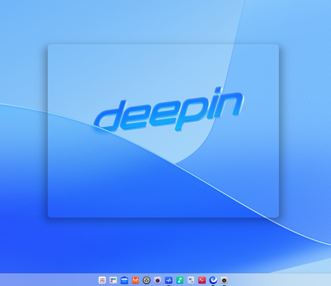

我的神舟笔记本装了Deepin v25一个多星期,今天想着打开相机应用看看摄像头能否正常 使用,结果太诡异了,只有一块透明的边框。卸载后更新了下系统,再重装也是同样问题。不知道是何原因~😥
Deepin v25.07版本

我晕~现在连控制中心也启动不了。。。

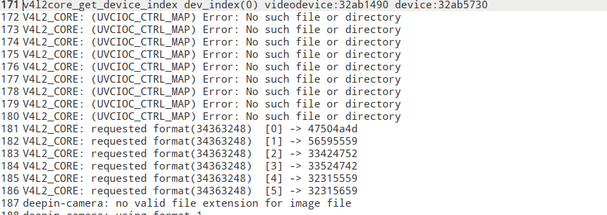

使用 ll-cli run org.deepin.camera看看有没有报错
kookboy
2025-09-17 18:42
会飞的鱼11:
我截取了三段:
2025-09-17, 18:39:03.320 [Warning] [ ] No low performance boards configuration found in "/usr/share/deepin-camera/camera.conf"
2025-09-17, 18:39:03.588 [Warning] [ ] Unsupported file format: ""
v4l2core_get_device_index dev_index(0) videodevice:77552620 device:775564e0
V4L2_CORE: (UVCIOC_CTRL_MAP) Error: No such file or directory
V4L2_CORE: requested format(34363248) [0] -> 47504a4d
V4L2_CORE: requested format(34363248) [1] -> 56595559
V4L2_CORE: requested format(34363248) [2] -> 33424752
V4L2_CORE: requested format(34363248) [3] -> 33524742
V4L2_CORE: requested format(34363248) [4] -> 32315559
V4L2_CORE: requested format(34363248) [5] -> 32315659
deepin-camera: no valid file extension for image file
deepin-camera: using format 1
2025-09-17, 18:39:04.089 [Warning] [ ] QPixmap::scaled: Pixmap is a null pixmap
Error: CODE=-1
./libs/linglong/src/linglong/runtime/container.cpp:272 run container a2cf8d6442b87a009468df12ddcad3dde8f17cee0e534399cefe9f16a8743317: cli run: run command failed: /usr/bin/ll-box --cgroup-manager=disabled run -b /run/user/1000/linglong/a2cf8d6442b87a009468df12ddcad3dde8f17cee0e534399cefe9f16a8743317 a2cf8d6442b87a009468df12ddcad3dde8f17cee0e534399cefe9f16a8743317 retval=2
kookboy
2025-09-17 18:52
run org.deepin.camera.txt
运行日志我保存在此文本文件中了。
