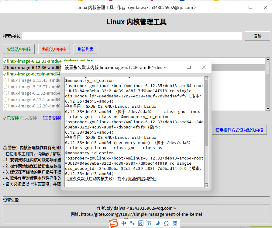

UOS小白:
原来内核是6.12.36,使用软件修改失败,提示找不到内核,然后重启电脑改到6.15.3内核,再用软件去设置,仍然提示找不到,是需要先做什么更改吗?
输入密码那个弹框就是查找启动参数的命令
wcs4221
2025-08-02 13:50
#22
多系统:试三项-设启动内核均是找不到....
相信会好smirk
鲜衣怒马
2025-08-02 16:14
#23
wcs4221:
相信会好smirk
我现在没有dp设备 执行下 sudo cat /boot/grub/grub.cfg 发一下呢 我适配下,我现在按照ubuntu解析的 可以设置,可能跟dp有区别

wcs4221
2025-08-02 21:02
#25
鲜衣怒马:
wcs@wcs-PC:~$ sudo cat /boot/grub/grub.cfg
请输入密码:
验证成功

menuentry '深度操作系统 25 社区版, Linux 6.12.33-amd64-desktop-rolling (2025/07/28 11:16:20)' --class gnu-linux --class gnu --class os {
load_video
set gfxpayload=keep
insmod gzio
insmod part_gpt
insmod ext2
set root='hd0,gpt5'
if [ x$feature_platform_search_hint = xy ]; then search --no-floppy --fs-uuid --set=root 086215ca-f225-4b21-a3e7-d34a3b51a4d8
fi
linux /boot/immutable/e0c8d87c7e9220c892ebb6eb7faa092aab2b2586cfb10f035eed052fa8639d9b.0/vmlinuz-6.12.33-amd64-desktop-rolling root=UUID=086215ca-f225-4b21-a3e7-d34a3b51a4d8 ostree=auto video=efifb:nobgrt splash quiet loglevel=0 locales=zh_CN.UTF-8 DEEPIN_GFXMODE=$DEEPIN_GFXMODE efi-pstore.pstore_disable=N luks.crypttab=n
initrd /boot/immutable/e0c8d87c7e9220c892ebb6eb7faa092aab2b2586cfb10f035eed052fa8639d9b.0/initrd.img-6.12.33-amd64-desktop-rolling
END /etc/grub.d/15_immutable
BEGIN /etc/grub.d/20_linux_xen
END /etc/grub.d/20_linux_xen
BEGIN /etc/grub.d/25_bli
if [ "$grub_platform" = "efi" ]; then
insmod bli
fi
END /etc/grub.d/25_bli
BEGIN /etc/grub.d/30_os-prober
menuentry 'Windows Boot Manager (位于 /dev/sda1)' --class windows --class os $menuentry_id_option 'osprober-efi-476E-6AAE' {
insmod part_gpt
insmod fat
set root='hd0,gpt1'
if [ x$feature_platform_search_hint = xy ]; then search --no-floppy --fs-uuid --set=root 476E-6AAE
fi
chainloader /EFI/Microsoft/Boot/bootmgfw.efi
menuentry 'GXDE OS 25 (位于 /dev/sda6)' --class gxde --class gnu-linux --class gnu --class os $menuentry_id_option 'osprober-gnulinux-simple-84ed8eba-32c2-4c39-a88f-7d9bad14f9f9' {
insmod part_gpt
insmod ext2
set root='hd0,gpt6'
if [ x$feature_platform_search_hint = xy ]; then search --no-floppy --fs-uuid --set=root 84ed8eba-32c2-4c39-a88f-7d9bad14f9f9
fi
linux /boot/vmlinuz-6.12.38+deb13-amd64 root=UUID=84ed8eba-32c2-4c39-a88f-7d9bad14f9f9 ro quiet splash DEEPIN_GFXMODE=$DEEPIN_GFXMODE
initrd /boot/initrd.img-6.12.38+deb13-amd64
submenu 'GXDE OS 25 (位于 /dev/sda6) 的高级选项' $menuentry_id_option 'osprober-gnulinux-advanced-84ed8eba-32c2-4c39-a88f-7d9bad14f9f9' {
menuentry 'GXDE OS GNU/Linux (位于 /dev/sda6)' --class gnu-linux --class gnu --class os $menuentry_id_option 'osprober-gnulinux-/boot/vmlinuz-6.12.38+deb13-amd64--84ed8eba-32c2-4c39-a88f-7d9bad14f9f9' {
insmod part_gpt
insmod ext2
set root='hd0,gpt6'
fi
menuentry 'GXDE OS GNU/Linux, with Linux 6.12.38+deb13-amd64 (位于 /dev/sda6)' --class gnu-linux --class gnu --class os $menuentry_id_option 'osprober-gnulinux-/boot/vmlinuz-6.12.38+deb13-amd64--84ed8eba-32c2-4c39-a88f-7d9bad14f9f9' {
insmod part_gpt
insmod ext2
set root='hd0,gpt6'
fi
menuentry 'GXDE OS GNU/Linux, with Linux 6.12.38+deb13-amd64 (recovery mode) (位于 /dev/sda6)' --class gnu-linux --class gnu --class os $menuentry_id_option 'osprober-gnulinux-/boot/vmlinuz-6.12.38+deb13-amd64-root=UUID=84ed8eba-32c2-4c39-a88f-7d9bad14f9f9 ro single dis_ucode_ldr-84ed8eba-32c2-4c39-a88f-7d9bad14f9f9' {
insmod part_gpt
insmod ext2
set root='hd0,gpt6'
fi
linux /boot/vmlinuz-6.12.38+deb13-amd64 root=UUID=84ed8eba-32c2-4c39-a88f-7d9bad14f9f9 ro single dis_ucode_ldr

wcs4221
2025-08-03 11:50
#29
鲜衣怒马:
joy
没人吗,来两个其他发行版的测试下哇!
刚在gxde25.1--上:推荐方式设为启动内核---okjoy
另外二种模式试了,也是ok!
不过认证均要2-3次方可!
***这说明199版,在gxde25.1上是适配地!!!!
wcs4221
2025-08-03 12:05
#30

wcs4221
2025-08-03 15:10
#32
鲜衣怒马:
是指启动也是按照设置启动的吗?
如果测试了重启,也是OK的 那就是OK了,如果只测试了设置没测试重启,表示只找到了,设置效果还待定
指定的设置项:重启后查有误---没有实际加载?
设置时:ok
鲜衣怒马
2025-08-03 15:59
#33
wcs4221:
设置时:ok
其实是设置失败了没识别到,不然应该以设置的内核启动,ubuntu可以按照设置的内核启动,其他不行 待修复

wcs4221
2025-08-05 05:28
#35
mint22.1上同样的情况,可设但无法实现?
鲜衣怒马
2025-08-05 08:25
#36
wcs4221:
是的,我昨晚修复了一下,还没测试
