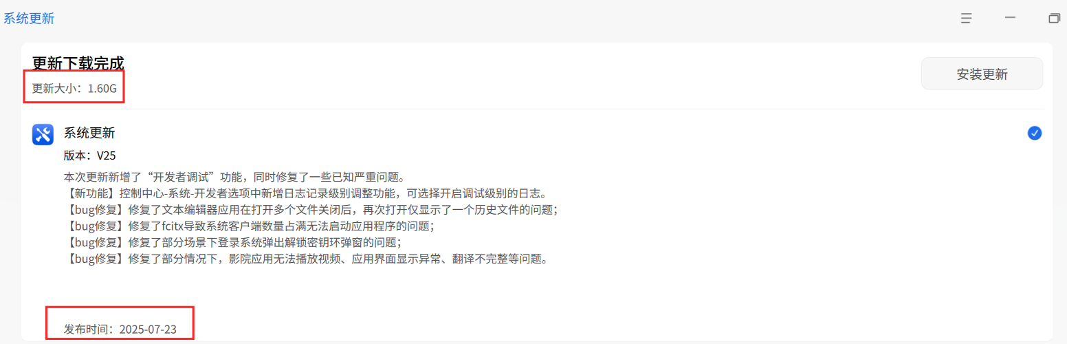

关于 2025年7月23日 deepin 25 更新公告https://bbs.deepin.org/post/289710 中,有版主提到要修正这个更新,已解决更新失败的问题,关于这个更新的修正更新什么时候推出啊,一直等着呢😂
今天看,推出的更新还是7月23日,问问新的更新什么时候推送?还有就是看到很多贴图是 1.56G的更新,而我的是1.60G,有点差异。

a-bird
2025-07-28 11:31
刚发公告了,你再看一看
2025-07-28 11:32
更新失败的报错是什么呢?用命令可以更新吗?(如果是提示备份失败,建议清理下boot分区空间再试试)
sudo apt update&&sudo apt dist-upgrade
另外23号的后续问题修复版本今天已推出:https://bbs.deepin.org.cn/post/289995

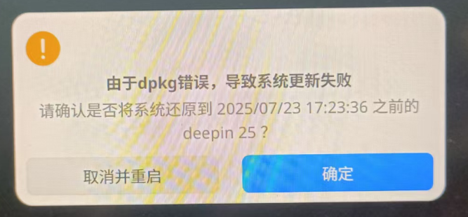

错误日志在 7月23日公告中刚发过,报错提示是:
不管是后台静默更新,还是重启更新,最后都是回退。
一会去试试今天的更新包
electricface
2025-07-29 10:23
/yb 江枫 ,你遇到的报错是:
[2025-07-28 17:06:13] Setting up spark-wine10-ace (10.12-spark-3) ...
[2025-07-28 17:06:13] Update the flamescion container tools
[2025-07-28 17:06:13] bwrap: execvp bash: No such file or directory
[2025-07-28 17:06:13] bwrap: execvp cp: No such file or directory
[2025-07-28 17:06:13] bwrap: execvp touch: No such file or directory
[2025-07-28 17:06:13] bwrap: execvp apt: No such file or directory
[2025-07-28 17:06:13] bwrap: execvp chown: No such file or directory
[2025-07-28 17:06:13] bwrap: Can't mkdir parents for /usr/local/share/themes: Permission denied
[2025-07-28 17:06:13] bwrap: execvp update-locale: No such file or directory
[2025-07-28 17:06:13] [ERROR]: 无法获取 NVIDIA 驱动版本 Can not determine NVIDIA Driver version
[2025-07-28 17:06:14] bwrap: execvp bash: No such file or directory
[2025-07-28 17:06:14] bwrap: execvp cp: No such file or directory
[2025-07-28 17:06:14] bwrap: execvp touch: No such file or directory
[2025-07-28 17:06:14] bwrap: execvp apt: No such file or directory
[2025-07-28 17:06:14] bwrap: execvp chown: No such file or directory
[2025-07-28 17:06:14] bwrap: Can't mkdir parents for /usr/local/share/themes: Permission denied
[2025-07-28 17:06:14] bwrap: execvp update-locale: No such file or directory
[2025-07-28 17:06:14] sudo: unknown user DBUS_SESSION_BUS_ADDRESS=unix:path=/run/user/0/bus
[2025-07-28 17:06:14] sudo: error initializing audit plugin sudoers_audit
[2025-07-28 17:06:14] Update the flamescion container tools
[2025-07-28 17:06:14] [ERROR]: 无法获取 NVIDIA 驱动版本 Can not determine NVIDIA Driver version
[2025-07-28 17:06:15] Update the flamescion container tools
[2025-07-28 17:06:15] bwrap: execvp bash: No such file or directory
[2025-07-28 17:06:15] bwrap: execvp cp: No such file or directory
[2025-07-28 17:06:15] bwrap: execvp touch: No such file or directory
[2025-07-28 17:06:15] bwrap: execvp apt: No such file or directory
[2025-07-28 17:06:15] bwrap: execvp chown: No such file or directory
[2025-07-28 17:06:15] bwrap: Can't mkdir parents for /usr/local/share/themes: Permission denied
[2025-07-28 17:06:15] bwrap: execvp update-locale: No such file or directory
[2025-07-28 17:06:15] [ERROR]: 无法获取 NVIDIA 驱动版本 Can not determine NVIDIA Driver version
[2025-07-28 17:06:15] dpkg: error processing package spark-wine10-ace (--configure):
[2025-07-28 17:06:15] installed spark-wine10-ace package post-installation script subprocess returned error exit status 1
[2025-07-28 17:06:15] dpkg: dependency problems prevent configuration of spark-wine:
[2025-07-28 17:06:15] spark-wine depends on spark-wine10; however:
[2025-07-28 17:06:15] Package spark-wine10 is not installed.
[2025-07-28 17:06:15] Package spark-wine10-ace which provides spark-wine10 is not configured yet.
[2025-07-28 17:06:15] dpkg: error processing package spark-wine (--configure):
[2025-07-28 17:06:15] dependency problems - leaving unconfigured
[2025-07-28 17:06:15] dpkg: dependency problems prevent configuration of spark-wine7-devel:
[2025-07-28 17:06:15] spark-wine7-devel depends on spark-wine | spark-wine-bcm | spark-wine-dcm; however:
[2025-07-28 17:06:15] Package spark-wine is not configured yet.
[2025-07-28 17:06:15] Package spark-wine-bcm is not installed.
[2025-07-28 17:06:15] Package spark-wine-dcm is not installed.
[2025-07-28 17:06:15] dpkg: error processing package spark-wine7-devel (--configure):
[2025-07-28 17:06:15] Errors were encountered while processing:
[2025-07-28 17:06:15] spark-wine10-ace
[2025-07-28 17:06:16] Running external script: '/var/lib/lastore/scripts/build_system_info || true '
[2025-07-28 17:06:16] E: Sub-process /usr/bin/dpkg returned an error code (1)
[2025-07-28 17:06:16] === Job dist_upgrade end: apt-get -y -o APT::Status-Fd=3 -c /var/lib/lastore/apt_v2_common.conf --allow-downgrades --allow-change-held-packages dist-upgrade -o Dir::Etc::SourceList=/dev/null -o Dir::Etc::SourceParts=/var/lib/lastore/SystemSource.d [Status: FAILED] ===
应该是 spark-wine10-ace spark-wine spark-wine7-devel 这些包代码执行出错了。
能看出故障,但我不会解决!😁

这个是7月23日更新失败的日志,更新日志_2025_07_23_17.47.11.txt 。
另外,7月28日更新失败的日志,更新日志_2025_07_28_17.06.54.txt 。
总之,系统推送更新没有更新成功,后来通过命令:sudo apt update&&sudo apt dist-upgrade ,更新成功了。
