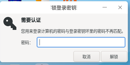

修复了部分场景下登录系统弹出解锁密钥环弹窗的问题;

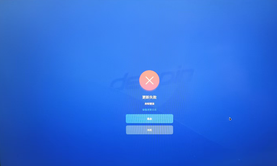

#26
更新失败,磐石系统关闭和开启的情况下,都试了,都是失败。
更新日志_2025_07_23_17.47.11.txt

#28
/yb 江枫:
好像是依赖问题
[2025-07-23 17:40:10] bwrap: execvp bash: No such file or directory
[2025-07-23 17:40:10] dpkg: error processing package spark-wine10-ace (--configure):
[2025-07-23 17:40:10] installed spark-wine10-ace package post-installation script subprocess returned error exit status 1
[2025-07-23 17:40:10] Setting up dbus-user-session (1.14.10-3-1deepin3) ...
[2025-07-23 17:40:10] dpkg: dependency problems prevent configuration of spark-wine:
[2025-07-23 17:40:10] spark-wine depends on spark-wine10; however:
[2025-07-23 17:40:10] Package spark-wine10 is not installed.
[2025-07-23 17:40:10] Package spark-wine10-ace which provides spark-wine10 is not configured yet.
[2025-07-23 17:40:10] dpkg: error processing package spark-wine (--configure):
[2025-07-23 17:40:10] dependency problems - leaving unconfigured
/yb 江枫

/yb 江枫:
又要重装系统了吗😂
不用啊,把这个包卸了再重新升级一次

顺利更新,这个烦人的登录密钥环看好像是关掉了,这家伙带来的副作用有edge等浏览器无法使用,现在可以用了,后边再观察几天。
