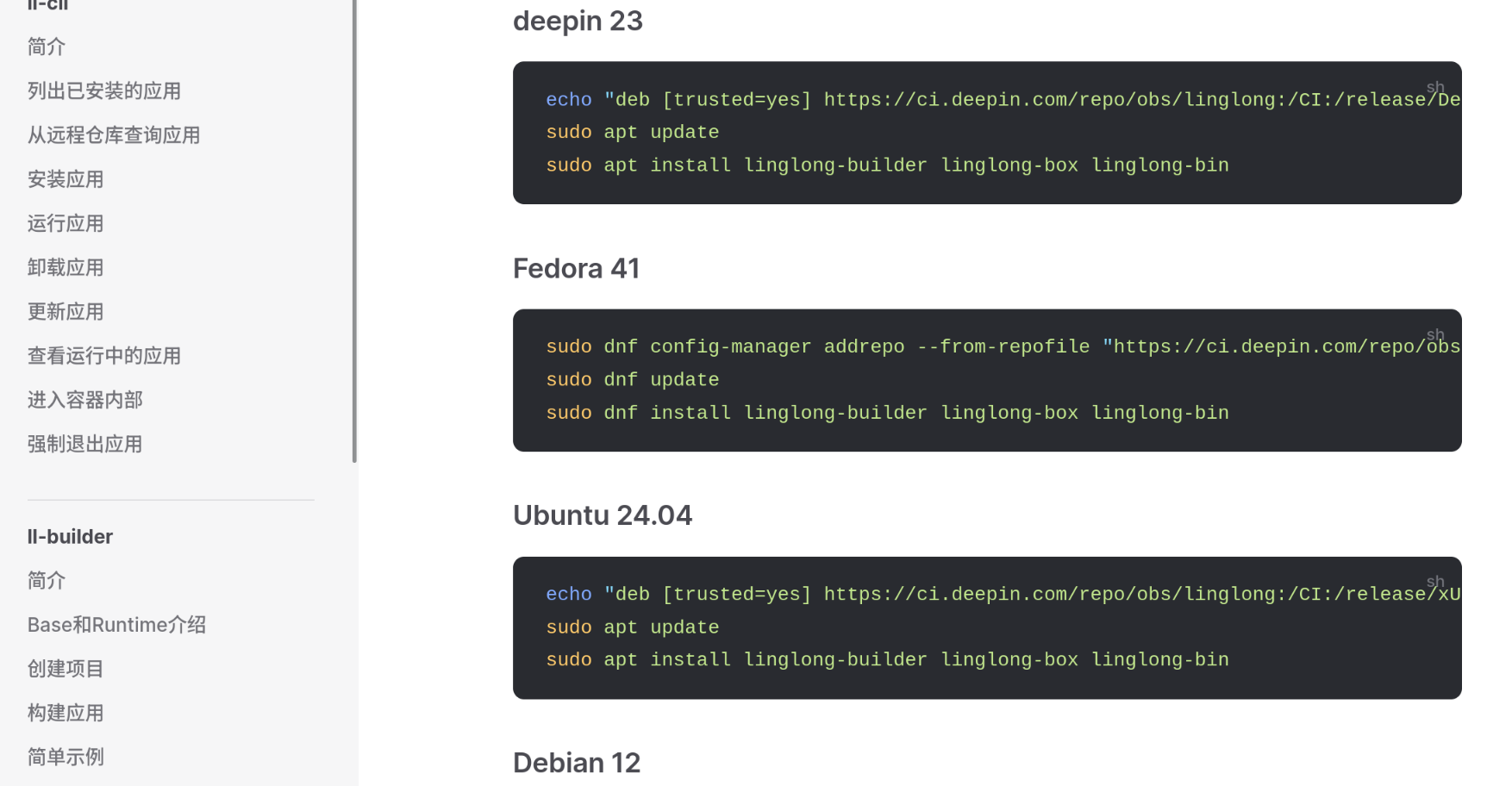

我参考如意玲珑官网中的信息在 Fedora 42 的系统上配置如意玲珑的环境
网址:https://linyaps.org.cn/guide/start/install.html#%E4%BB%93%E5%BA%93%E4%BD%BF%E7%94%A8%E8%AF%B4%E6%98%8E
参考内容
使用的命令
说明:将41修改为了42

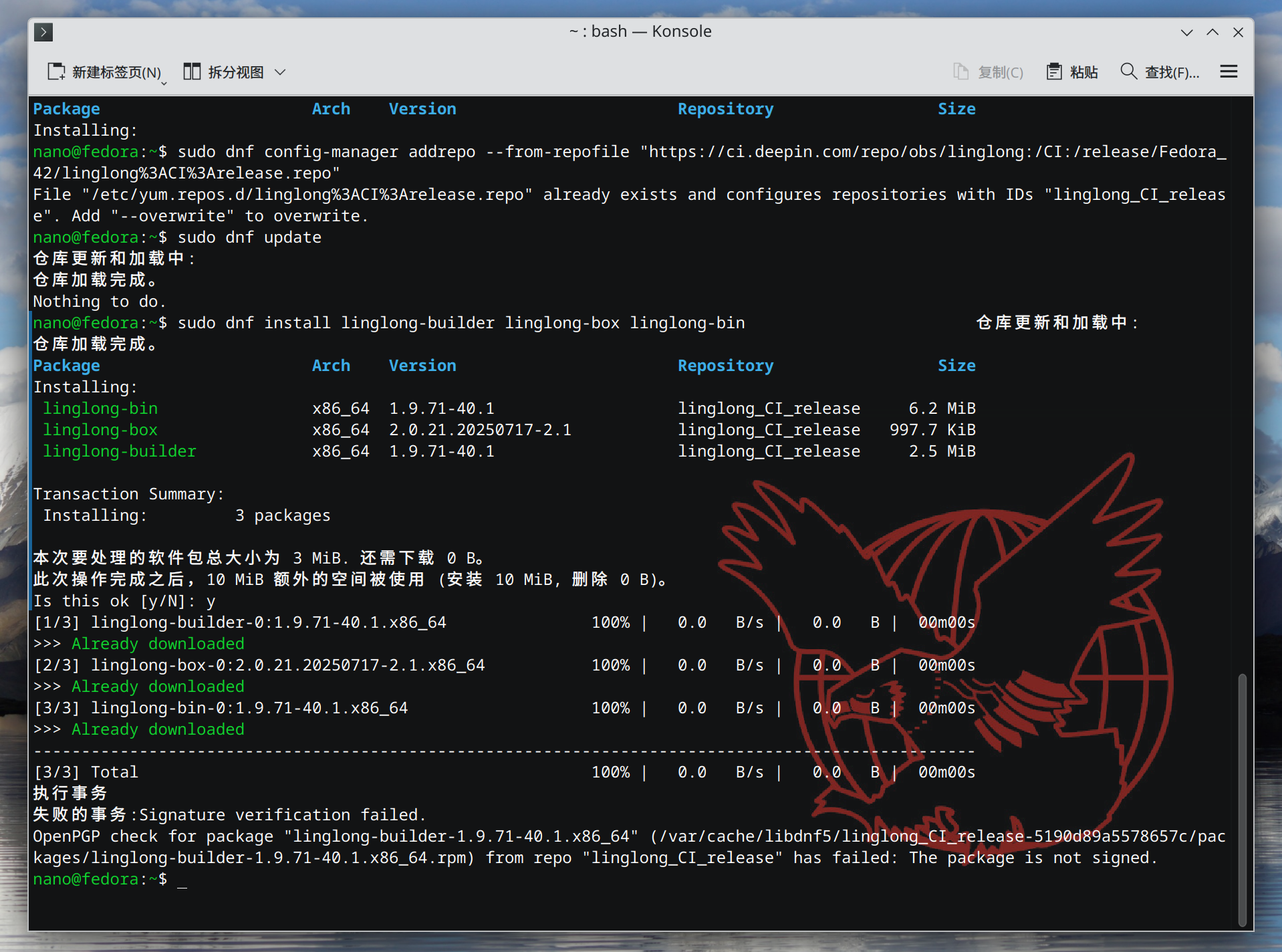

sudo dnf config-manager addrepo --from-repofile "https://ci.deepin.com/repo/obs/linglong:/CI:/release/Fedora_42/linglong%3ACI%3Arelease.repo"
sudo dnf update
sudo dnf install linglong-builder linglong-box linglong-bin
结果安装时提示没有签名
报错信息:
OpenPGP check for package "linglong-builder-1.9.71-40.1.x86_64" (/var/cache/libdnf5/linglong_CI_release-5190d89a5578657c/packages/linglong-builder-1.9.71-40.1.x86_64.rpm) from repo "linglong_CI_release" has failed: The package is not signed.
请问应该怎样才能在 Fedora 42 上安装如意玲珑的环境呢?

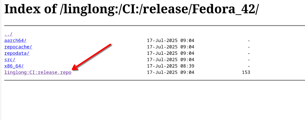

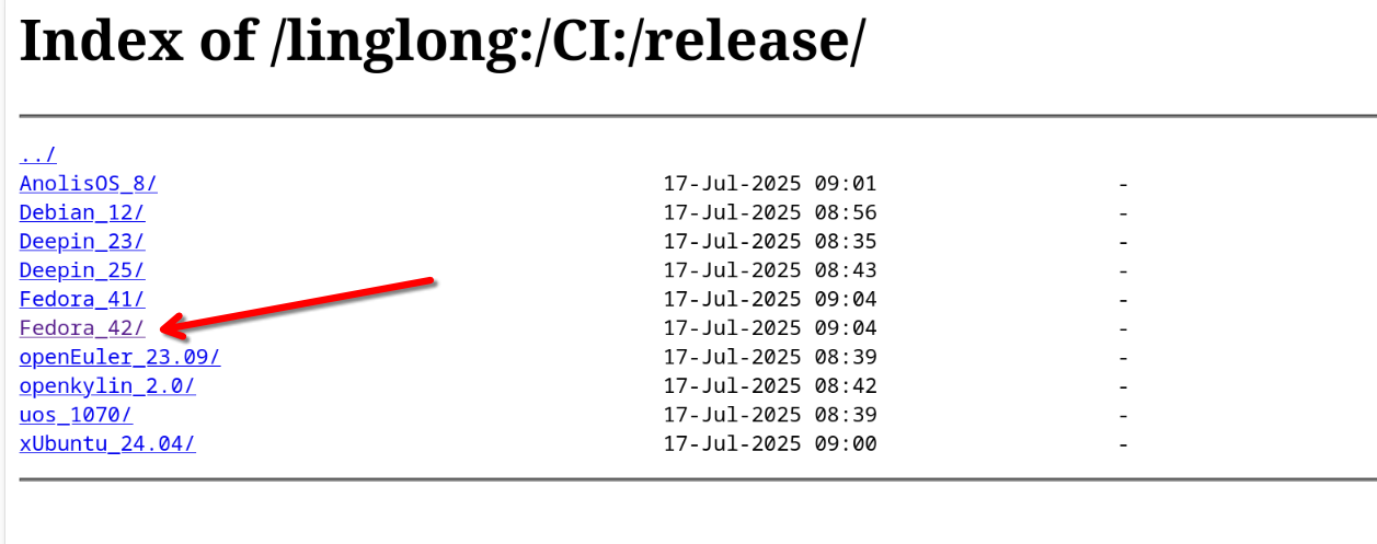

直接打开网址:https://ci.deepin.com/repo/obs/linglong:/CI:/release/
进入Fedora 42的文件夹
点击下载 linglong:CI:release.repo 的文件
然后修改该文件(添加了最后两行的内容)

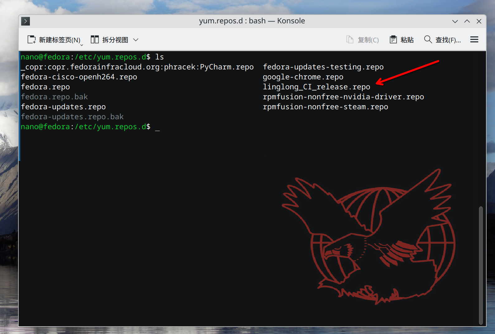

将修改后的文件拷贝到 /etc/yum.repos.d/ 目录下

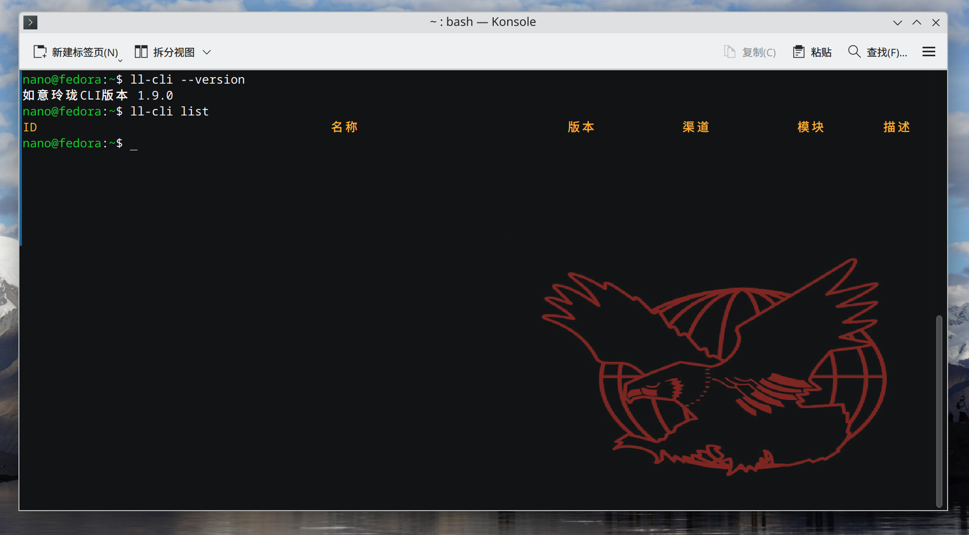

nano@fedora:/etc/yum.repos.d$ sudo dnf install linglong-builder linglong-box linglong-bin
仓库更新和加载中:
仓库加载完成。
Package                        Arch    Version                        Repository                 Size
Installing:
 linglong-bin                  x86_64  1.9.71-40.1                    linglong_CI_release     6.2 MiB
 linglong-box                  x86_64  2.0.21.20250717-2.1            linglong_CI_release   997.7 KiB
 linglong-builder              x86_64  1.9.71-40.1                    linglong_CI_release     2.5 MiB
Transaction Summary:
 Installing:         3 packages
本次要处理的软件包总大小为 3 MiB. 还需下载 3 MiB。
此次操作完成之后,10 MiB 额外的空间被使用 (安装 10 MiB, 删除 0 B)。
Is this ok [y/N]: y
[1/3] linglong-box-0:2.0.21.20250717-2.1.x86_64              100% | 480.6 KiB/s | 329.7 KiB |  00m01s
[2/3] linglong-builder-0:1.9.71-40.1.x86_64                  100% | 377.0 KiB/s | 816.3 KiB |  00m02s
[3/3] linglong-bin-0:1.9.71-40.1.x86_64                      100% | 512.7 KiB/s |   1.8 MiB |  00m04s
[3/3] Total                                                  100% | 838.4 KiB/s |   2.9 MiB |  00m04s
执行事务
[1/5] 验证软件包文件                                  100% | 200.0   B/s |   3.0   B |  00m00s
[2/5] 准备事务                                           100% |  13.0   B/s |   3.0   B |  00m00s
[3/5] 安装linglong-box-0:2.0.21.20250717-2.1.x86_64        100% |  20.7 MiB/s | 998.5 KiB |  00m00s
>>> 运行 sysusers,脚本片段: linglong-bin-0:1.9.71-40.1.x86_64
>>> sysusers 运行完成,脚本片段: linglong-bin-0:1.9.71-40.1.x86_64
>>> Scriptlet 输出:
>>> Creating group 'deepin-linglong' with GID 975.
>>> Creating user 'deepin-linglong' (linglong Package Manager) with UID 975 and GID 975.
[4/5] 安装linglong-bin-0:1.9.71-40.1.x86_64                100% |  83.0 MiB/s |   6.2 MiB |  00m00s
[5/5] 安装linglong-builder-0:1.9.71-40.1.x86_64            100% |   1.0 MiB/s |   2.5 MiB |  00m02s
Warning: skipped OpenPGP checks for 3 packages from repository: linglong_CI_release
完成!

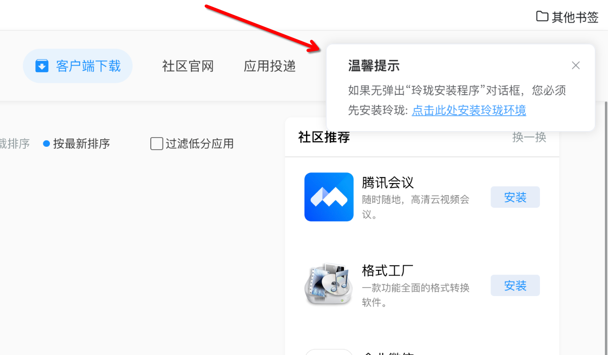

好吧,还是不行呢,点击网页上的安装,就会出现下面的提示

mozixun
2025-07-18 12:27
Feelup:
多谢多谢,我现在就还剩下浏览器无法调用安装的问题了。
这个问题是因为我们SIG暂时没打包在线安装工具,您可以下载AppImage格式的玲珑应用商店进行安装
