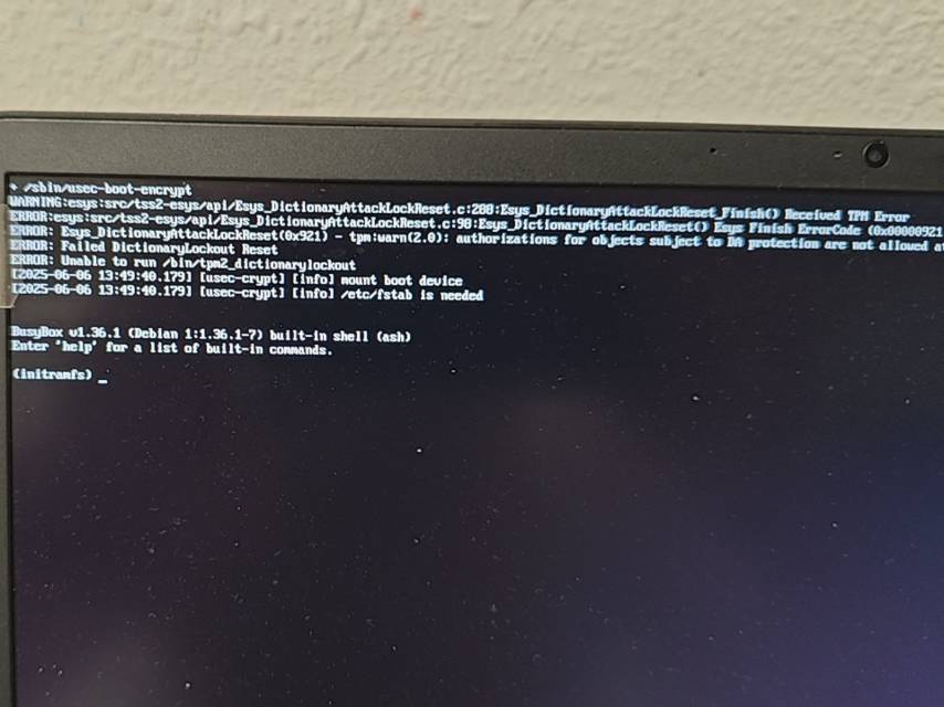

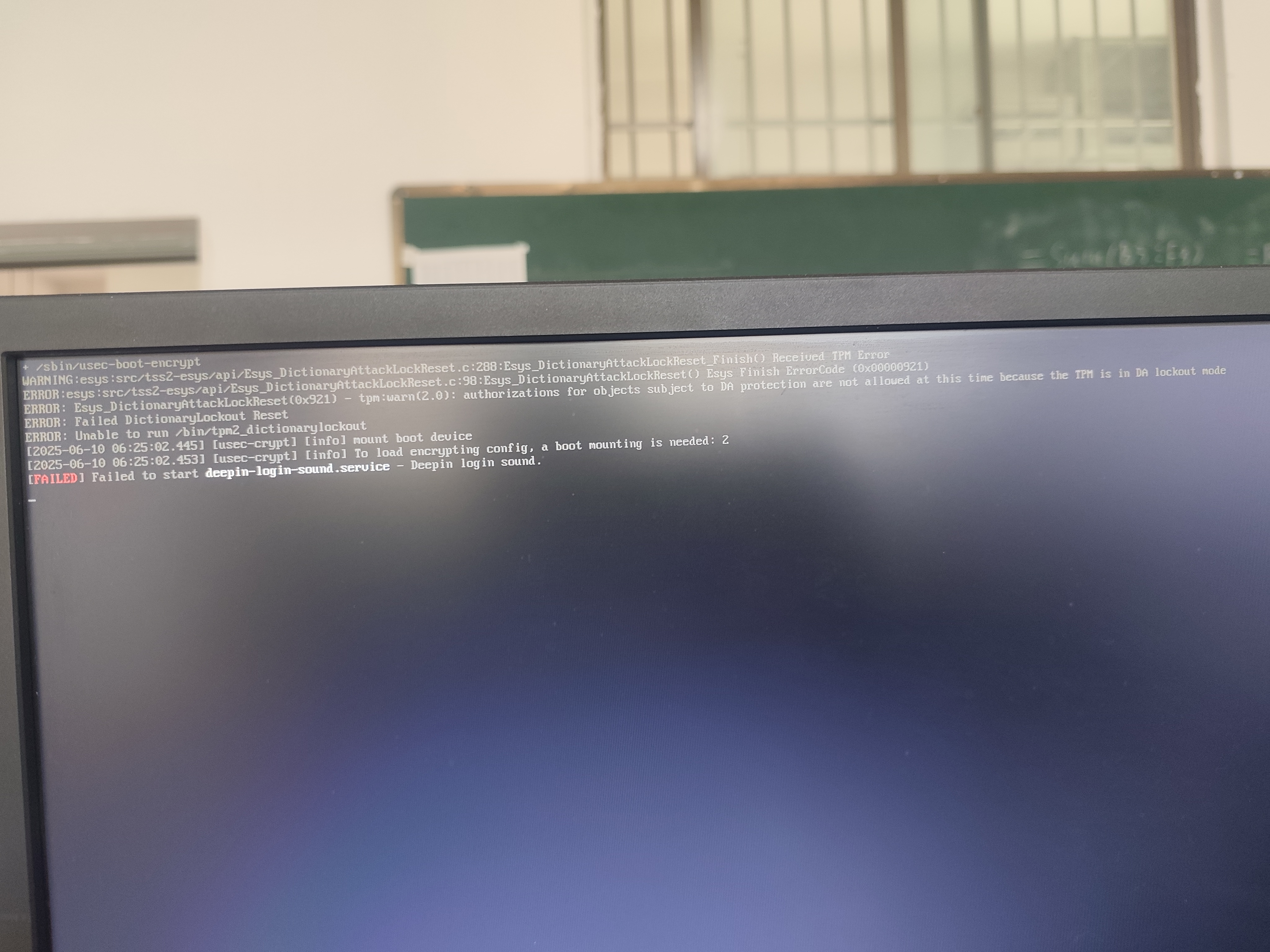

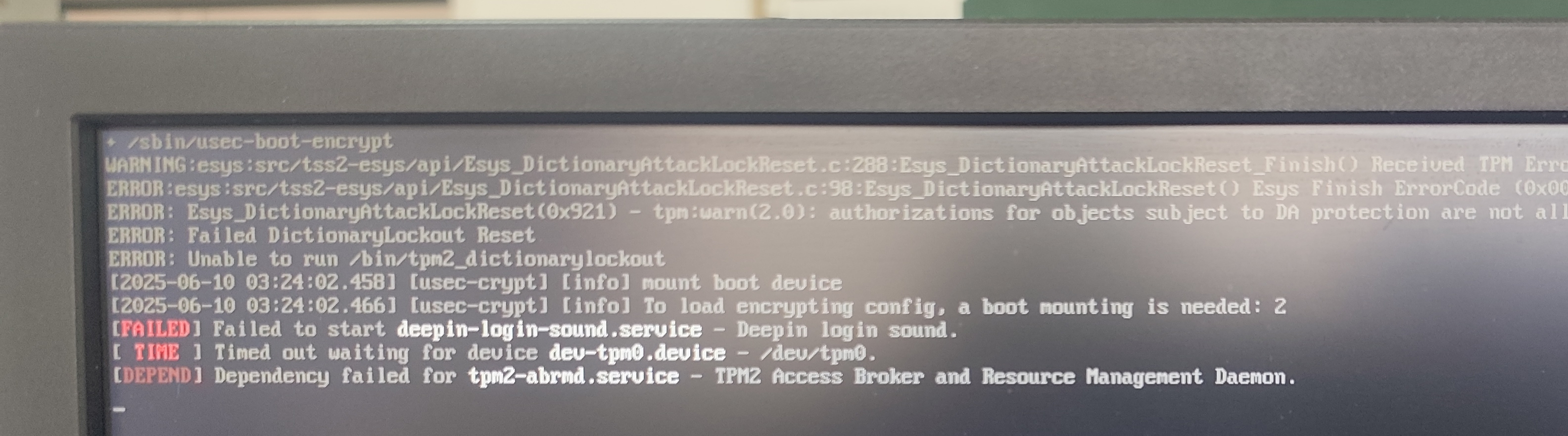

deepin25beta 安装后无法启动,直接卡死在这个界面。请问官方如何解决??
就不能建个群吗?我也是晕了。
/sbin/usec-boot-encrypt
UARNING:esys:src/tss2-esys/api/Esys_DictionaryAttackLockReset.c:288:Esys _DictionaryAttackLockReset_Finish() Received TPM Error
ERROR:esysisrc/tssZ-esys/api/Esys_DictionaryAttackLockReset.c:98:Esys_DictionaryAttackLockReset() Esys Finish ErrorCode (0x00000921)
ERROR: Esys_DictionaryAttackLockReset(0x921)- tpn:uarn(z.0): authorizations for objects subject to DA protection are not allowed at this time because the TPM is in
ERROR: Failed DictionaryLockout Reset
ERROR:Unable to run /bin/tpnz_dictionarylockout
[2025-06-10 03:24:02.458] [usec-crypt] [infol nount boot deuice
[2025-06-10 03:24:02.466] [usec-crypt] [info] To load encrypting config, a boot nounting is needed:2
[FAILED] Failed to start deepin-login-sound.seruice - Deepin login sound.
[ TINE ] Timed out waiting for device deu-tpmo.deuice -/deu/tpmO.
[DEPEND] Dependency failed for tpm2-abrnd.seruice - TPMZ Access Broker and Resource Managenent Daenon.

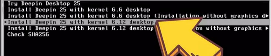

截图_选择区域_20250611094433.jpg选第三项或是第四项
,就是有Installation without graphics 这项,就启动成功了。

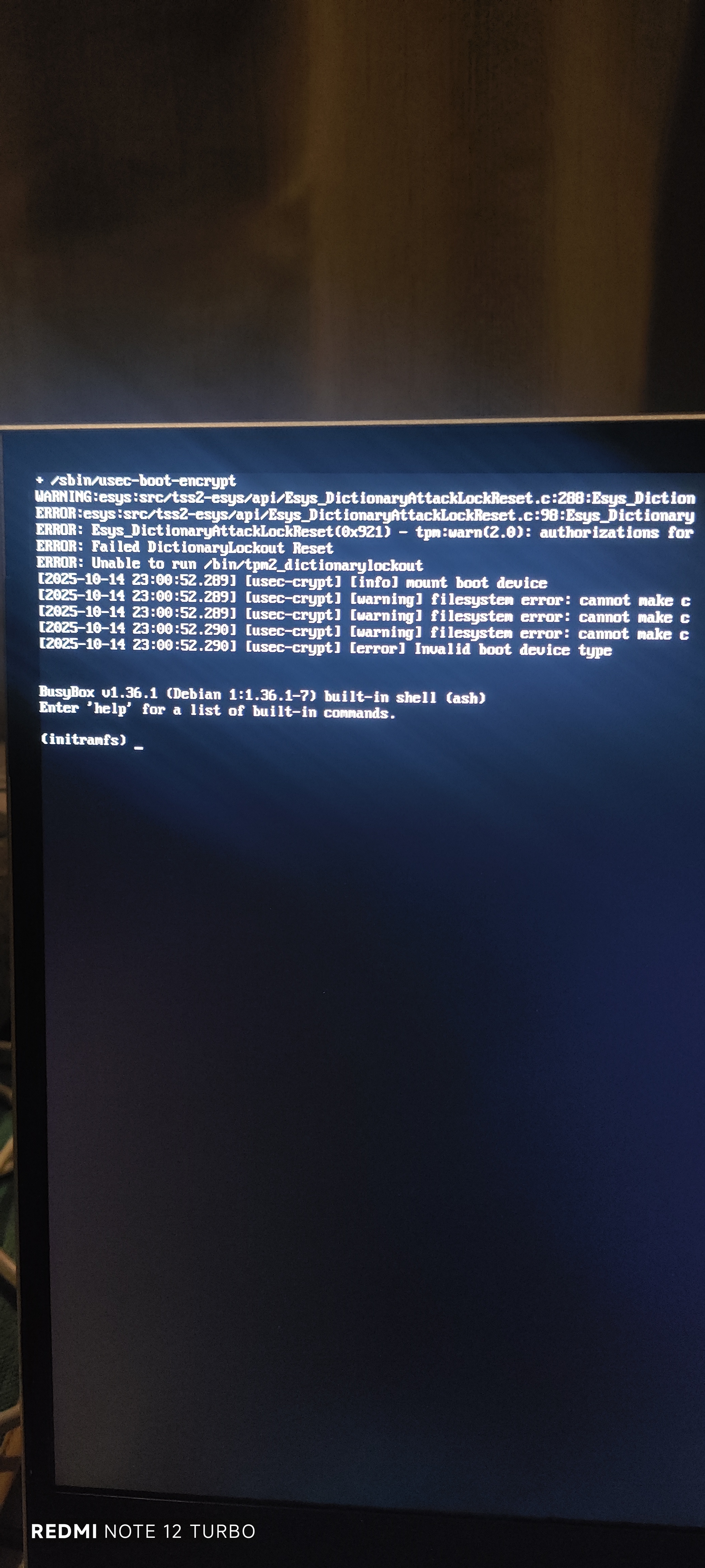

一模一样的问题 安装成功 启动出错
