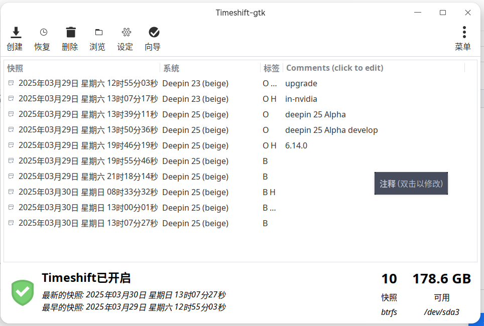

2:安装Timeshift并备份系统(秒备份,可以随时恢复)
参考真香!记使用btrfs+timeshift秒级自动快照备份

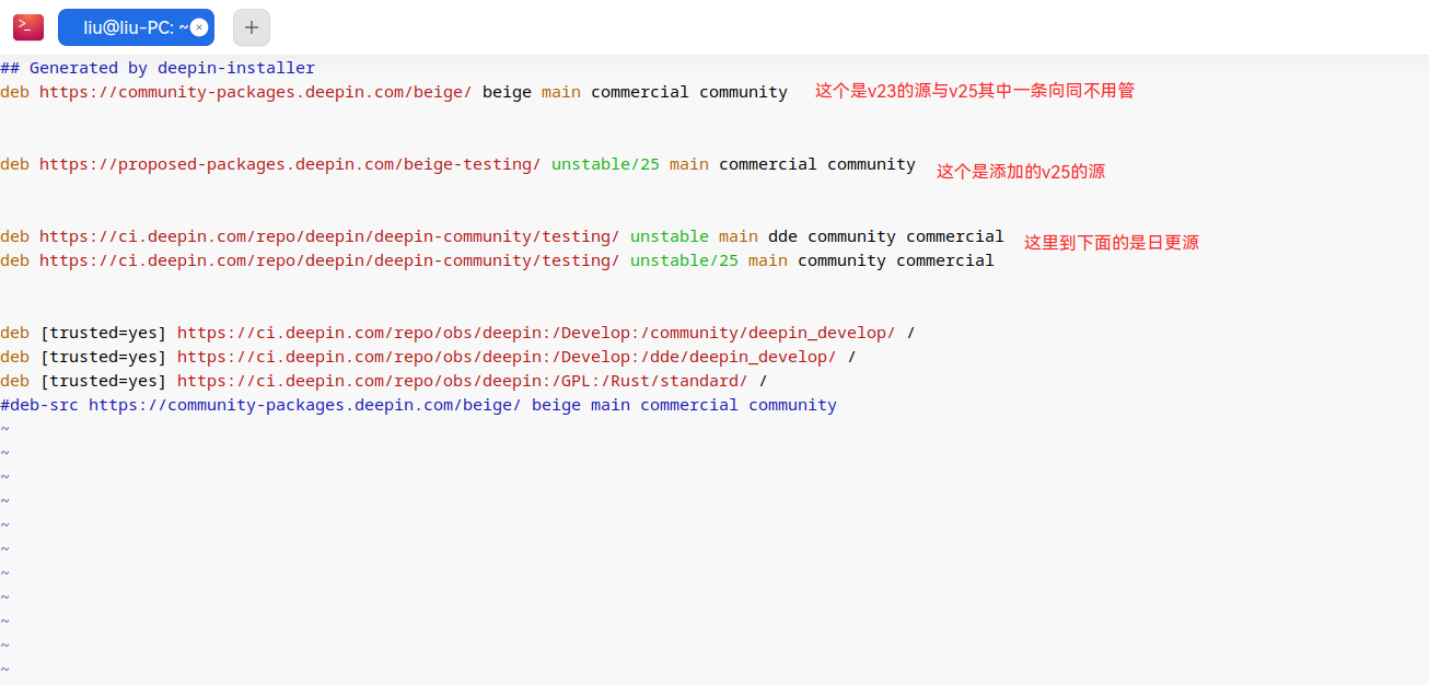

4:添加v25源
sudo vim /etc/apt/sources.list
点击i,就可以编辑了,然后把这些复制到里面去,
deb https://proposed-packages.deepin.com/beige-testing/ unstable/25 main commercial community
然后按一下Esc退出编辑,Shfit+:,输入wq!,退出
以下为日更源谨慎添加
deb https://ci.deepin.com/repo/deepin/deepin-community/testing/ unstable main dde community commercial
deb https://ci.deepin.com/repo/deepin/deepin-community/testing/ unstable/25 main community commercial
deb [trusted=yes] https://ci.deepin.com/repo/obs/deepin:/Develop:/community/deepin_develop/ /
deb [trusted=yes] https://ci.deepin.com/repo/obs/deepin:/Develop:/dde/deepin_develop/ /
deb [trusted=yes] https://ci.deepin.com/repo/obs/deepin:/GPL:/Rust/standard/ /

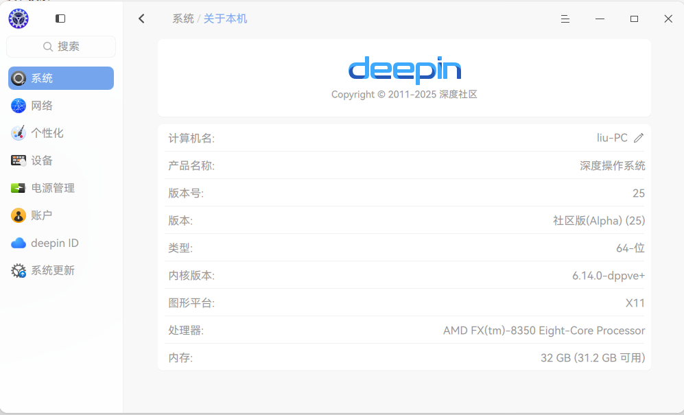

5:安装完的可以用以下命令更新
sudo aptss update && sudo aptss dist-upgrade -y
6:更新时一定会报错,用下列修复安装即可
sudo apt -f install
7:然后再次更新即可
