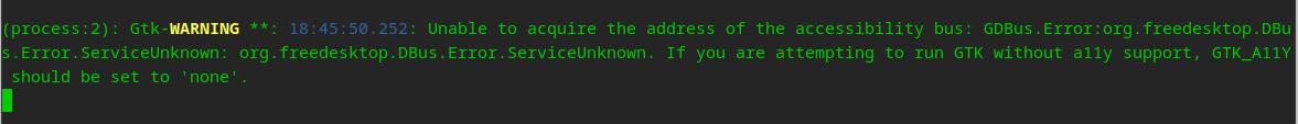

(process:2): Gtk-WARNING **: 18:45:50.252: Unable to acquire the address of the accessibility bus: GDBus.Error:org.freedesktop.DBus.Error.ServiceUnknown: org.freedesktop.DBus.Error.ServiceUnknown. If you are attempting to run GTK without a11y support, GTK_A11Y should be set to 'none'.
这什么原因啊 !

2025-03-25 19:15
这看起来是个Warning ,并不影响功能

我也去 问AI了 结果解决了 ! 还是AI厉害 !
lchunghan
2025-03-25 19:40
一股脑儿 复制黏贴 有点长
其实上面大部分只是检查方法 一个一个查过来
基本应该是缺少 Flatpak 应用与桌面环境(如文件选择器、权限请求)通信的桥梁。
sudo apt install xdg-desktop-portal xdg-desktop-portal-gtk
