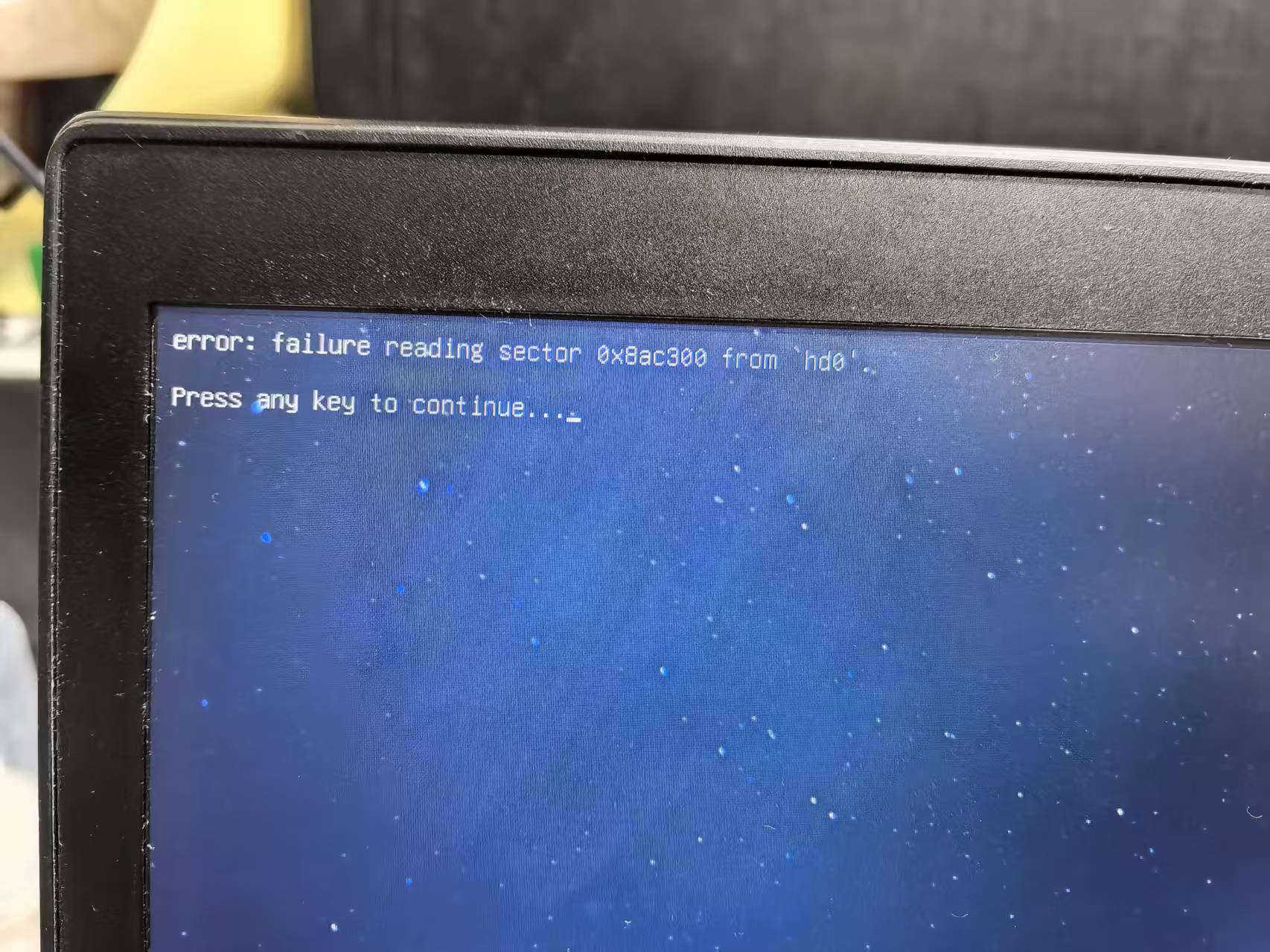

mlbhk007
2025-02-28 19:11
自己mark一下,也给后来人方便避坑
error: failure reading sector 8x8ac300 from 'hd0'
Press any key to continue...
mlbhk007
2025-02-28 19:15

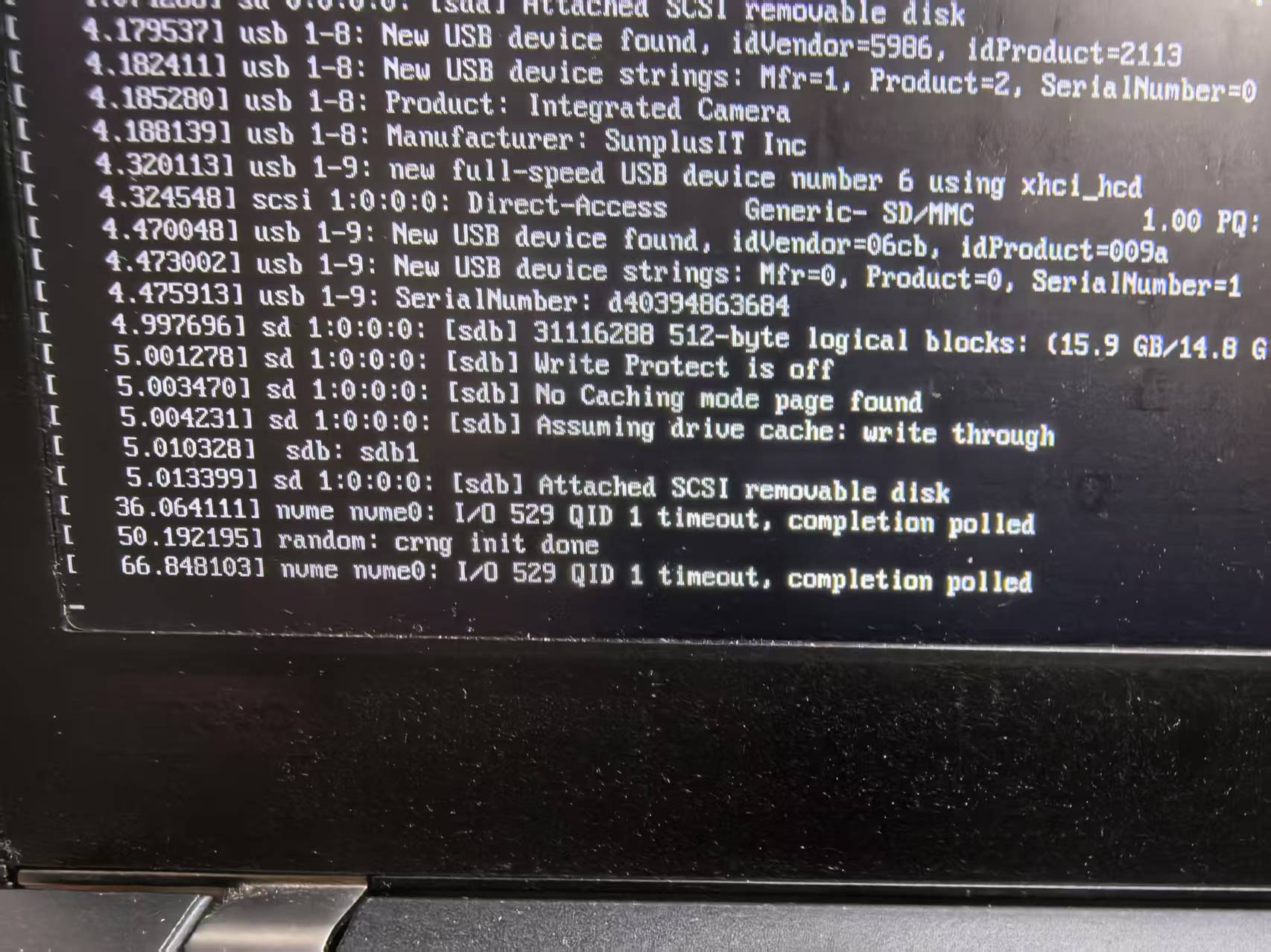

错误信息:
4.9976961 sd 1:0:0:0: [sdb1 31116288 512-byte logical blocks: (15.9 GB/14.85.0012?81 sd 1:0:0:0:[sdb1 Write Protect is off5.0034701 sd 1:0:0:0:[sdbl No caching mode page found5.0042311 sd 1:0:0:0::[sdbl Assuming driue cache: write through5.0103281sdb: sdb15.0133991 sd 1:0:0:0:[sdbl Attached scsl remouable disk36.0641111 nume nume0: I/0 529 qID 1 timeout, completion polled50.1921951 random:crng init done66.8481031 nume nume0: I/0 529 QID 1 timeout, completion polled
安装deepin和ubantu的时候都遇到,经认真排查为U盘问题,换了U盘居然成功安装,EFI分区也很重要,安装win11 LTSC的时候默认100MB,居然连deepin liveCD都不能启动,一度怀疑致钛硬盘有问题,还好还好。。。。
