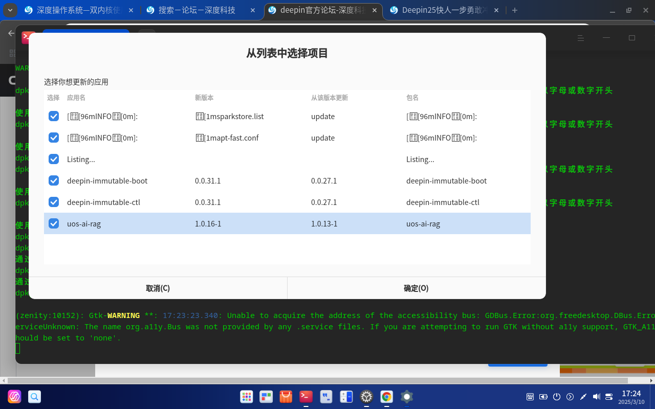

不好使了,弹窗前面两行有类似乱码信息,点击“确定”后,直接显示升级完毕,但实际没有更新动作
sudo gxde-app-upgrader
Loading transhell from /usr/libexec/gxde-app-upgrader/transhell/gxde-do-upgrade.sh_en_US.transhell ...
Loading transhell from /usr/libexec/gxde-app-upgrader/transhell/gxde-do-upgrade.sh_zh_CN.transhell ...
(zenity:6969): Gtk-WARNING **: 17:15:12.553: Unable to acquire the address of the accessibility bus: GDBus.Error:org.freedesktop.DBus.Error.ServiceUnknown: The name org.a11y.Bus was not provided by any .service files. If you are attempting to run GTK without a11y support, GTK_A11Y should be set to 'none'.
ln: failed to create symbolic link '/opt/durapps/spark-store/bin/apt-fast-conf/sources.list.d/appstore.list': Read-only file system
ln: failed to create symbolic link '/opt/durapps/spark-store/bin/apt-fast-conf/sources.list.d/driver.list': Read-only file system
ln: failed to create symbolic link '/opt/durapps/spark-store/bin/apt-fast-conf/sources.list.d/sublime-text.list': Read-only file system
##O=#   #                                                                                                                                     Warning: Failed to open the file /opt/durapps/spark-store/bin/apt-fast-conf/sources.list.d/sparkstore.list: Read-only file system
curl: (23) client returned ERROR on write of 173 bytes
####################################################################################################################################### 100.0%
WARNING: apt does not have a stable CLI interface. Use with caution in scripts.
dpkg-query: 错误: --listfiles 需要一个有效的软件包名。而 [INFO]: 不是: 在说明符 '[INFO]:' 中包含非法软件包名: 必须以字母或数字开头
使用 --help 查看关于查询软件包的帮助。
dpkg-query: 没有找到与 [INFO]: 相匹配的软件包
dpkg-query: 软件包 listing... 没有被安装
通过 dpkg --contents (= dpkg-deb --contents) 来列出档案文件清单。
dpkg-query: 没有找到与 Listing... 相匹配的软件包
(zenity:7771): Gtk-WARNING **: 17:15:19.784: Unable to acquire the address of the accessibility bus: GDBus.Error:org.freedesktop.DBus.Error.ServiceUnknown: The name org.a11y.Bus was not provided by any .service files. If you are attempting to run GTK without a11y support, GTK_A11Y should be set to 'none'.
(zenity:7771): GLib-WARNING **: 17:15:23.335: ../../../glib/giounix.c:414Error while getting flags for FD: 错误的文件描述符 (9)
(zenity:7802): Gtk-WARNING **: 17:15:23.856: Unable to acquire the address of the accessibility bus: GDBus.Error:org.freedesktop.DBus.Error.ServiceUnknown: The name org.a11y.Bus was not provided by any .service files. If you are attempting to run GTK without a11y support, GTK_A11Y should be set to 'none'.
(zenity:7917): Gtk-WARNING **: 17:15:25.545: Unable to acquire the address of the accessibility bus: GDBus.Error:org.freedesktop.DBus.Error.ServiceUnknown: The name org.a11y.Bus was not provided by any .service files. If you are attempting to run GTK without a11y support, GTK_A11Y should be set to 'none'.
