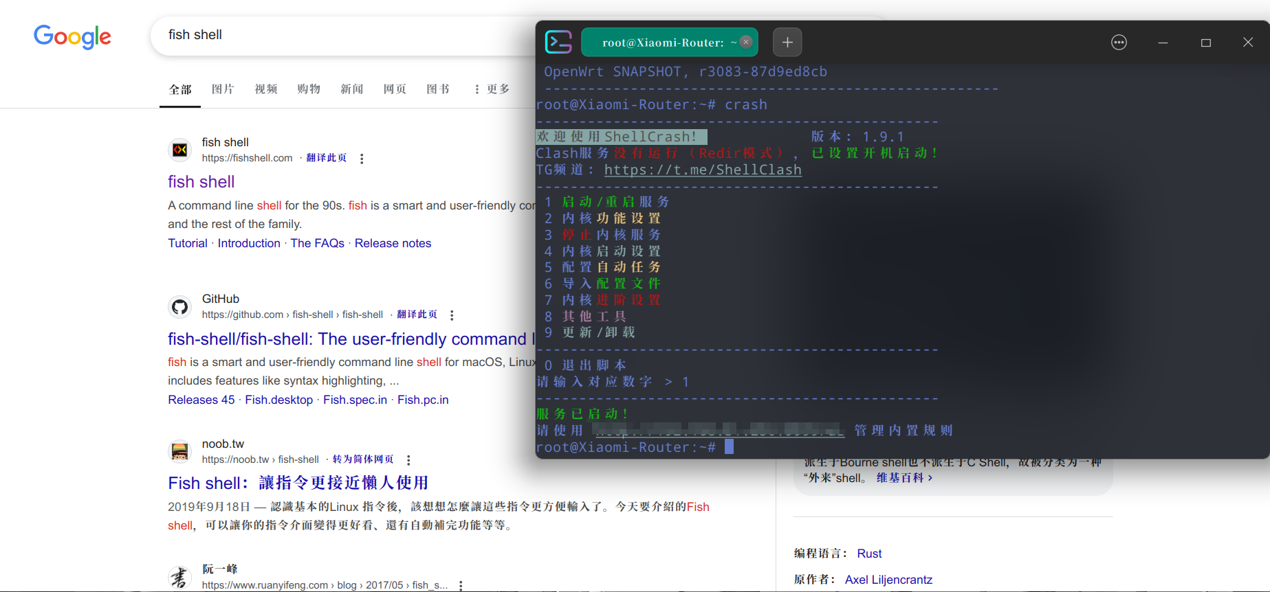

在我使用树莓派做软路由时,使用的是openclash科学上网,但是我在小米4A千兆版上安装openclash时,发现内存不足,后来查了一下小米4A在刷好openwrt后,可用内存只有6M左右,而且安装openclash的分区只有不到3MB,折腾一天无果后,在NAS群中看到网友推荐的shellcrash
ShellCrash
安装方式非常简单,配置也简单,只需要上传yaml文件到路由器的/tmp目录

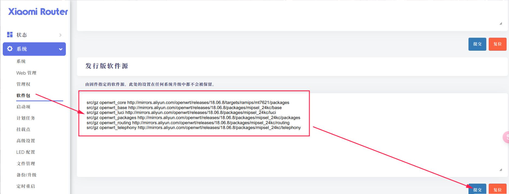

src/gz openwrt_core http://mirrors.aliyun.com/openwrt/releases/18.06.8/targets/ramips/mt7621/packages src/gz openwrt_base http://mirrors.aliyun.com/openwrt/releases/18.06.8/packages/mipsel_24kc/base src/gz openwrt_luci http://mirrors.aliyun.com/openwrt/releases/18.06.8/packages/mipsel_24kc/luci src/gz openwrt_packages http://mirrors.aliyun.com/openwrt/releases/18.06.8/packages/mipsel_24kc/packages src/gz openwrt_routing http://mirrors.aliyun.com/openwrt/releases/18.06.8/packages/mipsel_24kc/routing src/gz openwrt_telephony http://mirrors.aliyun.com/openwrt/releases/18.06.8/packages/mipsel_24kc/telephony
修改完成后
opkg update;
如果更新出错
Failed to download the package list from http://mirrors.aliyun.com
则修改dns
vim /etc/resolv.conf # 添加下面2行 nameserver 8.8.8.8 nameserver 8.8.4.4
正常访问

科学上网
ShellCrash
更换软件源
修改完成后
如果更新出错
则修改dns
正常访问
