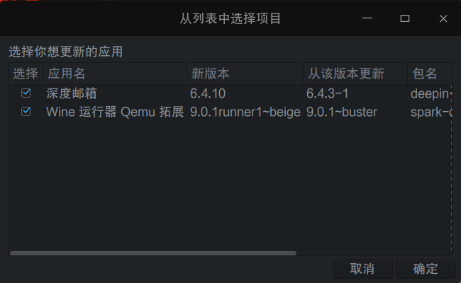

[3rd-Party Apps] 星火应用商店更新邮箱和wine运行器时报错
Black
2024-12-06 16:35
[apt-fast 16:30:44]
[apt-fast 16:30:44]Working... this may take a while.
[apt-fast 16:30:44]正在工作中,请稍等
E: Unable to correct problems, you have held broken packages.
[apt-fast 16:30:44]Package manager quit with exit code.Here is the log
[apt-fast 16:30:44]包管理器以错误代码退出.日志如下
[apt-fast 16:30:44]Reading package lists...
Building dependency tree...
Reading state information...
Some packages could not be installed. This may mean that you have
requested an impossible situation or if you are using the unstable
distribution that some required packages have not yet been created
or been moved out of Incoming.
The following information may help to resolve the situation:
The following packages have unmet dependencies:
spark-deepin-wine-runner-qemu-system-extra : Depends: libbpf1 (>= 1:0.0.8) but it is not installable
Depends: libbrlapi0.8 (>= 6.6) but it is not installable
Depends: libc6 (>= 2.38) but 2.28.21-1+deepin-1 is to be installed
Depends: libcapstone4 (>= 4) but it is not installable
Depends: libfdt1 (>= 1.6.0) but 1.4.7-4 is to be installed
Depends: libgdk-pixbuf-2.0-0 (>= 2.22.0) but it is not installable
Depends: libgfapi0 (>= 10.0) but 5.5-3 is to be installed
Depends: libglib2.0-0 (>= 2.79.0) but 2.58.3.9-1+deepin is to be installed
Depends: libgnutls30 (>= 3.7.5) but 3.6.7.7-deepin1 is to be installed
Depends: libibverbs1 (>= 28) but 22.1.1-1+dde is to be installed
Depends: libnfs13 (>= 1.11.0) but it is not installable
Depends: librados2 (>= 18.2.1+ds) but 12.2.11+dfsg1.2-1+dde is to be installed
Depends: librbd1 (>= 18.2.0+ds) but 12.2.11+dfsg1.2-1+dde is to be installed
Depends: libsasl2-2 (>= 2.1.28+dfsg1) but 2.1.27.1-1+dde is to be installed
Depends: libsdl2-2.0-0 (>= 2.0.12) but 2.0.9.5-1+dde is to be installed
Depends: libselinux1 (>= 3.1~) but 2.8.1.7-1+dde is to be installed
Depends: libslirp0 (>= 4.1.0) but it is not installable
Depends: libspice-server1 (>= 0.14.2) but 0.14.0-1.3+deb10u1 is to be installed
Depends: liburing2 (>= 2.0) but it is not installable
Depends: libusb-1.0-0 (>= 2:1.0.23~) but 2:1.0.22-2 is to be installed
Depends: libvdeplug2 (>= 4.0.1) but 2.3.2+r586-2.2 is to be installed
Depends: libvirglrenderer1 (>= 0.8.0) but it is not installable
Depends: libxendevicemodel1 (>= 4.17.3+10-g091466ba55) but 4.11.4+57.2-1+dde is to be installed
Depends: libxenevtchn1 (>= 4.17.3+10-g091466ba55) but 4.11.4+57.2-1+dde is to be installed
Depends: libxenforeignmemory1 (>= 4.17.3+10-g091466ba55) but 4.11.4+57.2-1+dde is to be installed
Depends: libxengnttab1 (>= 4.17.3+10-g091466ba55) but 4.11.4+57.2-1+dde is to be installed
Depends: libxenmisc4.17 (>= 4.17.3+10-g091466ba55) but it is not installable
Depends: libxenstore4 (>= 4.16.0) but it is not installable
Depends: libxentoolcore1 (>= 4.17.3+10-g091466ba55) but 4.11.4+57.2-1+dde is to be installed
Depends: libzstd1 (>= 1.5.5) but 1.3.8+dfsg.1-1+security is to be installed

2024-12-06 17:46
深度邮箱属于deepin社区官方应用程序, 请通过应用商店进行更新
2024-12-06 18:26
deepin 20.9已经终止支持,请更新系统或者使用 ACE 兼容环境 安装不兼容的应用
