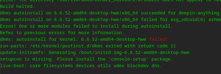

不知道弄了什么,现在每次命令行安装软件都提示dkms failed
当我输入
sudo apt install xxx
然后就会出现如下错误:
完整输出如下:
正在读取状态信息... 完成
下列软件包是自动安装的并且现在不需要了:
  dde-cooperation-daemon dde-cooperation-transfer dde-file-manager-server-plugins l*coregtk-4.0-18 libplacebo292
  libwebkit2gtk-4.0-37 libwpe-1.0-1 libwpebackend-fdo-1.0-1
使用'sudo apt autoremove'来卸载它(它们)。
下列【新】软件包将被安装:
  d-feet
升级了 0 个软件包,新安装了 1 个软件包,要卸载 0 个软件包,有 5 个软件包未被升级。
有 2 个软件包没有被完全安装或卸载。
需要下载 61.4 kB 的归档。
解压缩后会消耗 476 kB 的额外空间。
获取:1 https://community-packages.deepin.com/beige beige/main amd64 d-feet all 0.3.16-3 [61.4 kB]
已下载 61.4 kB,耗时 1秒 (68.7 kB/s)
正在选中未选择的软件包 d-feet。
(正在读取数据库 ... 系统当前共安装有 459332 个文件和目录。)
准备解压 .../d-feet_0.3.16-3_all.deb  ...
正在解压 d-feet (0.3.16-3) ...
正在设置 d-feet (0.3.16-3) ...
正在设置 linux-image-6.6.52-amd64-desktop-hwe (23.01.00.38) ...
dkms: running auto installation service for kernel 6.6.52-amd64-desktop-hwe.
Sign command: /lib/modules/6.6.52-amd64-desktop-hwe/build/scripts/sign-file
Signing key: /var/lib/dkms/mok.key
Public certificate (MOK): /var/lib/dkms/mok.pub
Error! The directory /var/lib/dkms/asg_xdroid/2.0/source does not appear to have module source located within it.
Build halted.
Error! The directory /var/lib/dkms/ashmem_xdroid/2.0/source does not appear to have module source located within it.
Build halted.
Error! The directory /var/lib/dkms/binder_xdroid/2.0/source does not appear to have module source located within it.
Build halted.
dkms autoinstall on 6.6.52-amd64-desktop-hwe/x86_64 succeeded for deepin-anything nvidia
dkms autoinstall on 6.6.52-amd64-desktop-hwe/x86_64 failed for asg_xdroid(8) ashmem_xdroid(8) binder_xdroid(8)
Error! One or more modules failed to install during autoinstall.
Refer to previous errors for more information.
dkms: autoinstall for kernel: 6.6.52-amd64-desktop-hwe failed!
run-parts: /etc/kernel/postinst.d/dkms exited with return code 11
update-initramfs: Generating /boot/initrd.img-6.6.52-amd64-desktop-hwe
setupcon is missing. Please install the 'console-setup' package.
live-boot: core filesystems devices utils udev blockdev dns.
fix systemd/logind config
Generating grub configuration file ...
Found theme: /boot/grub/themes/deepin/theme.txt
Found background image: /boot/grub/themes/deepin/background.jpg
Found linux image: /boot/vmlinuz-6.6.52-amd64-desktop-hwe
Found initrd image: /boot/initrd.img-6.6.52-amd64-desktop-hwe
Found linux image: /boot/vmlinuz-6.6.47-amd64-desktop-hwe
Found initrd image: /boot/initrd.img-6.6.47-amd64-desktop-hwe
Warning: os-prober will be executed to detect other bootable partitions.
Its output will be used to detect bootable binaries on them and create new boot entries.
Found Windows Boot Manager on /dev/nvme0n1p1@/EFI/Microsoft/Boot/bootmgfw.efi
Adding boot menu entry for UEFI Firmware Settings ...
done
dpkg: 处理软件包 linux-image-6.6.52-amd64-desktop-hwe (--configure)时出错:
 已安装 linux-image-6.6.52-amd64-desktop-hwe 软件包 post-installation 脚本 子进程返回错误状态 1
dpkg: 依赖关系问题使得 linux-image-deepin-hwe-amd64 的配置工作不能继续:
 linux-image-deepin-hwe-amd64 依赖于 linux-image-6.6.52-amd64-desktop-hwe;然而:
  软件包 linux-image-6.6.52-amd64-desktop-hwe 尚未配置。
dpkg: 处理软件包 linux-image-deepin-hwe-amd64 (--configure)时出错:
 依赖关系问题 - 仍未被配置
正在处理用于 bamfdaemon (0.5.6+repack-1) 的触发器 ...
Rebuilding /usr/share/applications/bamf-2.index...
正在处理用于 desktop-file-utils (0.26-deepin) 的触发器 ...
正在处理用于 hicolor-icon-theme (0.17-2) 的触发器 ...
正在处理用于 libglib2.0-0:amd64 (2.80.1-1deepin1) 的触发器 ...
正在处理用于 man-db (2.12.0-1) 的触发器 ...
在处理时有错误发生:
E: Sub-process /usr/bin/dpkg returned an error code (1)
但是软件居然还是安装成了,很莫名其妙。
该怎么解决这个问题?

我只能看出来是缺乏三个模块的源码。
尝试着安装一下对应的模块源码呢?

目测是xdroid的内核模块在新内核上编译失败了?
可以试试卸载xdroid,更新内核,然后重装xdroid。
ps 以前在manjaro上工作的时候,更新内核和英伟达驱动经常遇到这种事

apt search linux-headers-6.6.52
看一下内核头文件安装了没,如果没安装这些模块是很有可能失败的,没安装就把内核头文件装一下

也是报错:
sudo apt install console-setup
请输入密码:
验证成功
正在读取软件包列表... 完成
正在分析软件包的依赖关系树... 完成
正在读取状态信息... 完成
将会同时安装下列软件:
  console-setup-linux
下列【新】软件包将被安装:
  console-setup console-setup-linux
升级了 0 个软件包,新安装了 2 个软件包,要卸载 0 个软件包,有 6 个软件包未被升级。
有 2 个软件包没有被完全安装或卸载。
需要下载 1,984 kB 的归档。
解压缩后会消耗 2,684 kB 的额外空间。
您希望继续执行吗? [Y/n] y
获取:1 https://community-packages.deepin.com/beige beige/main amd64 console-setup-linux all 1.223 [1,882 kB]
获取:2 https://community-packages.deepin.com/beige beige/main amd64 console-setup all 1.223 [102 kB]
已下载 1,984 kB,耗时 10秒 (192 kB/s)
正在预设定软件包 ...
正在选中未选择的软件包 console-setup-linux。
(正在读取数据库 ... 系统当前共安装有 459463 个文件和目录。)
准备解压 .../console-setup-linux_1.223_all.deb  ...
正在解压 console-setup-linux (1.223) ...
正在选中未选择的软件包 console-setup。
准备解压 .../console-setup_1.223_all.deb  ...
正在解压 console-setup (1.223) ...
Build halted.
Build halted.
Build halted.
done
正在设置 console-setup-linux (1.223) ...
Created symlink /etc/systemd/system/sysinit.target.wants/keyboard-setup.service → /usr/lib/systemd/system/keyboard-setup.service.
Created symlink /etc/systemd/system/multi-user.target.wants/console-setup.service → /usr/lib/systemd/system/console-setup.service.
insserv: FATAL: service mountkernfs has to be enabled to use service keyboard-setup.sh
正在设置 console-setup (1.223) ...
 依赖关系问题 - 仍未被配置
在处理时有错误发生:
装了,估计是安装麟卓的时候被破坏了?
linux-headers-6.6.52-amd64-desktop-hwe/未知,now 23.01.00.38 amd64 [已安装,自动]
Linux kernel headers for 6.6.52-amd64-desktop-hwe on amd64
Ligocut光剪视频剪辑软件
2024-10-16 11:27
fallingstar-ten:

Ligocut光剪视频剪辑软件:
也是报错:
请输入密码:
验证成功
正在读取软件包列表... 完成
正在分析软件包的依赖关系树... 完成
正在读取状态信息... 完成
将会同时安装下列软件:
  console-setup-linux
下列【新】软件包将被安装:
有 2 个软件包没有被完全安装或卸载。
需要下载 1,984 kB 的归档。
您希望继续执行吗? [Y/n] y
正在预设定软件包 ...
Build halted.
Build halted.
Build halted.
done
 依赖关系问题 - 仍未被配置
在处理时有错误发生:

Ligocut光剪视频剪辑软件
2024-10-17 00:45
手动清理DKMS 模块就好了
sudo dkms remove -m asg_xdroid -v 2.0 --all
sudo dkms remove -m ashmem_xdroid -v 2.0 --all
sudo dkms remove -m binder_xdroid -v 2.0 --all
