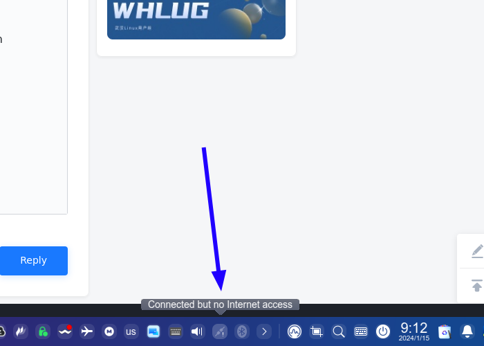

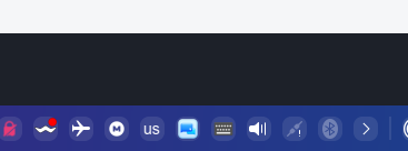

Hi, today I got a strange bug. The Ethernet icon shows up as disconnected but I have internet access. The Wifi doesn't work. I can't no longer enable it. The same goes for Bluetooth.
When I click on enable, nothing happens. I tried to enable on dock and via settings app. Nothing works. Stays disabled :(

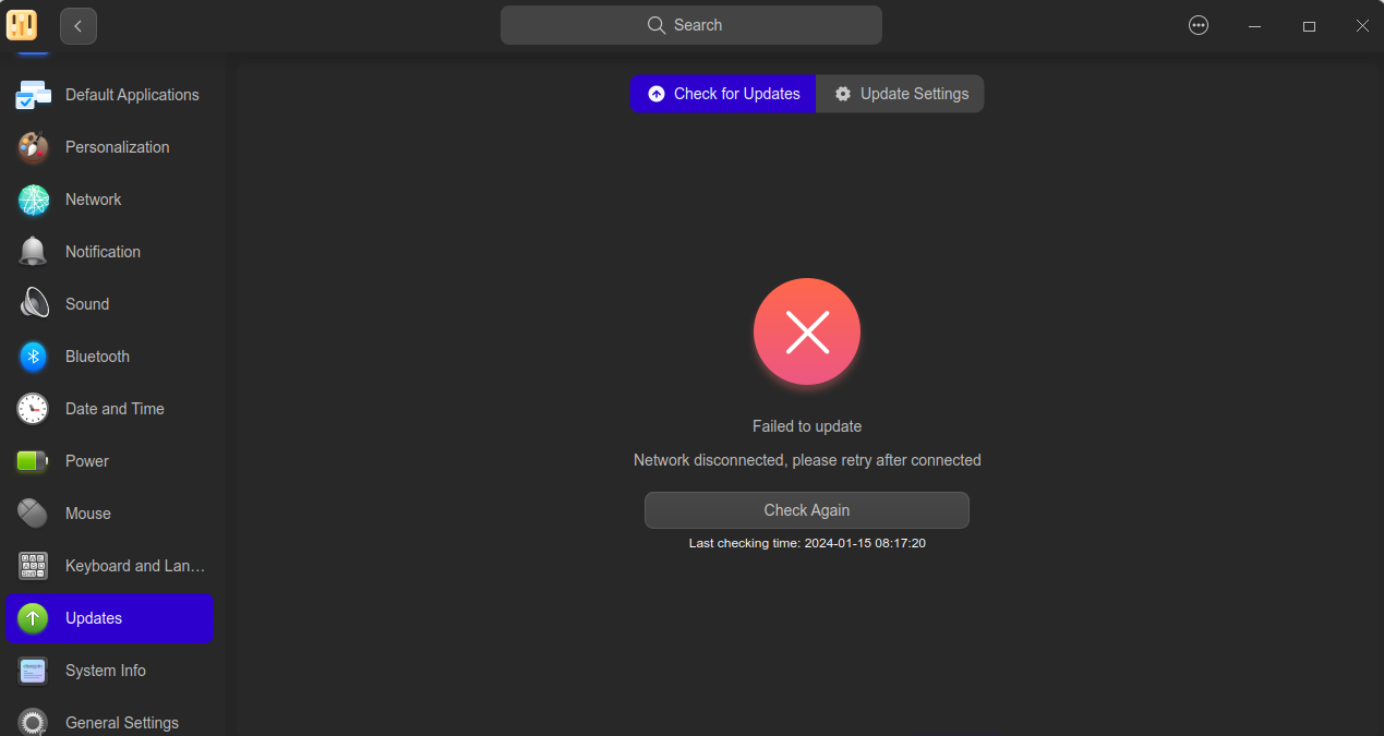

Another issue, maybe related: Update check fails constantly.

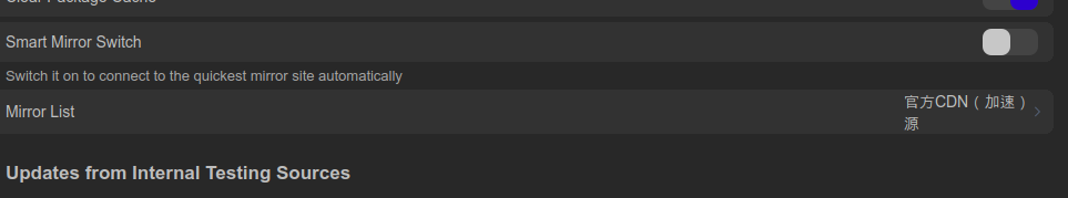

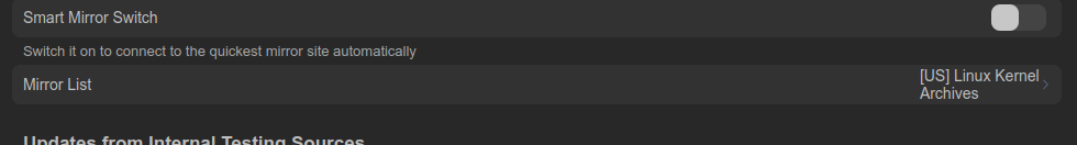

I tried to switch mirrors (Linux Kernel Archives) to see if that fixes something but I see it goes back to previous mirror.
Mirror I want (it's closer to me)
But system switches back to this mirror;

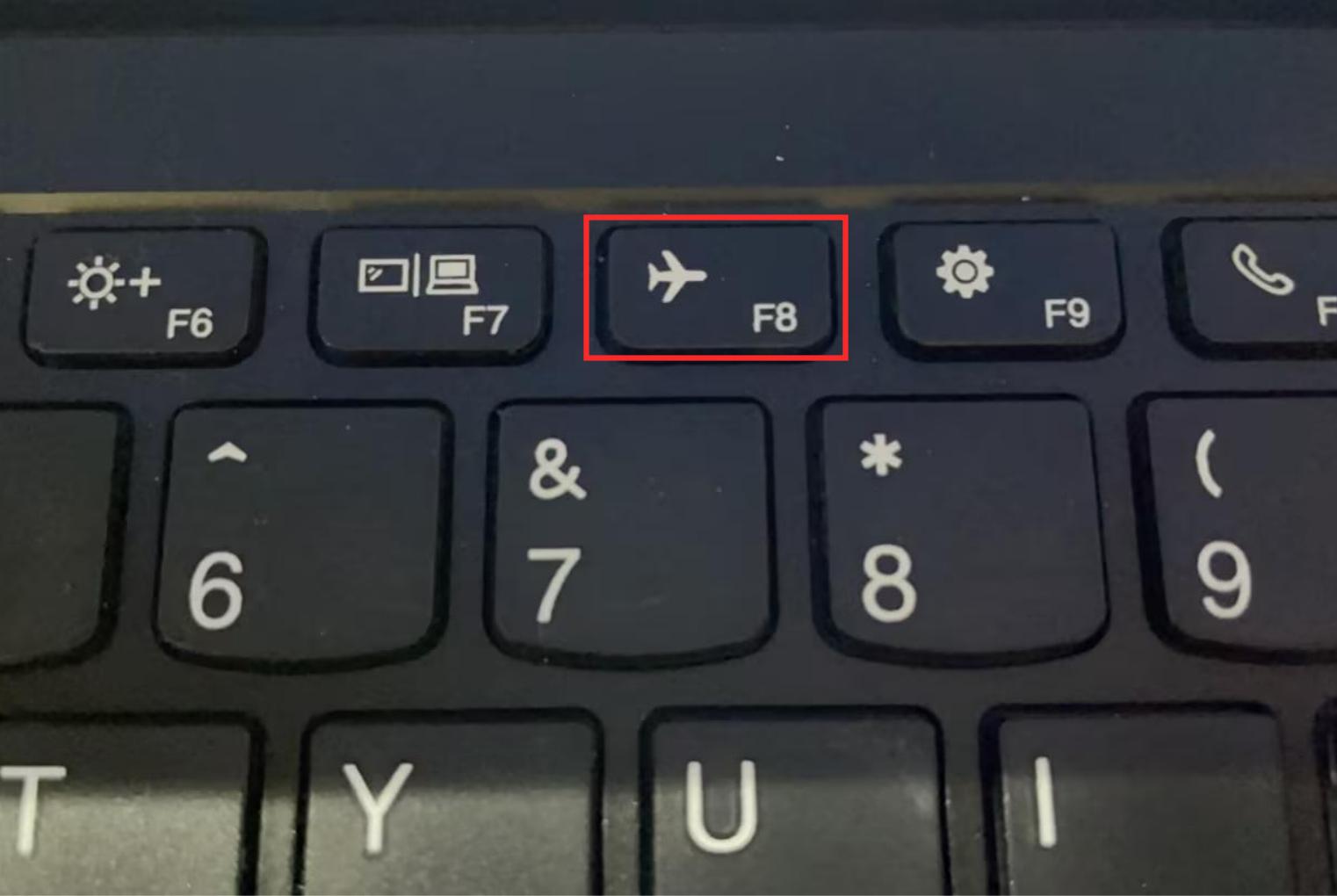

It seems like that the airplane mode has been turned on. We suggest that you turn it off by clicking the button on the keyboard as shown in the following picture.
The issue of the inability to switch mirror in deepin 20.9 is a known issue, but I feel sorry that currently we will not further optimize it in deepin 20.9.

"The issue of the inability to switch mirror in deepin 20.9 is a known issue, but I feel sorry that currently we will not further optimize it in deepin 20.9."
Thanks for letting me know.
However, regarding wireless, I don't have an airplane mode button. Ethernet is working though even though the network icon on the dock says no internet.
However, I'm most worried about the update issue. I can't update and I used a network monitor to check for any blocked traffic. I couldn't find anything. It says network disconnected but I have internet. Or could you tell me what domains should be whitelisted? There's a firewall but I don't have access to it. However, I can ask the admin to whitelist necessary domains. I would be very grateful if that could be fixed. Thanks.
