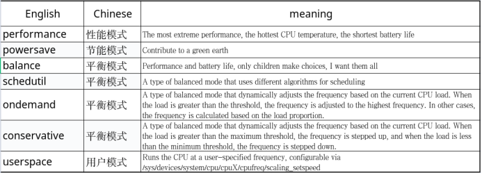

scaling freq scheduling
This is the most traditional CPU scheduling method. You can obtain the optional power mode in scaling_available_governors under the policy folder:
You may be curious why there are so many balance modes here. In fact, these balance modes all have the same function: balancing performance and battery life, but the algorithms used may be different. I will not explain in detail here. I found some detailed information on the Internet. For reference, interested friends can check it out by themselves:
oppo kernel team:
schedutil governor scenario analysis: http://www.wowotech.net/process_management/schedutil_governor.html
Linux kernel documentation: schedutil governor: https://www.kernel.org/doc/html/next/translations/zh_CN/scheduler/schedutil.html
Arch wiki: https://wiki.archlinux.org/title/CPU_frequency_scaling
We can change scaling_governors to change the power schedule of this core (note, it can only be changed to the power schedule listed in the scaling_available_governors file, which may be different for different computers)

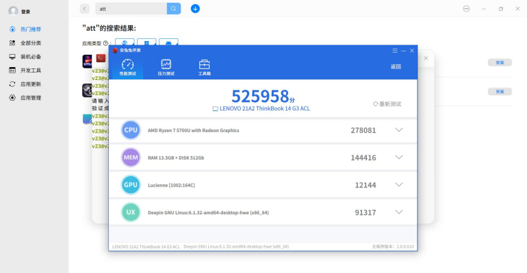

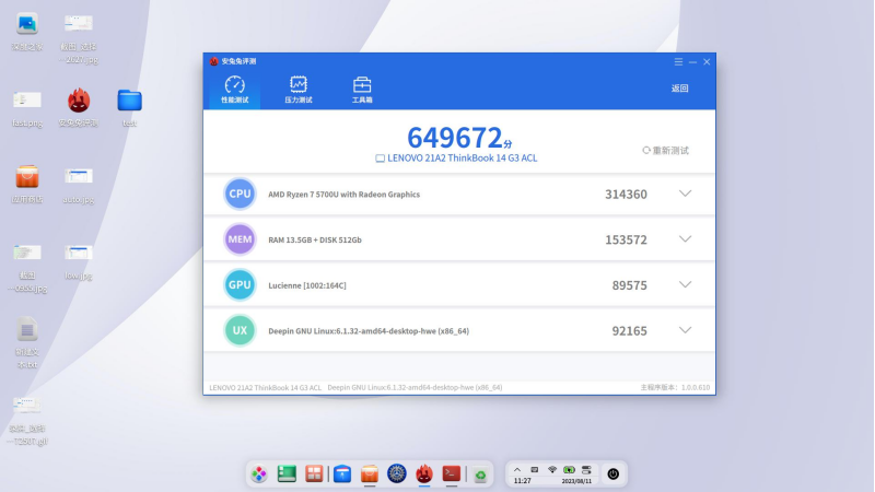

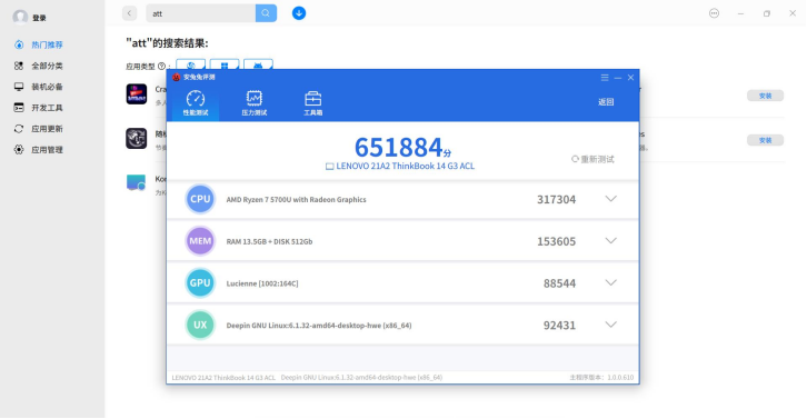

AMD core display AnTuTu verification data
When the mode is set to low, the gpu score is 12144
When the mode is set to auto, the gpu score is 88544
When the mode is set to high, the gpu score is 89575

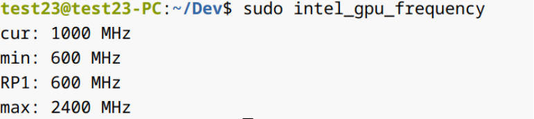

The i915 driver used by Intel GPU does not want you to adjust it, because the power policy of the driver is already smart enough. However, you can also adjust and obtain information through intel-gpu-tools provided by Intel.
sudo apt install intel-gpu-tools
and then use
sudo intel_gpu_frequency
to get the current frequency (currently using Intel A750)
You can see that Intel's graphics card driver dynamically adjusts between 600 MHz and 2400 MHz.

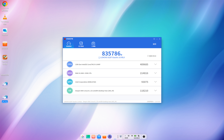

The Intel core graphics running scores under the test notebook are as follows:
