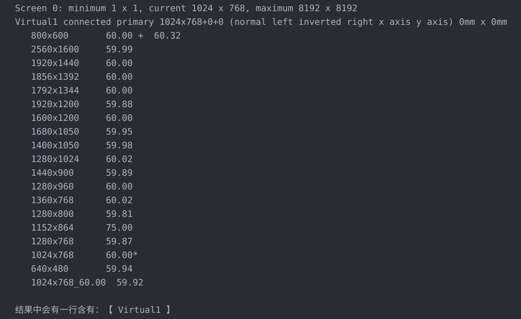

2. In the terminal, enter: xrandr
Based on current experience, there may be two possible situations.

situation 2:
If encountering this situation, execute the following steps to resolve the issue.
3. In the terminal, execute: sudo xrandr --newmode "1920x1080_60.00" 173.00 1920 2048 2248 2576 1080 1083 1088 1120 -hsync +vsync
4. In the terminal, execute: sudo xrandr --addmode Virtual1 "1920x1080_60.00"
5. Check the resolution in the Control Center under Display.

If encountering the situation shown in the image below, there is a second solution.
Execute: cvt 1920 1080
Copy the content after Modeline: "1920x1080_60.00" 173.00 1920 2048 2248 2576 1080 1083 1088 1120 -hsync +vsync
Execute: xrandr --newmode "1920x1080_60.00" 173.00 1920 2048 2248 2576 1080 1083 1088 1120 -hsync +vsync
Execute: xrandr -q to view the interface of the connected display, such as HDMI-0, VGA-0, etc.
Execute: xrandr --addmode Fill in the interface of the display to be modified 1920x1080_60.00
Execute: xrandr -s 1920x1080_60.00
If it fails, it means that the resolution cannot be supported.
