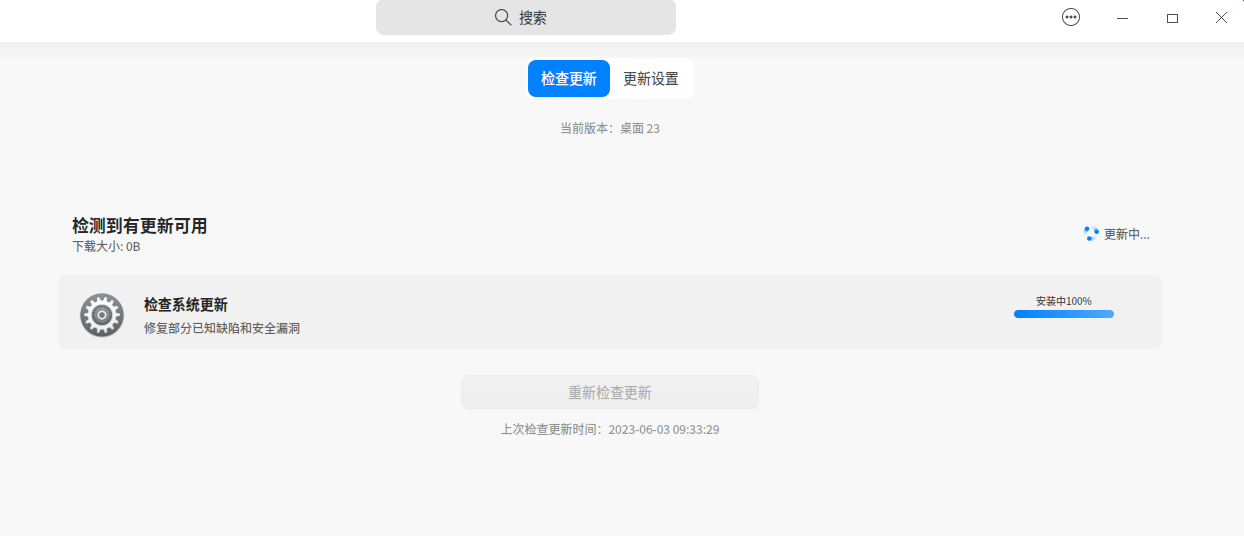

[Exchange and share] V23今天推送更新了

应该是安全更新
