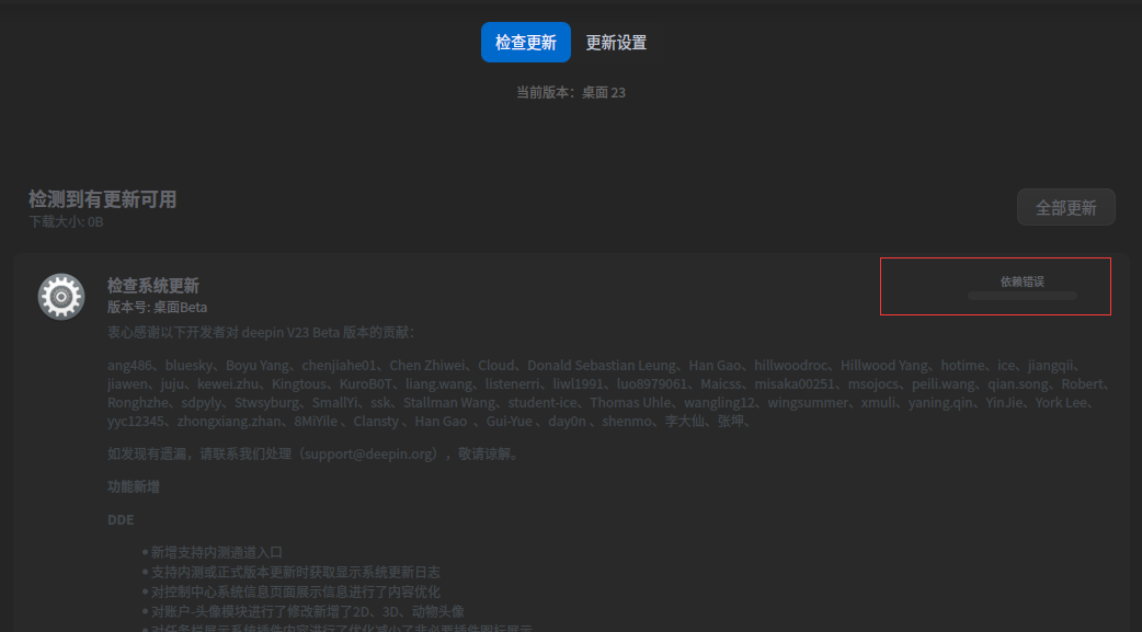

[Exchange and share] 系统无法更新:依赖错误
永不止歩
